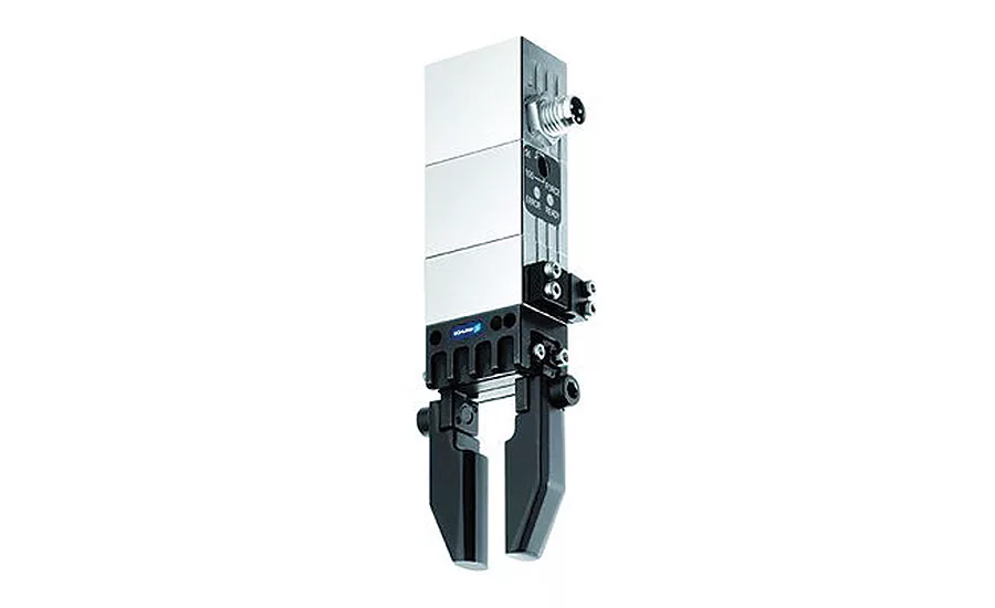

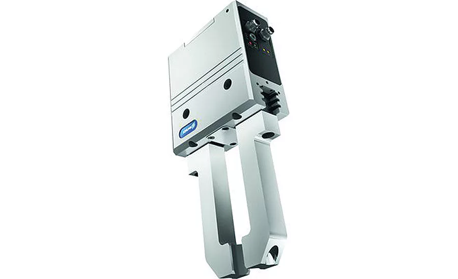

So why choose electric over pneumatic? There are many reasons, but let’s start with the simplest. What if you need the functionality of pneumatics such as point A to B or open to close, but you don’t have access to pneumatics?  Perhaps compressed air is not allowed in the environment or it just isn’t accessible.  SCHUNK has alternative mechatronic solutions for such applications that make it as simple as possible to integrate electric actuators.  SCHUNK “alternative” mechatronic solutions run off 24 Volt DC power and they simply open and close based on two digital inputs. Essentially they are controlled just like a pneumatic actuator. SCHUNK offers the EGP series of alternative grippers for small parts.  The PGN-plus-E gripper would work for medium to large sized parts. And for linear applications, the ELB series of alternative linear motors offers an unparalleled ease of integration.

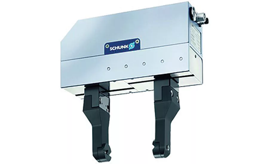

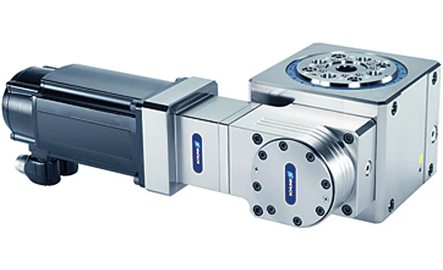

The main reason to choose electric over pneumatic is for the added level of control and flexibility.  If you need to go to several different positions or have precise control over velocity or force, then it is probably best to go electric.  It is important to make the integration into the existing control system as easy as possible. SCHUNK’s line of adaptable mechatronic products does just that. By allowing the user to install any motor they want, it makes communication with the host controller as simple as possible.  There is no need to do handshaking between control products from different manufacturers. SCHUNK offers adaptable mechatronic products for grippers, linear and rotary actuators. Some examples are: the EGA 2 finger parallel gripper for large parts; the ERM rotary actuator with 48:1 gear ratio and air feed through; and the ELS screw driven linear actuator.

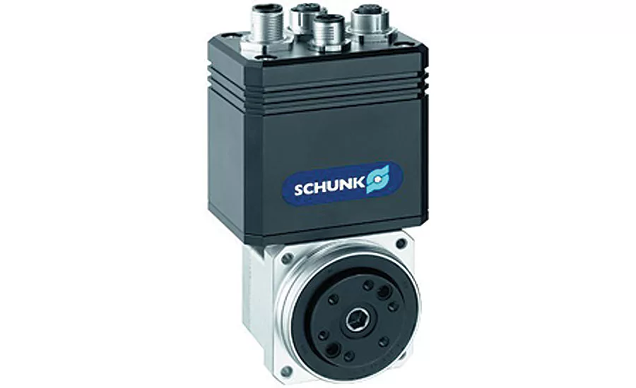

The SCHUNK PRH is an example of an intelligent mechatronic rotary module. The PRH includes a brushless servo motor, Harmonic gearhead, and servo amplifier all integrated in an extremely compact package. Communications methods for the PRH include Profibus or Canbus.

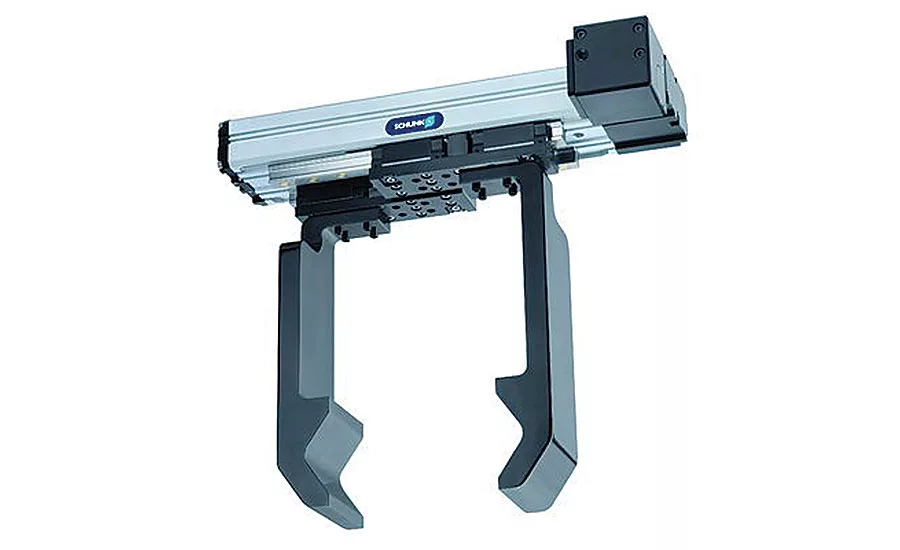

The WSG is an intelligent servo gripper with the ability to have a very delicate touch. The WSG has a brushless servo motor, amplifier, gearhead and belt driven gripper mechanism all bundled into one single package.  It even has electrical connections on the base jaws for force sensing fingers. The information from the force sensing fingers can be processed directly in the WSG’s onboard controller. This makes integrating closed loop force control easier than ever. The WSG is capable of controlling grip forces below one Newton.  The WSG communicates via Ethernet TCP/IP but Canbus and Profibus are also an option.
