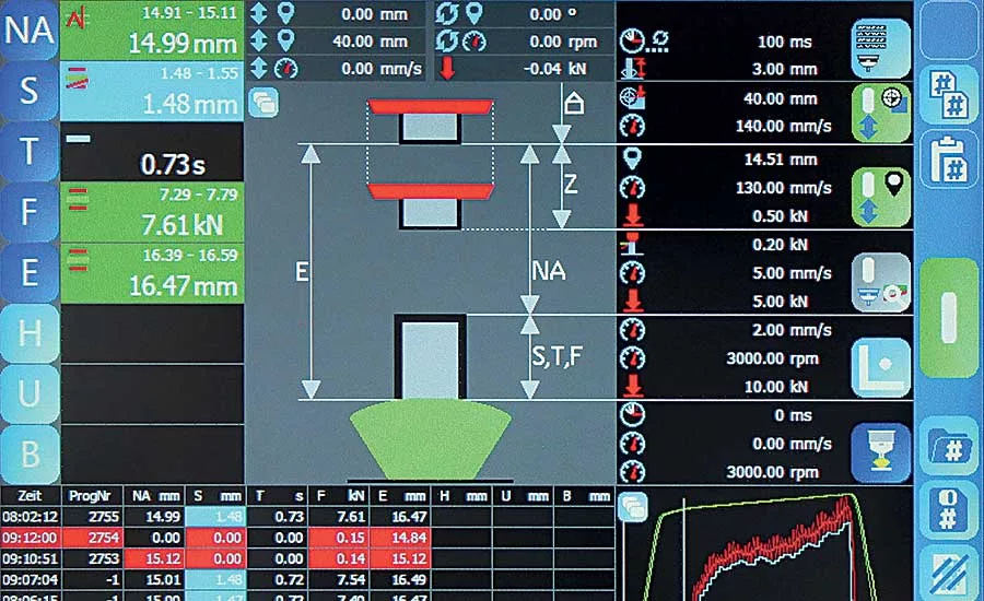

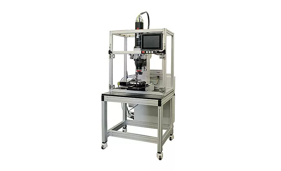

BalTec Electric Riveting unit addresses these issues associated with traditional pneumatic/hydraulic riveting machine by using a 100% electrically powered unit. You now have full positional control due to servo-driven rotary and linear motion allowing for real-time monitoring and process control of linear force, speed and position. Another advantage is process data collection and remote access to data, parameters and programs making it Industry 4.0 ready. Associated operating costs of a pneumatic/hydraulic unit has now been eliminated as well as a making the BalTec Electric unit an environment friendly device since air-oil and hydraulic fluid is non-existent. Due to the drive screw and bearing design, the Electric unit has a greater power density than pneumatic where space may be a premium in automation work cell design.
The traditional pneumatic riveting machine may suffice on some joint forming applications, but if your specific application demands a very short cycle time, or high level of control while maximizing throughput and assuring quality, or if traditional joint technology does not meet your requirements, then the BalTec Electric Riveting unit may be the right choice. With our vast knowledge and experience in joint forming technology, contact a local office to assist in determining if the BalTec Electric Riveter is the right option.
