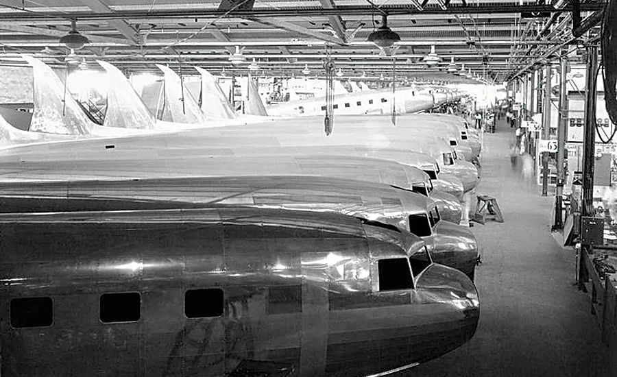

Douglas produced more than 10,000 DC-3s in the late 1930s and early 1940s. Photo courtesy Boeing

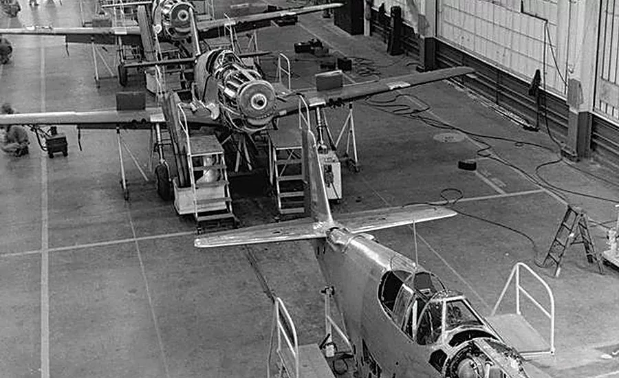

During World War II, North American Aviation’s assembly line was incredibly efficient. Photo courtesy Boeing

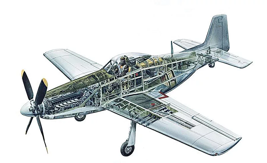

The P-51 Mustang was legendary for its speed, range and maneuverability. Illustration courtesy Boeing

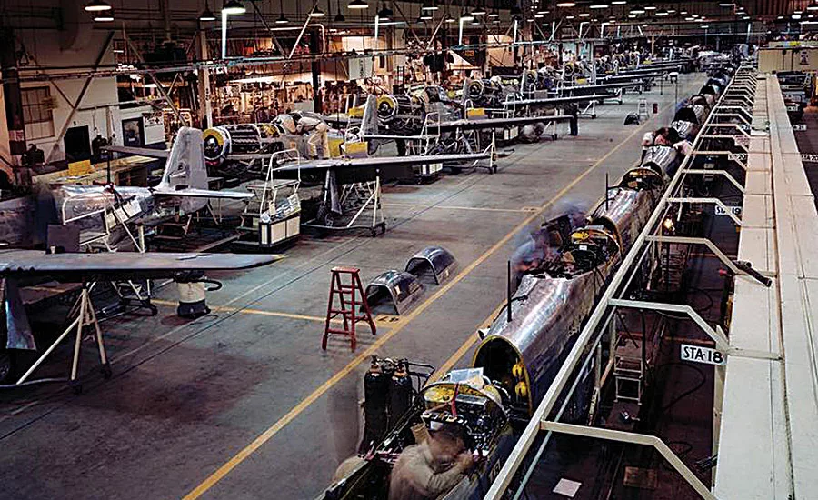

More than 12,000 P-51 Mustangs were built at North American Aviation’s main factory in Ingleside, CA. Photo courtesy Boeing

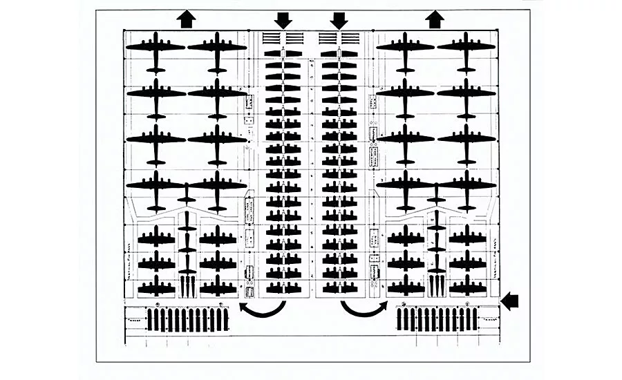

Boeing engineers developed a “multiline production system” to build B-17 bombers on short assembly lines. Illustration courtesy Boeing

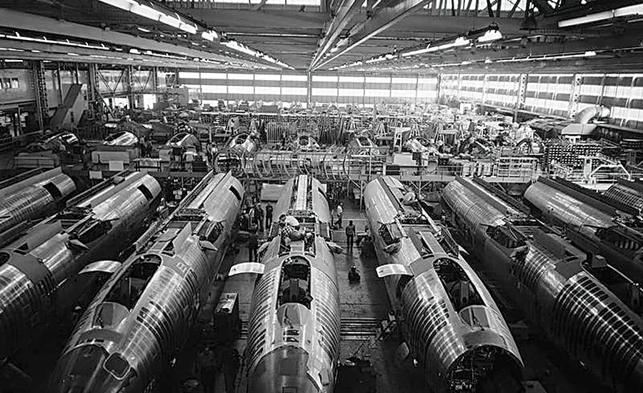

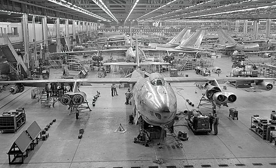

The B-47 forced Boeing engineers to revise old manufacturing techniques and devise new ones. Photo courtesy Boeing

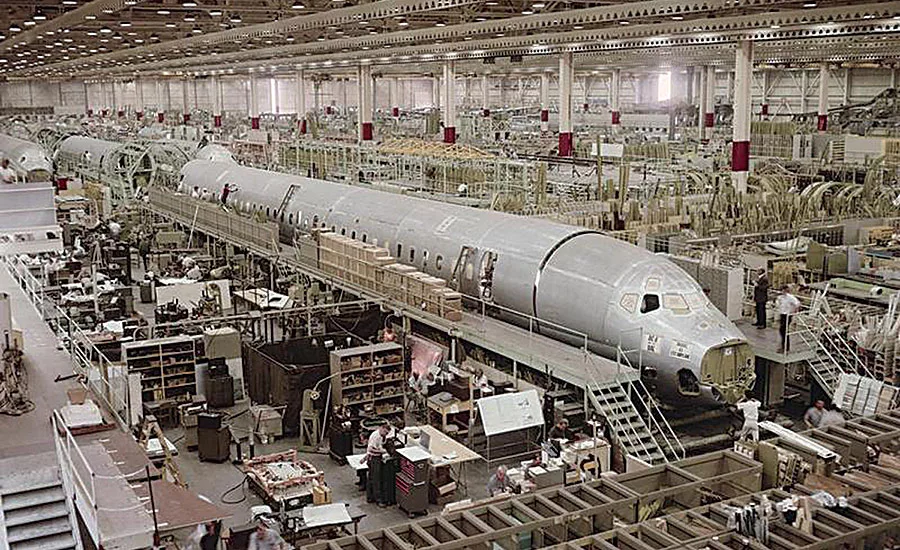

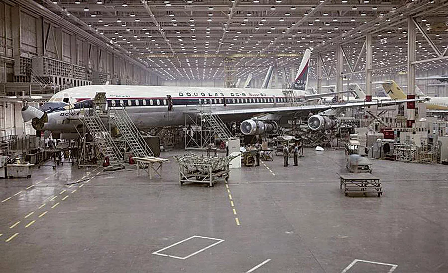

The DC-8 was assembled in the first factory built for the exclusive manufacture of commercial jet transports. Photo courtesy Boeing

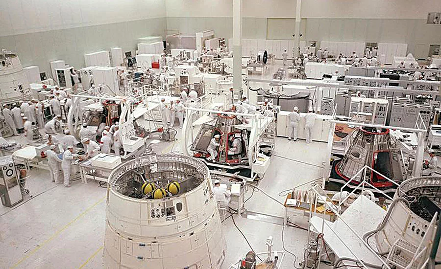

McDonnell engineers used modular assembly techniques to produce the twoman capsules used for Project Gemini. Photo courtesy Boeing

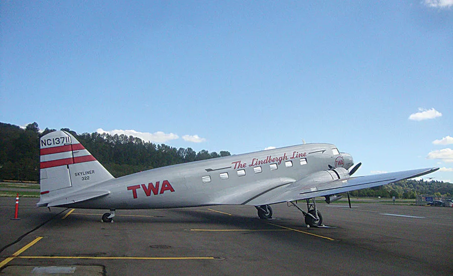

On Aug. 2, 1932, the vice president of Transcontinental and Western Air Inc. (TWA) sent a two-page letter to a handful of aircraft manufacturers. He requested an all-metal “trimotored transport plane” and outlined weight, performance and power spec- ifications. TWA wanted an airplane that was fast, safe, reliable and capable of crossing the Rocky Mountains all year long.
That letter eventually spawned the DC-3, the plane that revolutionized the commercial aviation industry. Unlike Boeing, Douglas Aircraft Co. had never built an airliner. But, the company’s engineers in Santa Monica, CA, jumped at the opportunity. In less than a year, they developed a plane that far exceeded TWA’s expectations.
 The Douglas Commercial Model One (DC-1) debuted in 1933. TWA immediately placed an order for 20 more planes that were faster and had a longer range (they were dubbed DC-2s). The aircraft became an instant hit when it entered service in 1934 between Chicago and Newark, NJ. During its first week in service on that route, the plane broke the speed record four times.
Douglas built more than 150 DC-2s for a variety of commercial and military customers. American Airlines ordered an updated version of the plane with an even wider fuselage. When it debuted in 1935, the DC-3 could accommodate up to 28 passengers in regular seating or 14 passengers in an aircraft equipped with sleeping berths similar to Pullman railroad cars.

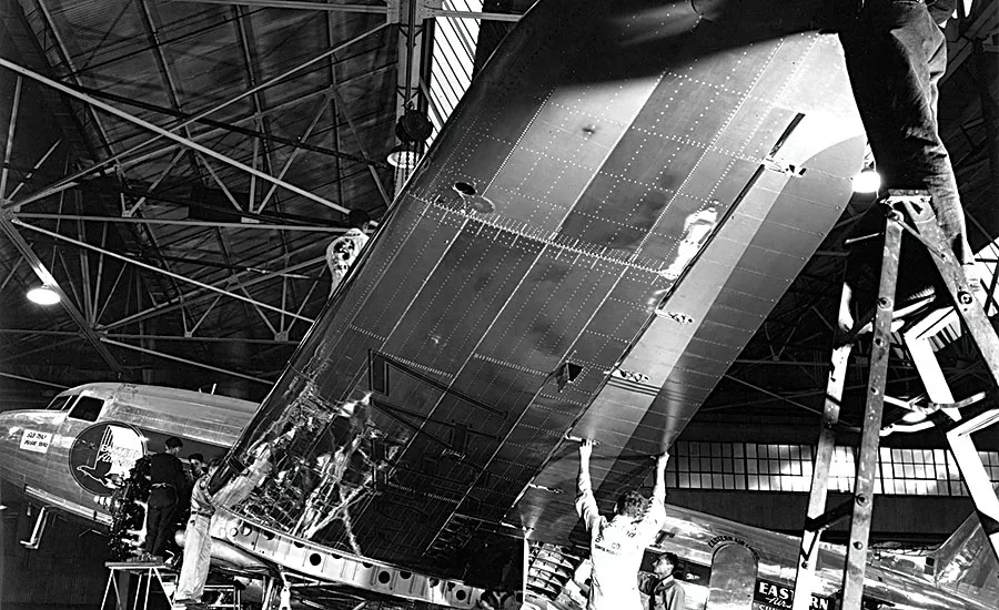

Douglas engineers used a rounded, stressed-skin semimonocoque fuselage, backed by aluminum-alloy stiffeners that ran around its inside like barrel hoops. They also decided to build a plane with only two engines. Without an extra engine at the nose of the aircraft, they reasoned that it would eliminate aerodynamic drag, reduce noise and vibration in the cockpit, and eliminate gas lines and fumes in the cabin.
The engines were housed in streamlined nacelles out in front of the wings where turbulence would be reduced. They each contained a two-pitch propeller that allowed pilots to angle the blades for maximum power at takeoff and then straighten them for more efficient travel in level flight.
Under the direction of chief engineer James “Dutch” Kindelberger, Douglas conducted extensive aerodynamic tests at a new wind tunnel housed at the California Institute of Technology. They ended up with wings that featured a swept-back shape that no previous plane had used.
The aircraft also incorporated an advanced, multicellular wing structure designed by Jack Northrop, whose company and inventions Douglas had recently bought out. It used a weblike internal structure in which span-wise shear webs replaced conventional wing spars.
The wing was assembled in three pieces. A flanged and bolted joint designed by Northrop allowed it be easily taken apart or replaced. In flight, the flexible wing carried the entire weight of the plane. Its upper surface worked under compression and its lower surface in tension.
Another innovation was wing flaps, which had never been used on a large plane. They enabled pilots to fly fast and land slow.
The main competitor to the DC-3 was the Boeing 247. When it debuted at the 1933 Century of Progress world’s fair in Chicago, the streamlined plane boasted new levels of comfort for passengers, including low vibration, sound proofing and plush seats.
The 247 also featured innovations such as retractable landing gear and wing deicers. In addition, Boeing engineers designed the plane with an allmetal, semimonocoque, stressed-skin fuselage and internally braced, cantilevered wings.
However, the DC-3 was faster than the 247 and could seat twice as many people. It was the first airliner that could turn a profit by only carrying passengers.
The DC-3 achieved a level of safety, comfort and sophistication that changed public perception about air travel. By 1939, 75 percent of all airline passengers were flying onboard DC-3s.
Douglas eventually built 455 commercial versions of the aircraft and more than 10,000 military models. Today, hundreds of DC-3s are still flying in remote parts of the world, transporting passengers and cargo.

The P-51 Mustang also incorporated many innovations, including the first use of a laminar flow wing. In addition, NAA engineers used plastic for many parts that were traditionally made out of glass and metal. By using plastic components, they shaved more than 50 pounds off the weight of the aircraft, which helped make it extremely agile.
Lightweight materials also helped boost productivity. For instance, plastic instrument vacuum manifolds could be produced at the rate of two per minute. When built of aluminum, it took nearly an hour of machining time to create one unit.
Engineers developed a thermoelastic process to mass-produce more than 75 different types of phenolic plastic parts, such as ammunition boxes and trim tabs. Laminate sheet was heated and placed into a form die. When pressure was applied, the sheet was formed into the contour of the die.
Several different versions of the P-51 aircraft were produced. Engineers even developed a unique variant called the Twin Mustang that featured two fuselages sharing one wing.
More than 12,000 P-51 Mustangs were built at North American’s flagship factory in Ingleside, CA. During the war years, the facility was one of the most efficient factories in the world. In fact, the plant set a production record when it delivered 571 fighters in just one month.

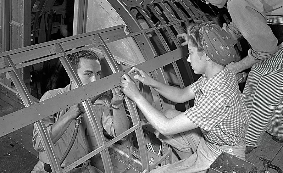

NAA set up an extremely efficient assembly line under the watchful eye of Dutch Kindelberger, who joined the company in the mid-1930s after he left Douglas. His production system enabled parts and components built on subassembly lines to smoothly flow together on the final assembly line.
Kindelberger and his colleagues adapted automobile-style production techniques. For instance, a continuously moving line featured 17 workstations, multiple conveyor systems and feeder lines. Carriers and jigs ran on inverted angle iron rails embedded in the factory floor.
Fuselage interior work was accomplished on a 415-foot long conveyorized line. “Employees applied the necessary protective paint; electrical, hydraulic and fuel cell components were installed; riveting, electrical check operations and other inspections were performed; then, finally, right and left fuselage sides were mated together,” says John Fredrickson, a retired Boeing employee who is the author of Warbird Factory (Zenith Press).
“The floor-mounted fuselage pickup lines were 1,300 feet in length,” adds Fredrickson. “On these, more electrical and hydraulic components were added. The engine, empennage, radio, oxygen systems, canopy and cowling were then installed, all without pause of forward motion.
“Final assembly was accomplished on a third conveyor 600 feet long where wing and fuselage came together; more hydraulic connections were made; armor plate was added; and seats and propellers were installed,” explains Fredrickson.
“A 560-foot outdoor moving conveyor was designated as the engine run-up line,” notes Fredrickson. “There, airplanes were secured wingtip to wing-tip. Engines were run at full power and radios were checked while the airplanes moved sideways until it was time to be towed to a delivery spot.”

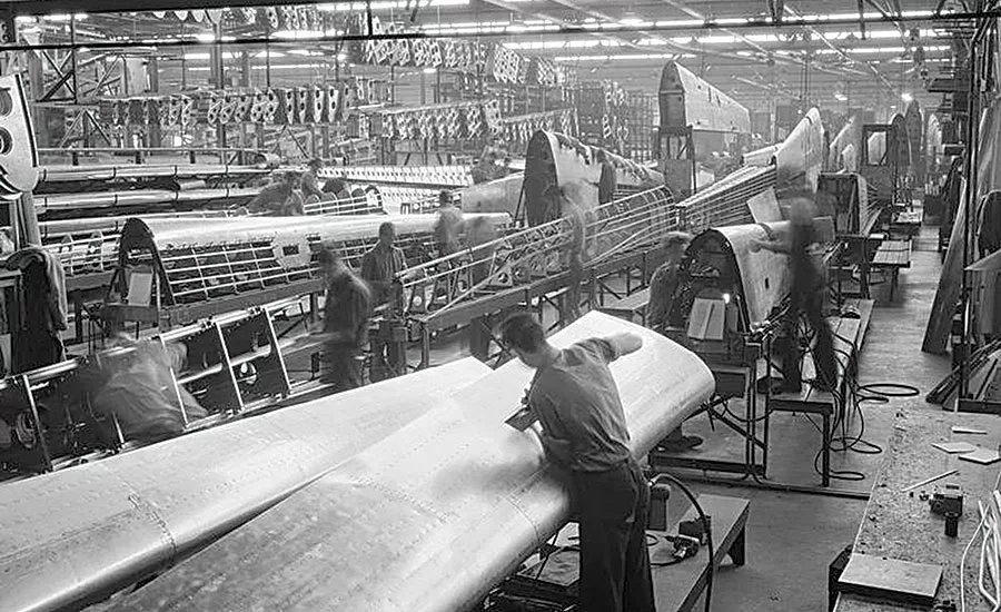

The Ingleside factory also featured a variety of fine-tuned subassembly lines spread throughout the factory that were connected by an overhead conveyor system. For instance, wing assembly was a highly orchestrated process timed to the fuselage assembly line.
“A feature of the leading-edge wing line that has contributed considerably to its efficiency is the extreme to which the work is broken down,” said Ralf Ruud, assistant factory manager, in an article that he wrote for the July 1943 issue of Aviation magazine. “So specialized are the jobs that only one, two or three persons work in each station.
“Because they do only one or two small phases of the work in each of these stations, and there is no congestion of workers, they become highly proficient and can do their assigned jobs while the line moves slowly through the station,” added Ruud.
“Another feature of this line is overhead compressed and electric lines, with tools suspended from them on trolleys that travel with the work through the station,” Ruud pointed out. “This eliminates floor congestion and prevents excessive breakage of tools and snarls of hose and electric cords that would interfere with the movement of workers.
“One of the unusual features of the master jib, where trailing and leading edge sections of the wing panels are riveted together, is the accessibility provided,” claimed Ruud. “Work progresses on both the top and bottom of wing surfaces simultaneously as the sections pass steadily through the stations of the line.
“Throughout the plant, stock is stored adjacent to its point of use,” explained Ruud. “There is no routine or paper work involved in obtaining it. The installer merely reaches over to the bin and takes out a part as he needs it.”

To ramp up production of the B-17, Boeing engineers used a different strategy than their colleagues at Douglas. They developed a series of short assembly lines in the early 1940s.
The “multiline production system” was designed to better utilize factory floor space, labor and equipment. Major portions of the bomber were preassembled and then transferred to the final assembly line to be joined to the fuselage.
“While in some respects multiline production might be compared to prefabrication, it goes much farther,” claimed H. Oliver West, executive vice president of Boeing. “It involves precompletion of the major portions of the Flying Fortress, simplifying final assembly into merely a joining and hooking-up process.
“The main difference between multiline production and the popular conception of assembly line production lies in the fact that the final assembly line has been almost eliminated, thereby reducing the factory space required for manufacturing,” explained West in an article that appeared in the February 1943 issue of Boeing News.
“It has been Boeing’s endeavor to shorten the travel of the product from raw materials through to final assembly and thereby to simplify the manufacturing process,” added West. “This can be accomplished in an integrated plant under a single roof, with a simplified production system.
“Multiline production reverses the aircraft industry’s practice of assembling a plane into its final form at the earliest possible moment in manufacturing,” West pointed out. “Boeing, instead, delays final assembly until just before it reaches the factory door. There the aircraft is put together and rolled out, ready to fly.
“Boeing has divided the Flying Fortress into seven major parts,” said West. “Each portion is built and assembled completely, including wiring, tubing, cable assemblies and all other installations. Final assembly becomes merely a fixture at which the major portions of the aircraft are joined together, and a station at which the wires, tubes, controls and cables are connected.
“Instead of one elongated assembly line, carrying the entire plane in its final form through the many stages of assembly, Boeing uses several production lines, which, because they make but one portion of the aircraft, can be arranged compactly on the floor,” claimed West.
The multiline production system was extremely productive. Boeing assembled 6,981 B-17 bombers at its main factory in Seattle. It also relied on branch plants that built subassemblies in five towns scattered around the Puget Sound area.

While the B-47 ushered in a new era of aviation, it also created a host of production problems, forcing Boeing engineers to revise old manufacturing techniques and devise new ones.
The bomber required four times as much effort to build than its World War II counterparts, due to its larger size and increased complexity. The B-47 weighed 185,000 pounds vs. the B-17, which only weighed 38,000 pounds.
The B-47 used 52,000 different kinds of parts. Many of them were sourced from more than 3,000 suppliers. In fact, 40 percent of the subassemblies were manufactured by subcontractors.
Engineers had to design and build more than 60,000 separate jigs and tools. One of them, the wing jig, required the drilling of 15,000 holes with tolerances of 0.0005 to 0.004 inch. Boeing invested more the $29 million in its Wichita factory to ramp up production. Douglas’ factory in Tulsa, OK, also built B-47s.
“Where the planes of yesterday were built with chalk lines on the floor as a guide, today airplanes are built in four-story jigs aligned by precision optical sights,” explained an article in the July 1951 issue of Boeing magazine. “The tooling job today is far greater than actual construction was a short time ago.
“World War II airplanes had wing skin comparatively thin—1/8 of an inch being the thickest of B-29 skin,” noted the article. “Today, on the B-47 the skin has thickened to 5/8 of an inch in [some] portions, and it is applied in huge plates more than 24-feet long. Spars inside the wings are nearly 30 feet long.
“With this type of construction, the wings can be thin yet extremely strong—the requisite for near-sonic speed,” the article pointed out. “With this all-important thinness, however, the skin of these wings must withstand not only aerodynamic forces but more of the stress of supporting the airplanes as well.
“Rivets such as those used during World War II for fastening wing skin have no place in such construction,” added the article. “The new method for fastening is through 15,000 precisely machined holes, with countersunk high-shear ‘Huck’ rivets whose drive-expanded, threaded shanks are held firmly by ferrules.
“Reason for the new fastening is that through flexing of the wing in flight, the greatest strain is ‘in shear,’ or across the fastening of skin splices— and the heavier, bolt-like Huck rivets are needed to withstand such strain,” claimed the article. “Coupled with the thick skin, they make each wing tough and sleek as it slices through the air.
“After the rivets are driven, their heads, if they are of duralumin, are machined perfectly flat and level with the wing surface or, if of steel, are recessed five-thousandths of an inch and the slight cavity thus formed is filled with plastic,” said the article. “Finally, the entire wing is polished. From its root at the body to its tip, it becomes a glass-smooth blade of exceptional aerodynamic efficiency.”
One challenge assemblers faced was countersinking 15,000 close-tolerance holes. The laborious process required a minimum of four minutes per hole. To improve throughput, Boeing engineers devised a portable, self-attaching tool called the auto-sink. The air-powered device allowed operators to countersink a 0.5-inch hole in only 30 to 40 seconds, reducing production costs by 90 percent.
In addition to aluminum and stainless steel, the high-speed, high-altitude bomber used lightweight materials, such as magnesium and titanium. Plastic was also used for some applications, such as for flush-mounting radio antennas without affecting the aerodynamic integrity of the airplane.
Boeing engineers experimented with metal bonding as a substitute for some traditional riveting and welding applications. They also developed new production tools, such as a saw that skimmed skins after they were attached to framework. This eliminated the tedious task of trimming the skin edges, which previously had to be done before the skins were fastened.

The DC-8 was the first Douglas jetpowered transport. It culminated 12 years of study and was the successor of four-engine propliners such as the DC-6 and the C-54 Skymaster.
The innovative plane entered service simultaneously with Delta Air Lines and United Airlines on Sept. 18, 1959. Powered by four jet turbine engines, the DC-8 was capable of speeds of more than 600 mph.
In a test dive, the plane became the first commercial transport of any kind to break the sound barrier. Throughout its 14-year-long production run, the DC-8 went through seven major variants, for a total of 556 aircraft.
The jetliner was assembled in a $20 million facility in Long Beach, CA. It was the first factory built for the exclusive manufacture of commercial jet transports. The 26-acre facility consisted of two large buildings: one for structural assembly and one for final assembly. An extensive network of overhead traveling cranes could transport subassemblies throughout the factory.
Long fatigue life and fail-safe assurance were the major structural quality goals in the design of the DC-8. (That was important, because many people were afraid to fly on jetliners due to several catastrophic accidents in which planes suffered sudden decompression and broke up in flight. The cause was metal fatigue in the airframes.)
Window frames on the DC-8 were solid, tapered and fabricated from a single piece of metal. Wings were fabricated entirely out of 7075 aluminum.
However, the jetliner also used a half-ton of titanium in its airframe to improve structural integrity and reduce weight. “This represents the most significant use of the weightsaving and permanent corrosion resistance properties of titanium metal in application areas other than jet engines,” claimed an article in the December 1959 issue of ASSEMBLY.
Bands of titanium were riveted at 18-inch intervals around the circumference of the forward section of the fuselage to guard against cracks and prevent sudden depressurization during flight.
“Another measure to extend the fatigue life of the DC-8 wing is demonstrated in the automatic drilling and riveting of skin and stringer in one operation on Drivmatic machines to assure uniformity and even distribution of stresses,” said an article in the September 1959 issue of ASSEMBLY written by D.H. Voss, the general superintendent of Douglas’ Long Beach plant.
“With this type of construction, the entire DC-8 wing tank assembly becomes a single structure of unique integrity and strength,” claimed Voss. “The National Aeronautics and Space Administration riveting method is used.
“Smooth surfaces and closely fitted joints are characteristic of all the structures in the DC-8, whether they are large or small,” explained Voss. “High-tension-type fasteners are used throughout the fuselage.
“In attaching fuselage skins to frames, stringers and doublers, the NASA riveting method again is used,” added Voss. “This work is accomplished by using Douglas-designed Manco Crispin riveting machines. These semiautomatic machines make a uniform fastening while a clamping action holds the members together under a pressure of 1,750 pounds per square inch.
“On the external surface, rivets are upset into countersunk cavities and shaved smooth,” Voss pointed out. “Sealing qualities and fatigue life are greatly improved by this method and there are no irregularities on the exterior of the cabin to cause drag.
“An interesting production technique is employed in the trailing edges of the wing and control surfaces,” claimed Voss. “A billet of unexpanded aluminum honeycomb is milled into a flap vane template and expanded to full scale in all dimensions. It is inserted in the formed vane skin and bonded to provide a lightweight structure of extreme rigidity and fully controlled contour.”

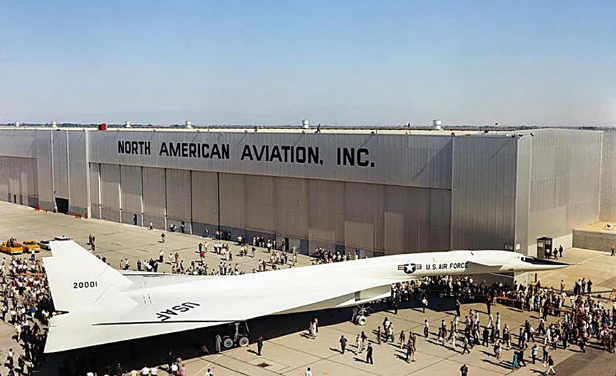

In the late 1950s, engineers at North American Aviation developed a supersonic strategic bomber for the U.S. Air Force called the XB-70 Valkyrie. The delta-winged aircraft was intended to replace the Boeing B-52 bomber during the height of the Cold War.
The huge plane, designed to fly at three times the speed of sound, was powered by six boron-fueled turbojets supplied by General Electric. It pushed the envelope in terms of new materials and production processes.
The airframe of the XB-70 was composed of welded stainless steel honeycomb. Aluminum could not be used because of the extreme temperatures encountered at Mach 3. During one test while flying above 70,000 feet at 2,000 mph, the outside air temperature was -60 F, but air friction raised the skin surface temperature of the plane to 620 F.
The controversial XB-70 was plagued by technical problems and politics in Washington, DC. Because of budget cuts in the early 1960s, only two XB-70s were built.
The first plane made its debut flight in September 1964. Unfortunately, its sister plane was destroyed during a deadly test flight in 1966. The first plane continued a series of test flights until 1969 and is on display today at the Air Force Museum in Dayton, OH.

In early 1959, McDonnell Aircraft Corp. was selected by NASA to design, test and build Project Mercury, America’s first manned space flight program. Over the next few years, the company worked closely with NASA and 4,000 suppliers scattered around the United States.
Engineers worked in relative anonymity, while the Mercury 7 astronauts received widespread publicity. To assemble 20 capsules for the program, McDonnell built a state-ofthe-art white room at its plant in St. Louis. The room was designed to keep the spacecraft free of contaminants, foreign objects and debris.

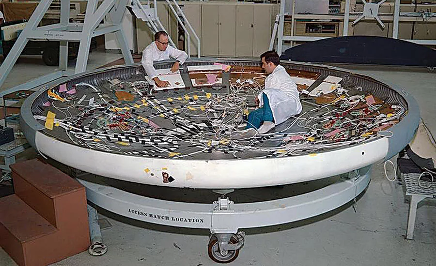

McDonnell’s team of engineers developed a quality control system for electronically monitoring everything that went in and out of the capsule, including every nut and bolt. In addition to a camera, a man stood by the capsule and made sure that people entered and exited the vehicle with what they had brought in.
Everyone in the white room wore uniforms with no pockets. Bundles were built into all wiring so that the wires were never bent, and therefore less likely to shear and spark.
The Mercury spacecraft was 9-feet-tall. The 74-inch-wide coneshaped craft housed one astronaut and weighed 1 ton fully loaded. It was made of strong, lightweight materials such as beryllium and titanium.
The spacecraft was designed so that it could be operated automatically, manually or by ground control. The cabin was equipped with molded, contoured couches made of a crushable honeycomb aluminum bonded to a fiberglass shell and lined with protective rubber padding. The lightweight energy-absorption system could transmit bodily loads evenly during peak acceleration and deceleration periods.
In 1961, McDonnell was selected by NASA to build the Gemini capsule. The two-person spacecraft had nearly twice the room of the Mercury capsule and included many technological improvements. For instance, the spacecraft had a much different structure that its one-man predecessor.
“In Mercury, structure and system were intrinsically entwined in a monolithic capsule,” explained an article in the July 22, 1963, issue of Aviation Week & Space Technology. “With all systems inside the pressure vessel, fabrication was not easy; at the most, two men could work inside a spacecraft with the heat shield off.
“With the shield on, only one man could work inside the craft, and not too comfortably,” added the article. “Further, systems were piled layer cake-fashion on top of systems and the removal of one frequently involved the removal of others.
“This experience led NASA and McDonnell to make several fundamental changes concerning Gemini,” the article pointed out. “First, spacecraft and systems would be built as separate and independent modular units. Second, systems would be located on the outside of the pressure structure and would be packaged for easily-removable units.”
The spacecraft structure was broken into four modules. “NASA found that modular construction has several advantages,” said the article. “It allows a greater concentration of manpower to be used on more parts of the spacecraft, thus shortening manufacturing time, and it tends to isolate the impact of modifications to the module involved.
“At the McDonnell plant in St. Louis, modules are manufactured as structural assemblies on separate production lines on the factory floor,” noted the article. “They then move into the environment-controlled white room at the end of the floor and there each module, still following its own separate path, is fitted with systems. Gemini’s manufacturing sequence, although similar to that of Mercury, is arranged in more logical sets of tasks and permits both concurrent and parallel manufacturing and testing of individual spacecraft components.”

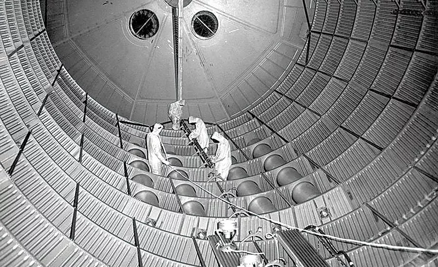

The launch vehicle was the threestage, 8-million-pound Saturn V. Boeing integrated the assembly of all three stages of the mammoth liquidfueled rocket.
Boeing also built the 12-story tall first stage, which housed several large fuel tanks and a complex series of ducts and tunnels that funneled kerosene and liquid oxygen to the rocket’s five engine thrusters. The first stage was built at NASA’s Michoud Assembly Facility in New Orleans. It was 138 feet tall and 33 feet in diameter.

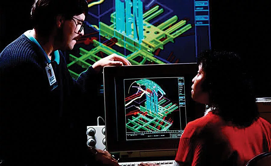

Engineers abandoned traditional drafting boards. Instead, they relied on computer-aided, three-dimensional interactive application software, which was first used in 1987 to design parts for the 747-400.
Boeing engineers used 1,700 workstations supported by four mainframes to refine the initial design of the 777. And in operations, a computer-based system replaced a paper-and-pencil system to track the aircraft assembly process. Engineers also used digital data to design factory tooling and generate work instructions for assemblers.
“[Boeing] expects its change in design strategy—from two-dimensional drawings to three-dimensional computer images—to be farreaching,” proclaimed an article in the November issue of ASSEMBLY. “Typically, change orders, errors and rework are the highest cost factors for any manufacturing operation. According to Boeing, benefits of computer-based design and preassembly include improved quality, reduced costs, fewer changes and errors, and less rework.
“Preassembling parts electronically allows designers to find and easily correct misalignments, fit or interference problems,” explained the article. “Engineers view shaded part designs from any angle on workstation display screens. Cross-sections can be easily extracted from the solid depictions of the parts. When interferences occur, the software system automatically identifies the problem.
“The computer software system also allows designers to insert human models into electronically preassembled sections of the aircraft,” added ASSEMBLY. “The model ensures that mechanics have proper access and functional working areas.
“Digitally defined designs are far more accurate that two-dimensional, manual drawings,” the article pointed out. “Because the software provides interactive communication among design-build teams, various disciplines help engineer the plane’s design concurrently, rather than sequentially. Improved designs and avoiding costly rework during manufacturing are benefits.”
In the past, engineers worked with two-dimensional drawings, taking turns adding elements to the design. Completed designs then went to production specialists who developed tools and production plans, but rarely participated in the initial design stage.
