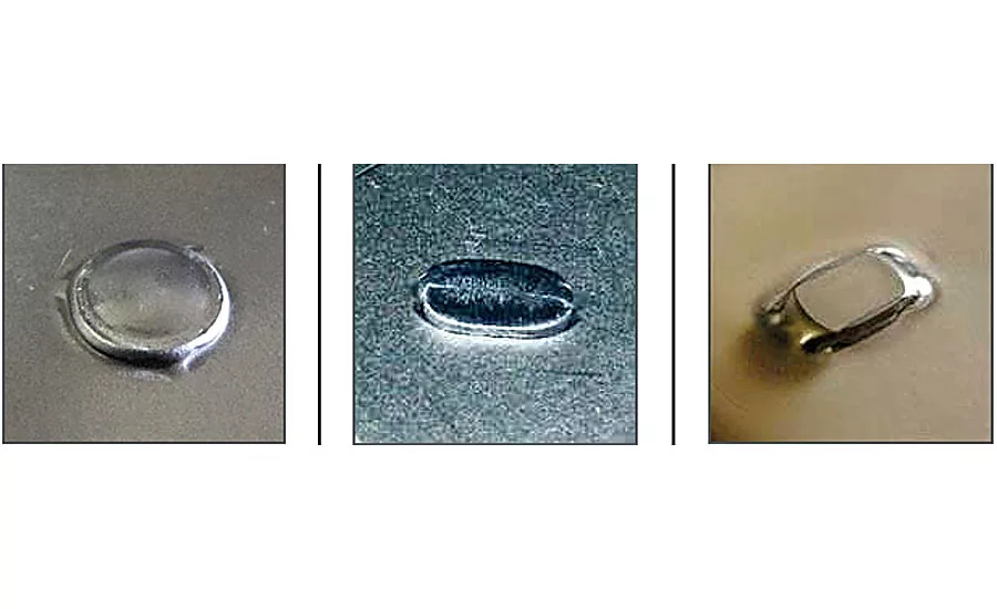

Clinching produces a joint similar to a press stud, with a round (left), oval or rectangular (right) button under the bottom sheet. Photos courtesy BTM Corp.

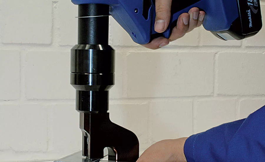

Last year, Eckold brought its battery-powered MCD 30/50 AH handheld unit to market. It weighs only 15 pounds, but offers 5 tons of clinching force. It joins mild-steel stacks up to 3 millimeters thick and aluminum stacks up to 4 millimeters thick. A rotating head allows the operator to perform clinching in corners without having to change position. Charging time is 22 minutes, and cycle time is about 4 seconds. According to Neumayer, the model is designed primarily for HVAC and channel-letter signage manufacturers.
