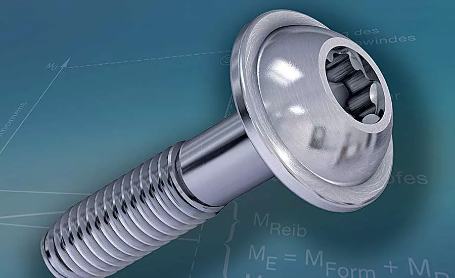

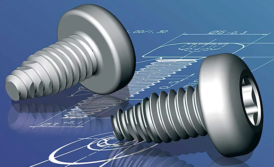

The Sheetite Screw

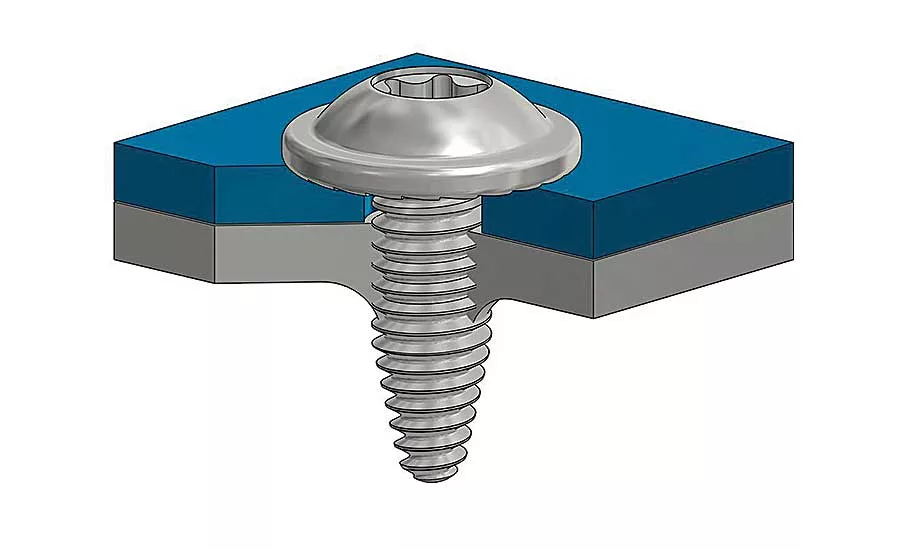

The Sheetite screw from Arnold Umformtechnik GmbH & Co. eliminates the need for preparatory processes, such as thread tapping, and for additional fastening elements, such as nuts. The fastener is screwed directly into a metal rim-hole or a predrilled metal sheet.
The joining process starts by positioning the screw. Thanks to its rounded tip, the Sheetite fastener finds the predrilled hole easily, even in the case of offsets or angular offsets. The roundness also protects components within the installation space.
During subsequent thread-rolling, the Sheetite penetrates the lower sheet and forms a threaded hole. Depending on the type of hole drilled beforehand, this pushes material in the direction of the joint, so that the penetration depth is greater than the original metal thickness. This also increases the amount of bearing thread turns inside the tapped hole.
As soon as the nut thread has formed completely, the fastener is drawn in until the head contacts the top sheet. At that point, the fastener is tightened like a conventional screw.
“Depending on sheet thickness, the screw-in depth can increase by up to 60 percent,” says Jan Büchle, research and development engineer at Arnold. “As the joining process progresses, once the screw fastening has been completed and the head [is snug against the top sheet], a greater proportion of material is available to counter the overload from [tightening].”
The Sheetite screw is designed to connect two or more sheets placed one atop of the other, with a total thickness of 0.5 times the nominal diameter of the fastener or less. The sheets can be made of steel, aluminum, magnesium or other metals. The diameter of the predrilled holes in the sheets is flexible, so the process and assembly parameters can be adjusted optimally to each application.
No special fastening tools are needed to install the fastener. If a repair is needed, the formed threads can accept a conventional metric screw.
A unique aspect of the screw is that its shaft has two cross-sectional profiles. The different cross-sections ensure load relief and increase safety during installation. In the thread-forming area and during the transfer to the bearing thread section, the screw’s shaft has a polygonal cross-section. This ensures that the hole and thread are created without producing metal chips. In the bearing thread, closer to the thread run-out and screw head, the shaft takes on a round cross-section.
“The thread runout forms the end of the bearing thread section to the screw head,” says Büchle. “With thin metals, this is a function-critical characteristic. It must be designed as short as possible, due to the shorter screw-in depths and clamping thicknesses.”
Compared with conventional sheet metal screws, Sheetite has some unique advantages. “Due to their large thread pitch, conventional [sheet metal] screws increasingly skew to one side during the screw-in process and cannot be inserted vertically to the surface of the workpiece,” says Büchle. “The head does not sit evenly on the surface, and thus more load occurs on one side.
“In addition, sheet metal screws used to be overtightened because the material did not offer sufficient security for a reliable assembly when the screw-in depth was small. However, with increasingly stronger materials and greater screw-in depths, design engineers can now use conventional fasteners that can be applied directly into the metal.”

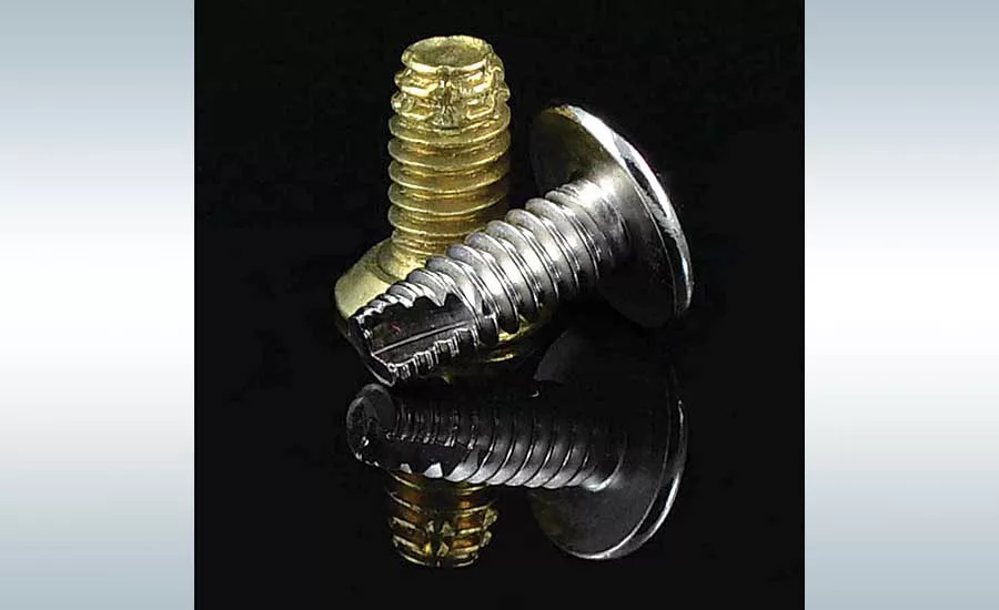

Ecosyn Self-Cutting Screws
Ecosyn-drill and Ecosyn-MRX self-cutting screws from the Bossard Group drill their own hole and form their own mating threads. A specially formed and stamped drill point prevents any drifting around the surface of the component and allows rapid spot drilling. There’s no need to use a center punch to create a drilling point.
These screws can be installed with either electric or pneumatic tools at a speed of 1,000 to 2,500 rpm and a contact pressure of 150 to 300 newtons.
Made from case-hardened steel and passive-blue galvanized, Ecosyn-drill screws are particularly suited for use in assemblies made of aluminum and galvanized steel sheet up to a hardness of 125 HV.
Ecosyn-MRX screws are made from a martensitic, hardened and tempered chrome steel with higher resistance to corrosion (comparable to A2 grade stainless steel). The fastener can be used on aluminum sheet metal and rust-resistant steel sheet metal.
