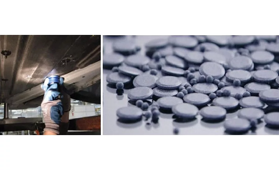

Renault assemblers (left) use a special tool to press and heat a fastener against a TechBond PUR adhesive tablet at a specific attachment point underneath the EOLAB’s floor panels. Photo courtesy ARaymond

Moutardier then sought the advice of Philippe Michel, global purchasing project manager at Renault and one of the company’s top experts on structural bonding, for an effective alternative to welding and drilling. Michel recommended fasteners be bonded to the panels with TechBond PUR, a heat-activated polyurethane adhesive made by ARaymond.
Designed for both dynamic-stress and permanent-load applications, TechBond PUR comes in dry, bead-shaped pearls and flat tablets. It is suitable for painted metals, glass, plastics, carbon fiber, glass fiber and many other composites.
Fastener bonding is a three-step process that requires a specially designed tool. An assembler loads the fastener into the tool top side down and places the adhesive tablet on top of the fastener bottom. He then positions the loaded tool at a specific attachment point on the bottom of the floor panels, and presses a side button for 5 seconds.
During this time, heat is applied to the fastener, which, in turn, melts the adhesive and secures the fastener. After 50 fasteners are installed, the vehicle subassembly is moved down the assembly line so workers can install exhaust-pipe heat shields, an underbody cable channel, underbody trim, and tubing for pneumatic suspension.
