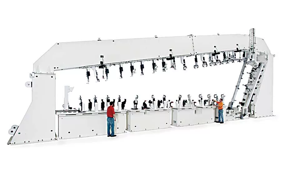

The KUKA wing assembly fixture for Gulfstream is a long, vertical structure in which the wing is assembled. PHOTO COURTESY KUKA SYSTEMS NORTH AMERICA LLC

KUKA provided GAC with custom fixtures and two mobile robot platforms to help workers complete the assembly of jet wings and other components. Each fixture is a long, vertical structure that is larger than the wing itself. Inside this structure, the wing ribs and spars are installed between the top and bottom skins to provide needed structural integrity.
One type of fixture tooling vertically lifts each wing, turns it to the horizontal position and moves it to the next assembly station. Other tooling helps workers locate, hold and assemble various wing sections, such as ailerons, engine-mount bulkheads, flaps, and leading and trailing edge panels.
All tooling is designed to Gulstream’s engineering specifications for each aircraft type, and made with large parts that are fabricated and machined to tight tolerances. Multiple processes are used in fabrication, depending on the tool type and its function.
Typically, the main structure is made of steel, usually tubing, while part-touching details or critical locators are made of aluminum. Some tools may be made entirely of aluminum so the coefficient of thermal expansion matches that of the aluminum aircraft parts being assembled.
