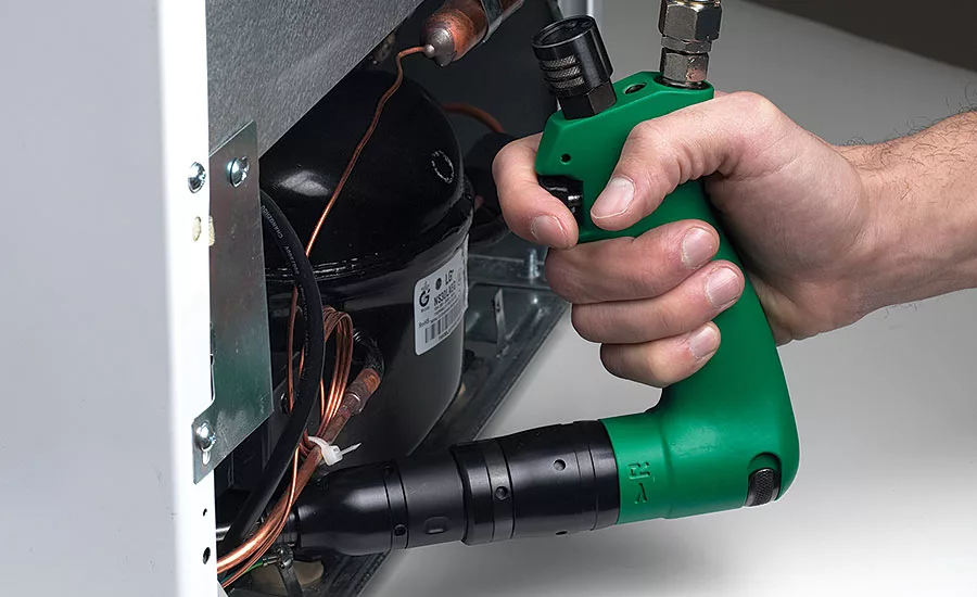

Assemblers use the 26C APU series pneumatic screwdriver upside down. Photo courtesy ASG, Div. of Jergens

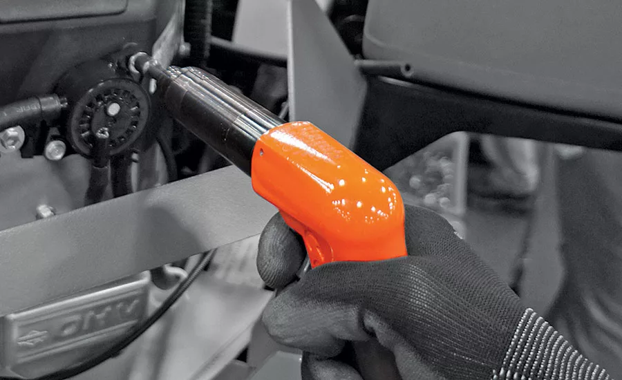

The 19-Series of pneumatic nutrunners and screwdrivers includes right-angle, inline and pistoltrigger models with a torque range of 0.3 to 15.8 newton-meters. Photo courtesy APEX Tool Group LLC

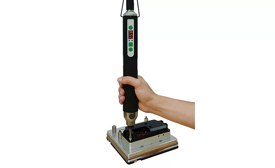

Recently upgraded, the Minimat-ED digital electric screwdriver enables the operator to set torque (0.24 to 4.8 newton-meters) by pushing a button. Photo courtesy DEPRAG Inc.

ASG’s 26C APU series pneumatic screwdriver has a torque range of 0.4 to 4 newton-meters and is used upside down. It features a 0.25-inch hex drive and a pistol grip, which enables assemblers to comfortably install or remove fasteners in tight spaces. The tool is also equipped with the TRACS torque control system (for accuracy, reliability and repeatability) and auto shut-off technology.

APEX makes the 19-Series of pneumatic nutrunners and screwdrivers that includes right-angle, inline and pistol-trigger models. Torque range for more than 50 models is 0.3 to 15.8 newton-meters. The Clecomatic clutch ensures a tightening tolerance of ±10 percent, which is comparable to electric tools. An adjustable reverse lever near the trigger allows one-hand operation for left- or right-handed users. There is also a port to connect a torque verifier.

Complex and multi-stage screwdriving sequences are possible with DEPRAG’s upgraded Minimat-ED digital electric screwdriver. The operator sets the required torque (0.24 to 4.8 newton-meters) for a screw assembly by pushing a button. When the torque value is reached during installation, the tools shuts off and a green or red LED lights up to indicate whether the assembly was successful or not. The tool’s adjustable screwdriving program enables an operator to easily install several screws with varying tightening parameters.
