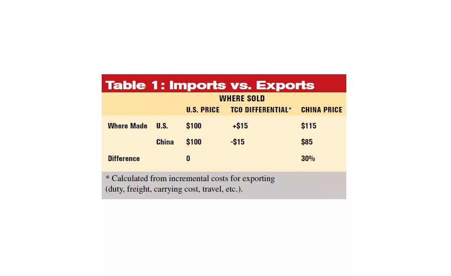

At a given level and mix of demand for products, the only ways to increase manufacturing are to export more or import less. Reshoring (importing less) is more efficient than exporting more because U.S.-made products are about 30 percent more price-competitive selling against imports in the U.S. than they are competing in overseas markets.
Table 1 shows price comparisons in China and the U.S., assuming constant margins, for a U.S.-made product that is competitive here. The difference arises because exporting adds, on average, at least 15 percent to the total cost of a product exported from either country.
