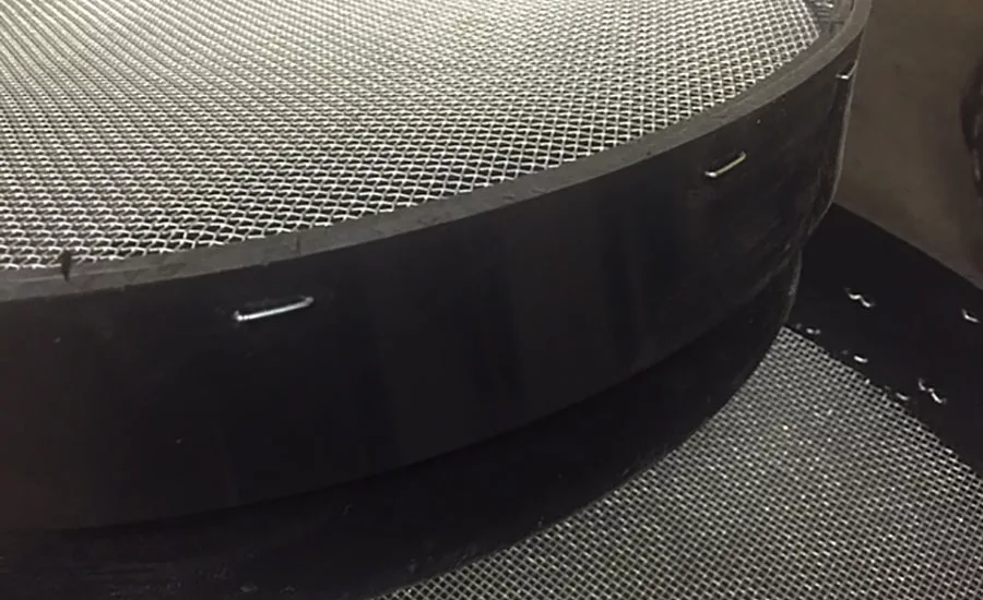

Staples secure the wire mesh of this sieve to a plastic ring. Photo courtesy Deluxe Stitcher Co.

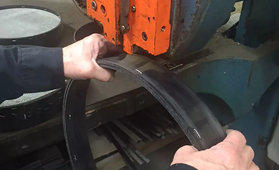

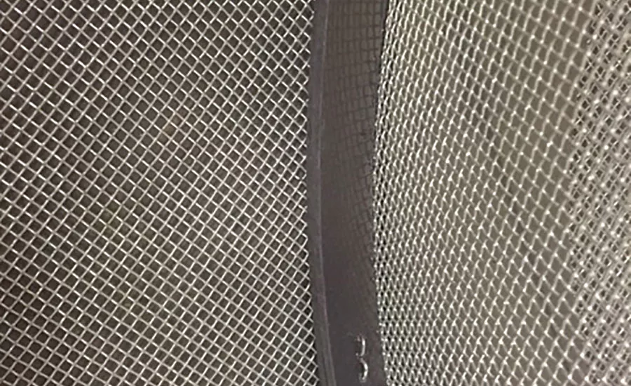

Another company that uses metal stitching equipment produces low-cost sieves for material separation. Each sieve consists of a round exterior made of rubber or plastic, with a wire mesh in the middle. A stich is used to attach the wire to the rim. The entire assembly process can be completed in a minute.
