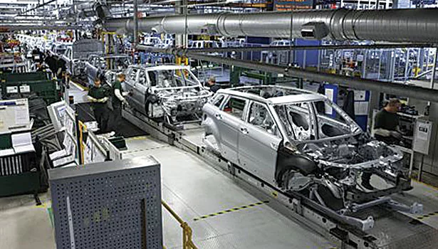

This vehicle achieves body and chassis weight savings due to lightweight metals, such as aluminum, magnesium, thermoplastic and carbon-fiber composites. Photo courtesy Jaguar Land Rover

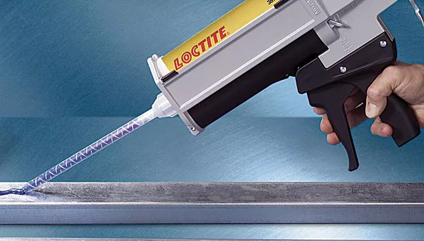

Many types of adhesives can be used to bond plastics to metals. Photo courtesy Henkel Corp.

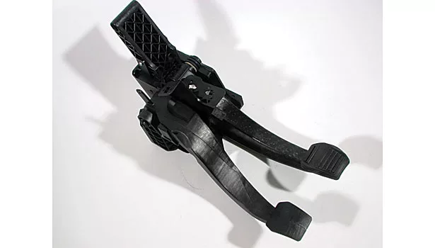

This prototype brake pedal was assembled with plastic and metal parts. Photo courtesy Lanxess Corp.

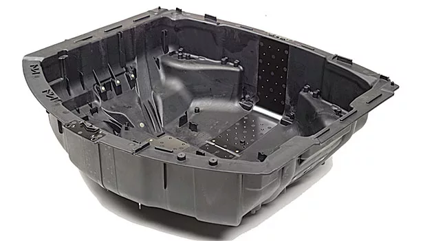

A wide variety of automotive components use plastic-to-metal joints, such as this spare wheel well. Photo courtesy Lanxess Corp.

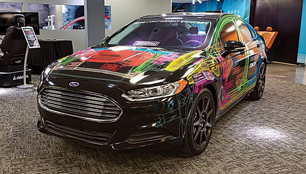

Engineers at Ford Motor Co. and Magna International Inc. are experimenting with a variety of lightweight materials to improve performance and fuel efficiency while reducing carbon dioxide emissions. They recently unveiled a lightweight concept vehicle that uses aluminum, carbon-fiber composites, magnesium, ultra-high-strength steels and advanced lightweight plastics throughout, including body, chassis, interior and power train.
The concept car trims the weight of a 2013 Fusion sedan to that of a Fiesta subcompact, resulting in a nearly 25 percent reduction.
“Our goal was to investigate how to design and build a mixed-materials, lightweight vehicle that could potentially be produced in high volume, while providing the same level of safety, durability and toughness as our vehicles on the road today,” says Matt Zaluzec, technical leader for global materials and manufacturing research at Ford. “There’s not a one-size-fits-all approach to lightweighting.”

Adhesive bonding overcomes many of the issues related to using threaded fasteners to join mixed-material assemblies. The entire bonded contact surface participates in load management. In addition, the adhesive and primer combination isolates one surface from another, which reduces issues from galvanic interaction.
Adhesive bonding provides more efficient load management, so the thickness and weight of both materials can be reduced. And, there are no holes to drill, align or seal.
However, adhesives are not instant like mechanical fasteners. Depending on the technology, adhesives take seconds, minutes and occasionally hours to fixture and ultimately cure. Manufacturers must wait for fixture to be completed before moving parts.
Control is also a factor. The amount of adhesive dispensed, the precise location of the adhesive, and the clamp force applied to the assembly must be carefully controlled or the bond will be compromised.
While adhesives can bond virtually any plastic to any metal, some materials work better than others. “Nylon and ABS typically are the easiest plastics to join to metals,” says Henkel’s Small. “Bond strength to the plastic is not always ideal when you are working with extremely smooth plastic materials like polypropylene or with hard-to-bond plastics like polyethylene. But, primers can greatly increase bond strength to plastics.
“Almost all adhesive technologies can be used to bond plastics to metals,” adds Small.
“Cyanoacrylates, acrylics, epoxies, urethanes, elastomers and silicones all reliably bond plastics to metals.”
A new technology called hybrid structural instant adhesive (being introduced this fall by Henkel) will enhance plastic-to-metal bonding applications. It combines fast-curing cyanoacrylate adhesives with traditional structural technologies, such as epoxy or methyl methacrylate.
“These are two-part, room temperature curing adhesives applied using a dual-cartridge dispenser,” says Small. “They offer the fast fixture speeds of cyanoacrylates with the durability of structural technology.
“Hybrid structural instant adhesives can bond most plastic formulations, including hard-to-bond plastics, to metal substrates,” claims Small. “The key is they do it faster. Fixture speed differentiates the hybrid from the pure structural technology. Hybrids fixture in less than three minutes.”
