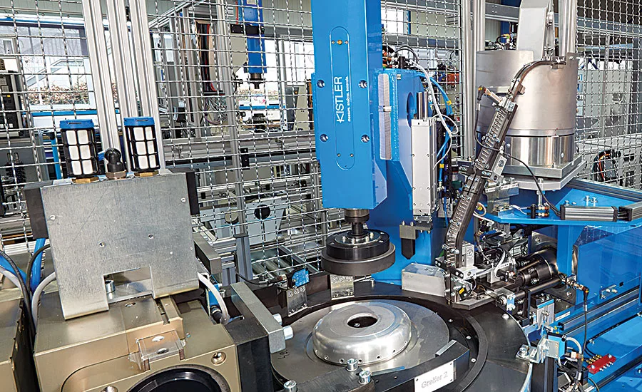

Manufacturers in several industries use Kistler Instrument Corp.’s NCFN servo press, which features a strain gauge force sensor and produces joining forces from 5 to 300 kilonewtons. Photo courtesy Kistler Instrument Corp.

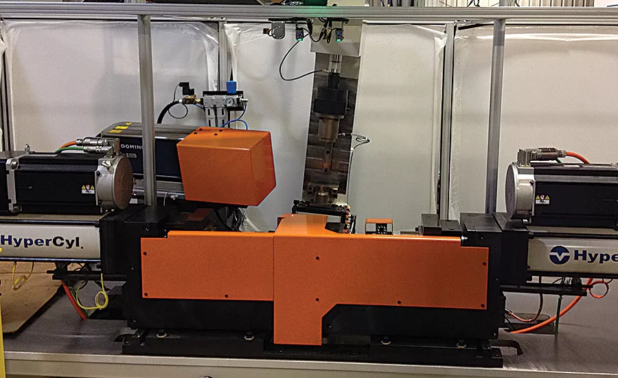

At this plant, HyperCyl-EMA servo actuators (8-ton force capability) insert bushings for a suspension product. Photo courtesy Aries Engineering Corp.

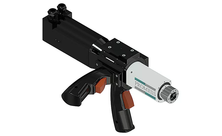

Promess handheld models weigh just 20 or 30 pounds, but produce 1,000 or 3,000 pounds of force, respectively. Graphic courtesy Promess Inc.

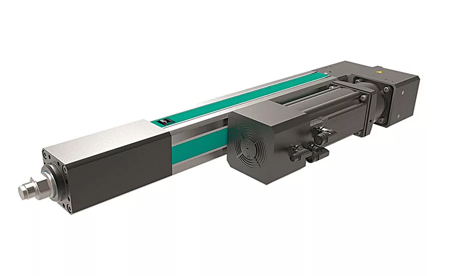

EX-K servo presses feature a planetary roller screw and provide forces of 10 to 200 kilonewtons. Photo courtesy TOX-Pressotechnik

“Both manufacturers came to us to see if we could design a cleaner system for pressing than our hydropneumatic press,” explains Brieschke. “They were using the press to install bushings and spark plug tubes, and for various small assemblies.”
Over the next several months, Aries developed a prototype linear actuator powered by a standard electric DC motor. Unfortunately, the unit failed to provide the required repeatability, so company engineers rebuilt the unit with a servomotor.
That model met the automakers’ needs and eventually evolved into the company’s initial HyperCyl-EMA linear actuator, introduced in 2010. Today, Aries makes the fifth-generation version of this actuator, which is used by many automotive manufacturers, as well as companies that produce medical devices, munitions and equipment for the Department of Defense.

Suppliers offer several sizes of semi- and fully automated servo presses. Promess, for instance, makes standard, compact, handheld and robot-mounted models. The standard presses produce 0.2 to 1,000 kilonewtons of force. Manufacturers often use several compact models to perform simultaneous pressing of multiple small assemblies. Handheld models weigh just 20 or 30 pounds, but produce 1,000 or 3,000 pounds of force, respectively.
“Presses for robots are mounted like end-of-arm-tooling or on a gantry,” says Nausley. “Because the robot usually isn’t strong enough to hold down the press during operation, it has built-in hard stops to allow the user to back the press load into the machine frame.”
Force and position measuring are the servo press’s bread and butter, and both technologies are constantly improving. For example, presses from Kistler Instrument Corp. are available with integrated piezoelectric or strain gauge force sensors.
According to Bill Taylor, division sales manager at Kistler, piezoelectric sensors are ideal for dynamic processes and low force requirements, such as measuring when a plastic part is pressed into position. These sensors do not require external excitation to function, and remain stable over time and temperature changes. In contrast, strain gauge sensors are preferred for static or press-and-hold processes. However, they are susceptible to impact, cyclical fatigue or permanent mechanical deformation if not selected properly.
Manufacturers in several industries use Kistler’s NCFN servo press (Type 2153A), which features an integrated strain gauge force sensor and produces joining forces from 5 to 300 kilonewtons. The press’s AC servomotor is driven by a servo amplifier that provides constant speed regardless of load.
Automotive manufacturers especially like the compact NCFH press (Type 2151B). Available in two sizes, it features a dual-range piezoelectric force sensor, a hollow-shaft servomotor and a direct drive that offers high dynamics for short cycle times. This press has a force range of up to 60 kilonewtons, and it can be installed vertically or horizontally.

A little more than a year ago, TOX-Pressotechnik redesigned the body and motor of its EQ-K and EX-K servo presses to make them cleaner and more efficient. Waldherr says that the auto industry is a big user of both series. The EQ-K series costs a bit less, features a ballscrew mechanism and offers press forces from 2 to 100 kilonewtons. EX-K models feature a planetary roller screw and provide forces of 10 to 200 kilonewtons.

Available in roller screw and ballscrew configurations, the HyperCyl-EMA has load ratings from 1 to 230 kilonewtons, and is capable of 0.0025-millimeter repeatability and ram speeds up to 410 millimeters per second. When mated with the optional HyperView-Press signature analysis controller, the actuator performs precise force-distance monitoring, trending, data logging, process capability and data analysis.
A major appliance manufacturer uses the actuator to install bearings in the tub of its front-load washing machines. The actuator was modified so its spindle provides a 48-inch stroke.
