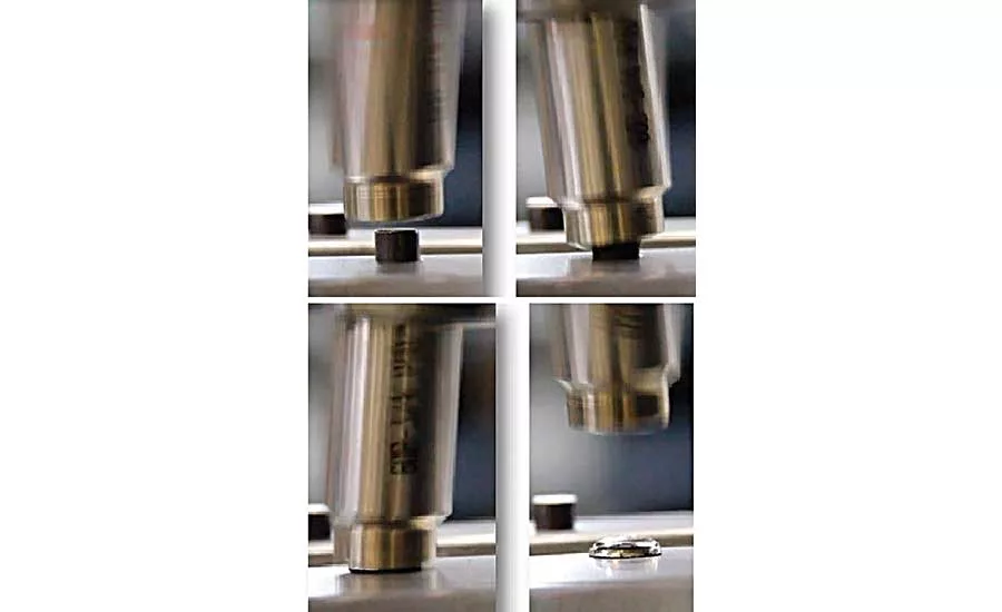

In orbital forming, the peen moves in an orbital path and displaces a minute quantity of material with each rotation of the forming head until forming is complete. Photos courtesy Orbitform Group

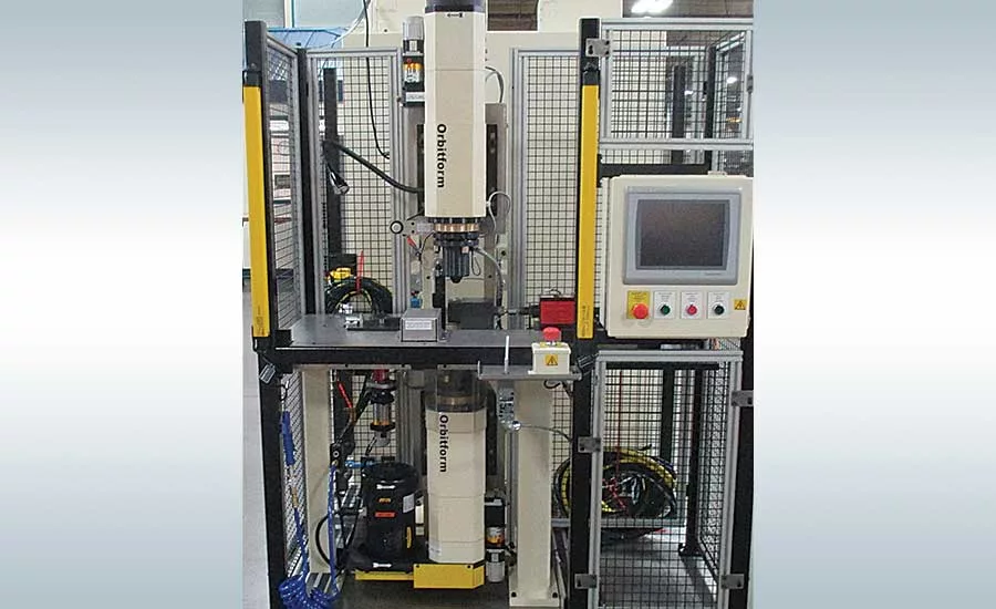

Designed for a Tier 1 automotive supplier, this orbital forming unit features dual-opposed SV315 powerheads and an in-process torque precision system. The two heads work independently to form the main pivot point of a steering system. Photo courtesy Orbitform Group

An orbital forming machine features a rotating spindle with a mounted peen tool fixed at a 3- or 6-degree angle to the spindle axis. The machine begins forming after the mating parts are positioned over a cast or machined-in rivet, post, pin or ridge. This protrusion can be solid, tubular, triangular, square, hexagonal, oblong or semicircular.
As the spindle rotates, the peen orbits the spindle axis. The peen does not rotate on its own axis, but presses on the rivet shank along a radial line that begins from the shank center. As the peen moves in an orbital path, a minute quantity of material is displaced with each rotation of the forming head until forming is complete.
Because the line of contact on the peen to the workpiece is always the same, and the orbital head features a series of bearings, friction between the two is minimal and there is no tearing of the work material. In addition, the workpiece is normally cool to the touch after forming. The forming time is 0.5 to 4 seconds, depending on material type, stud diameter, desired head style and stroke length.
Spindle rotation speed can vary from 900 to 1,200 rpm, with 1,140 rpm used most often, and some units being capable of reaching up to 3,400 rpm, according to Wright. The bearings in the head enable it to withstand such a high rpm if the application demands it.
The peen is made of heat-treated steel and held in place by a setscrew, so it can be changed quickly. Changing the shape of the peen changes the shape of the finished rivet head. Conical, flat, eyelet and crown are some common head shapes. Others include flared, flat-flared, swaged, shoulder, cambered, ring stake, high crown, roll-in and draw-in.

Orbitform began making servo-driven powerheads in 2011, and its latest three models are the SV315, SV515 and SV715. All the heads are available for use as a benchtop model or incorporated into a larger system. Forming force capacity of the SV315 is 2,200 pounds, the SV515 is 4,400 pounds, whereas the SV715 reaches up to 7,510 pounds on a mild-steel solid rivet from 0.03 to 0.84 inch in diameter.
Wright says all the heads can be used for orbital and radial riveting, and produce precise articulating joints. The heads have a 6-inch stroke and an advance or retract rate of 0.005 to 4 inches per second.
