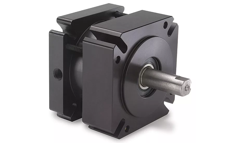

This ballscrew brake is spring-engaged. In the event of a power loss, it will automatically engage the load. Power must be resupplied to release the brake from the load. Photo courtesy Nexen Group Inc.

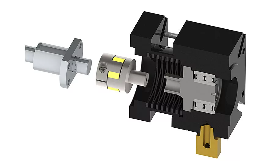

A ballscrew brake is attached to the end of a ballscrew with a coupling that can compensate for a small amount of axial misalignment. Photo courtesy Nexen Group Inc.

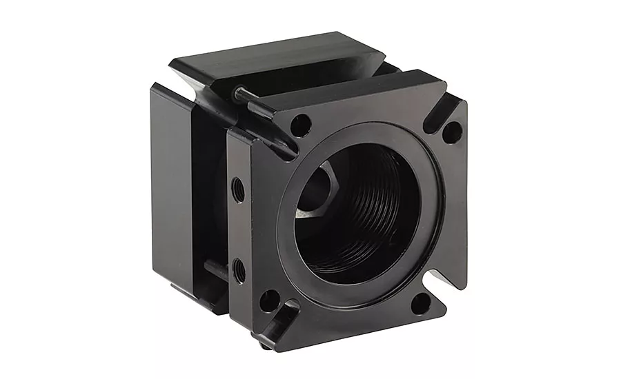

In some vertical lift applications, a servomotor drives the ballscrew. A flangemounted servomotor brake, installed between the motor and the lift flange, will hold the ballscrew and prevent back-driving. Photo courtesy Nexen Group Inc.

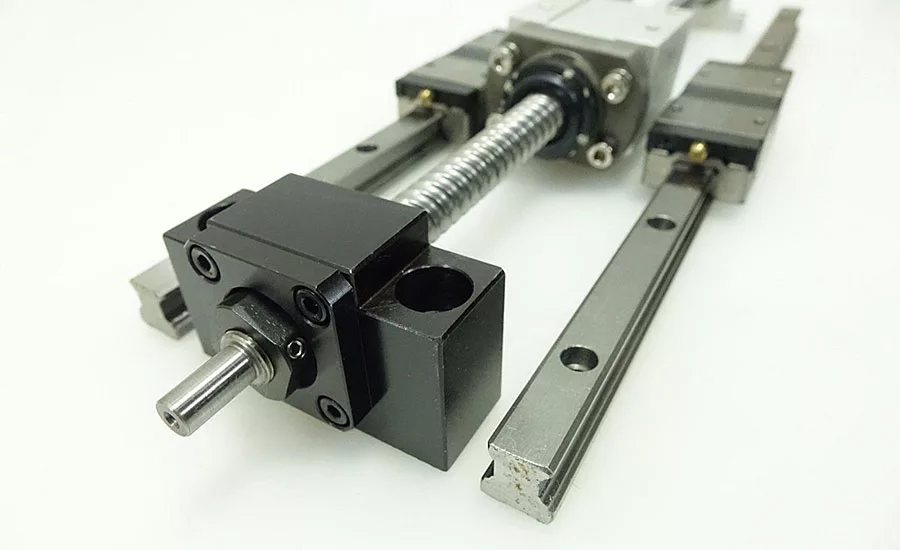

High-efficiency ballscrews will back-drive in vertical lifting applications, necessitating a brake to hold the load. Photo courtesy THK

High-efficiency ballscrews are ideal for precise, high-speed linear positioning. However, back-driving can be an issue, especially if the ballscrew is in a vertical position. If the ballscrew is not held properly, the load could drop quickly and cause damage to the payload, machine and workers.

One way to prevent that is to place a brake on the motor or ballscrew. Such brakes are spring-engaged, meaning power must be supplied to release the brake from the load (or, conversely, the brake automatically engages the load in the event of a power loss).
A spring-engaged, air-released servomotor brake works well, but there is one problem: Thermal expansion of the ballscrew can adversely affect the brake bearing. In addition to any ambient heat the ballscrew is exposed to, the screw itself generates heat due to friction. Together, that heat can cause enough thermal expansion in the screw shaft to affect its accuracy and performance. Every degree of temperature rise causes the ballscrew shaft to expand 12 microns per meter of length.
The axial forces created by thermal expansion of the ballscrew can be large enough to preload the brake bearing and cause the device to fail prematurely.
To solve that problem, Nexen has developed a spring-engaged, air-released servomotor brake made specifically for ballscrews. Our device incorporates a backlash-free elastomer coupling that compensates for up to 2 millimeters of axial misalignment. The coupling is fixed into the brake bore with an expanding cone shaft. The other end of the coupling has a clamping hub that attaches to the ballscrew.

One customer needed a spring-engaged, air-released brake with enough torque to hold an 885 pound load on a plastic thermoforming machine. The original spring-engaged, electrically released brake could not hold the load, which was driven by a servomotor and a ballscrew 30 millimeters diameter.
Our spring-engaged, air-released brake supplies 125 newton-meters of holding force. The brake attaches to the nondriven end of the ballscrew with a unique, elastomer insert coupling. The coupling consists of two halves. One half has a clamping hub and radial screw that attach to the ballscrew. The other half has an expanding shaft and tapered clamping element for attachment to the brake bore. This design enables the coupling to absorb any axial misalignment created by thermal expansion of the ballscrew.
The brake’s unique friction interfaces produce high torque relative to its size. The ballscrew brake is also a true, zero-backlash device. Zero backlash is important in many applications for accurate positioning and preventing the motor from producing free-wheeling rotation of the ballscrew.
In addition, air-released brakes have the advantage over electric brakes because no power is consumed while the brake is disengaged. That means air-released brakes are more energy efficient. They only use about 1.2 watts to power the pneumatic control valve. Electric brakes use a coil to keep the brake disengaged, consuming power and creating heat inside the brake. Excess heat detracts from the brake’s holding capacity.
