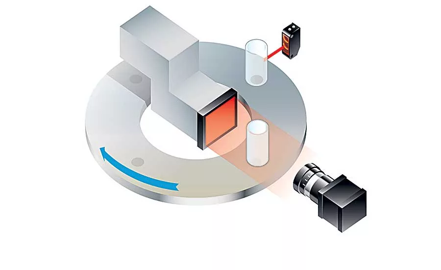

LEDs are the most commonly used illumination in machine vision applications. The type, orientation and wavelength of the light can all play a crucial role in delivering good images. However, stability and repeatability are absolutely essential for a vision system to perform consistently. Variation in illumination is unacceptable.
Image brightness is a function of the amount of light arriving at the image sensor. Clearly, the illumination source plays a critical role in this, but other components of the optical system—as well as external factors—also influence how much light gets to the sensor.

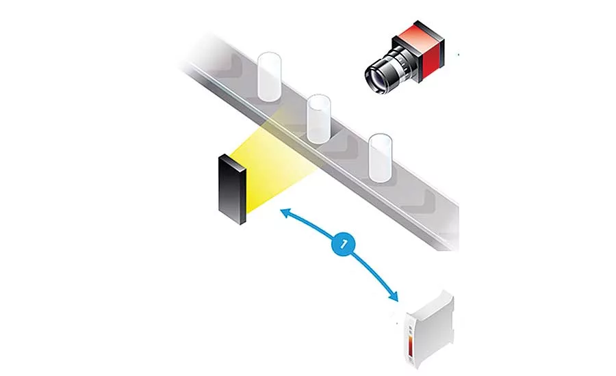

The intelligent lighting approach takes lighting control to a new level by networking the lighting, camera and imaging software to provide an integrated application with a single graphical interface for setup and control. Our Triniti intelligent lighting platform consists of three elements:
  • Light identification and operational data. Special chips mounted into LED lights provide information on model data, electrical characteristics, optical characteristics and usage information.
  • Integration of lights into software. These specially enabled LED lights can be seamlessly integrated into machine vision networks via a software development kit or an application program interface in major image processing packages. This provides engineers with a single graphical interface to set up the camera and lighting, visualize the timing and captured images, and save the settings to the camera and controller.
  • Expert light control. The system incorporates all the functionality of LED controller technology.
This link between imaging software, cameras, lights and controllers means that the illumination level within the system is known at any time.

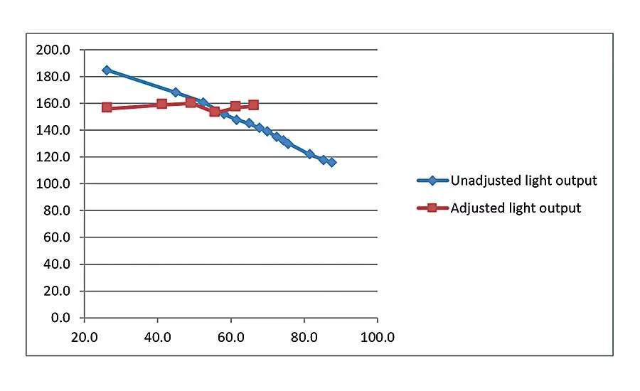

As LEDs heat up from 25 to 90 C, their brightness drops by up to 40 percent. This is a huge variation that may not be seen during system commissioning, but which can cause variability during normal operation. A system turned on in the morning might start cold and have a higher level of rejects until the lights reach the temperature at which the system was commissioned. Variation in light output due to temperature is around 0.6 percent per degree Celsius. This can be significant, even over small temperature ranges.

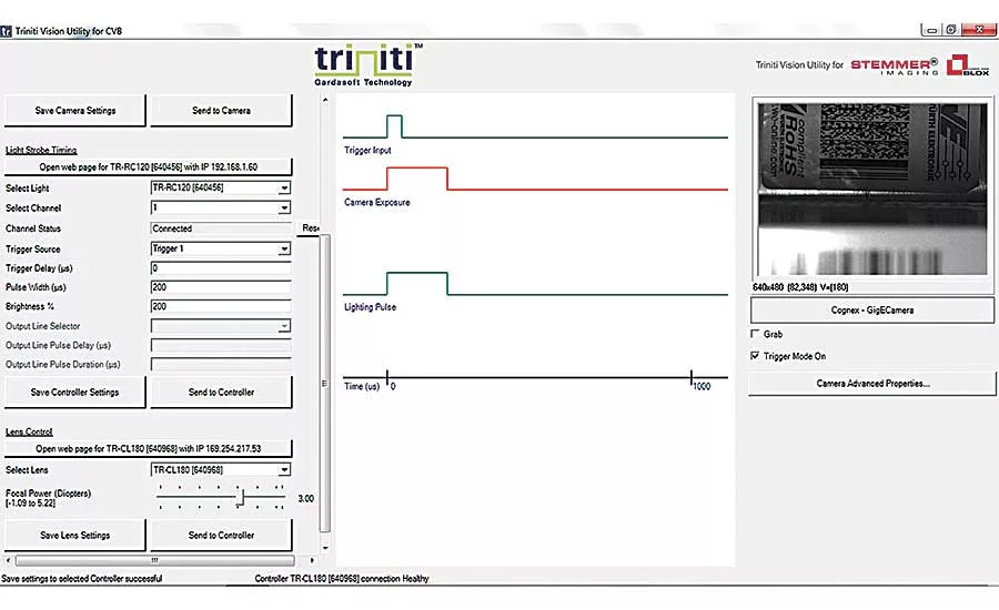

When using pulsed lighting, it is essential to get the timing of the lighting pulse and the camera exposure perfectly aligned to optimize image brightness. If they are not in alignment, the image will appear dark or, in the worst case, no image will be seen at all. By adjusting the lighting pulse delay, the two can be easily brought into alignment.
The Triniti intelligent lighting system enables engineers to set up the timing for the entire vision system, with cameras and strobe-mode lighting, all from one place. The Vision Utility interface provides a diagram that shows the timing of the camera exposure and the lighting pulse on one screen. It’s easy to see when the two are not aligned, and a live camera image shows the effect of the settings.

As LEDs heat up, their brightness drops by up to 40 percent. Gardasoft’s Triniti technology solves this problem. A chip built into a Triniti light allows the lighting controller to know the temperature of the LED. The chip can also hold a temperature compensation profile that describes how light intensity changes with temperature.
Temperature and age compensation for lighting are predictive techniques. They will often provide significant improvements for no extra cost or system complexity. Image processing can check that the predictions are not wildly inaccurate.
Full closed-loop compensation will take away the work needed to generate and test such predictions. Closed-loop control based on an optical sensor can be used to maintain constant light intensity. An optical sensor is arranged to measure the brightness of the light and provide this measurement to the lighting controller. The controller has a target brightness and adjusts the current to the LED to achieve it.

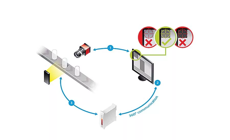

The most comprehensive way to control image brightness is to use a closed-loop approach based on image brightness detected by the camera itself. This is the most effective solution, since it accounts for any change in illumination conditions whether as a result of the LED or any external condition.
The closed loop includes the camera, LED, lens and lighting controller. This does require certain features within the view of the camera, and it will require some custom development by the system designer. The closed-loop system is structured as follows:
  • The camera identifies optimum illumination intensity for application.
  • The image processing application monitors acceptable operating illumination bandwidths.
  • The controller automatically adjusts lighting intensity as necessary.
To see how this works, let’s consider an inspection application involving a GigE vision camera and a Triniti-enabled LED light. In addition to its designated function, the camera also measures a defined area of the scene for illumination intensity. (This area is effectively a “test card” for the camera.) Measurements of the test card are continuously reported to the image processing software, which compares the data to a predetermined acceptable bandwidth of illumination for the particular inspection. If the bandwidth is contravened, then a signal is sent to the controller to increase the lighting intensity. The controller will then increase the intensity until illumination levels are back within the acceptable bandwidth.
This approach will not only compensate for variations in LED output intensity, but also for any variations in ambient light. The vision lighting can be reduced in brightness as ambient light gets brighter. The system will adjust light intensity without risk of damaging the LED, because the controller knows the maximum intensity of the light. In addition, the controller can send a “preventive maintenance” warning signal to replace the LED before any safety limits are exceeded. You can see a demonstration of this at the following link: www.youtube.com/watch?v=BNL7VnrZXw8.
