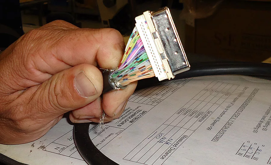

Cables for many of Components Express’s military and aerospace customers feature IDC-type very high density connectors. Photo by Jim Camillo

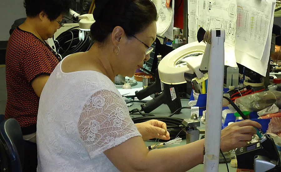

Forty people work at Woodridge full-time, including 25 in assembly and production. Photo by Jim Camillo

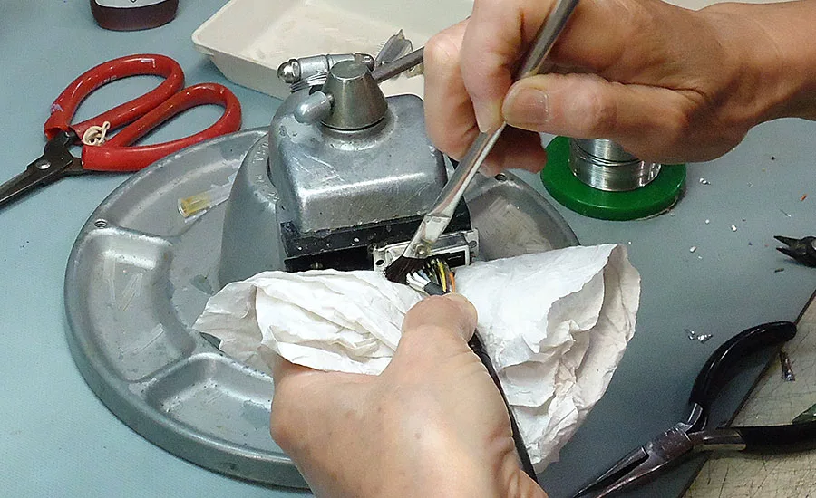

Wires are cleaned before and after soldering to ensure optimum cable performance. Photo by Jim Camillo

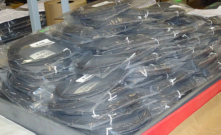

Finished cables are bagged, labeled and stacked in a staging area for quality inspection. After the inspector checks the cable to verify the accuracy of the label, he signs off on the order and places a second sticker on the bag. Photo by Jim Camillo

Forty people work at Woodridge full-time, with 15 in management and office work, and 25 in assembly and production. Although CEI specializes in multiconductor machine vision cables, its workers also assemble commodity cables, simple wire harnesses, various electrical components (cigarette lighter plugs, fans, switches, etc.) and patch panels with related cabling.

“People ask us why we solder most of our cable assemblies, since it’s more labor intensive and expensive than crimping,” notes Berst. “We believe that, when done right, soldering ensures a better connection, and it gives our customers a better product.”
All CEI assemblers are trained to the IPC 410B soldering standard. Several of them are able to meet NASA 8739.3 (soldered electrical connections) and 8739.4 (crimping, interconnecting cables, harnesses and wiring) standards as well.
In 2000, CEI began assembling cables for use on the International Space Station. Berst wanted to solder the cables (which had to meet the NASA standards) so he attended a couple weeks of training at Jet Propulsion Labs in Pasadena, CA. He then stayed on for further training to become an instructor for both standards.
“That training has proven to be invaluable for our company,” acknowledges Berst. “The NASA standards involve really sound practices, and we adopted a lot of them into our daily assembly methods. Some you can use all the time, but others are too expensive to do for many types of general cables.”

The connector most-often crimped at CEI is the IDC (insulation-displacement contact)-type VHDCI (very high density cable interconnect). This type of connector does not require the stripping of cable insulation. Instead, a blade displaces insulation to establish simultaneous contact with all conductors and achieve a gastight interface. Radcliff says that cables for many military and aerospace customers feature these connectors, which are installed with a custom-built company machine.

With testing complete, finished cables are bagged, labeled and stacked in a staging area for quality inspection. After the inspector checks the cable to verify the accuracy of the label, he signs off on the order and places a second sticker on the bag. In the shipping area, another person verifies the order number and contents before placing the bag in a shipping box and sealing it.

Solder training is done in-house by a certified soldering instructor. Berst says the benefit of this is the instructor teaches workers how to solder joints specifically pertinent to CEI, rather than generic joints.
“In a typical class, workers learn how to solder wire to a bifurcated terminal,” says Radcliff. “But, we have many applications involving gold cup [terminals], which require the person to tin and wick the cup twice prior to actually soldering the wire to it. Our instructor spends a lot of time with workers to make sure they know these specifics and do it properly. We have to, because some customers will actually X-ray the finished cable assembly to ensure that it’s done right.”
