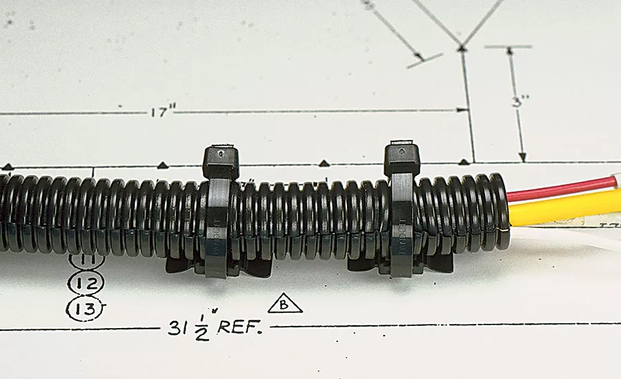

  • Spiral wrap tubing—allows cables or wires to enter and exit the covering at multiple points. Both polyamide and polyethylene are available. Multiple color choices allow for easy identification. For instance, orange is typically used on high-voltage applications.
  • Split loom tubing—a slit down the side makes it easy to insert cables or wires. The slit closes after installation, which eliminates the need to heat shrink or spot tape the ends, which cuts down on production time. Plastic tubing is typically made out of polyamide, polyethylene or polypropylene. However, it can be awkward to handle and does not compress wiring.

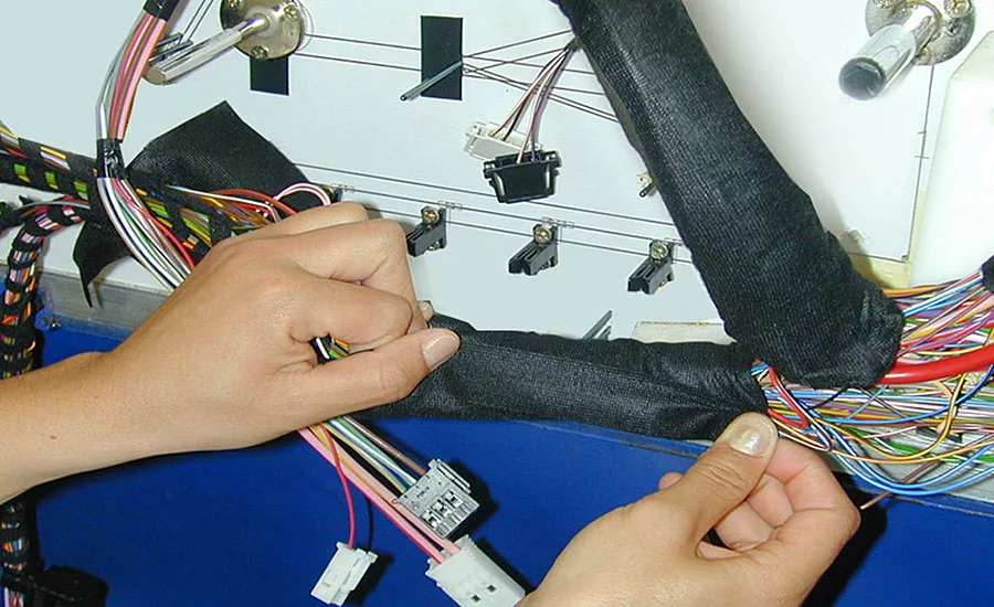

“Adhesive cloth tape can provide as much as 10 percent component weight savings vs. the use of traditional harness coverings, such as convoluted tubing,” claims Sam Brackett, wire harness market manager at Tesa Tape Inc., which specializes in the auto industry.
“Thermal management is another issue that affects the type of covering used today,” explains Brackett. “Cloth tape backed with an acrylic adhesive is still popular for under-the-hood applications. But, as engines run hotter in smaller spaces, there’s more need to protect harnesses from radiant heat. So, we’re now seeing more demand for tapes coated with reflective coverings, such as aluminum foil.
“Flexibility also continues to be a big trend,” says Brackett. “Ergonomic issues arise as wire harnesses run through different parts of an automobile. Therefore, there’s more demand today for sleeves instead of adhesive tapes.
“If you spiral wrap with a traditional adhesive tape, it tends to make the wire bundle stiffer,” warns Brackett. “We offer several varieties of sleeves that are only partially coated so that the majority of the wire bundle is not touching any adhesive. That makes it much more flexible.”
