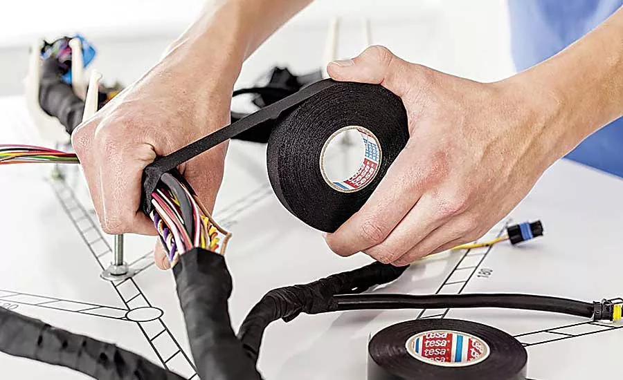

Tape for Wire Harnesses
Cloth tapes can provide heat and abrasion protection without sacrificing flexibility. Photo courtesy tesa SE

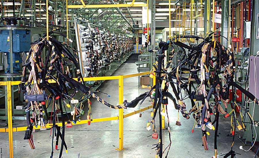

Sections of the wire harness can be wrapped in different tapes based on what type of protection it may require. Photo courtesy Scapa

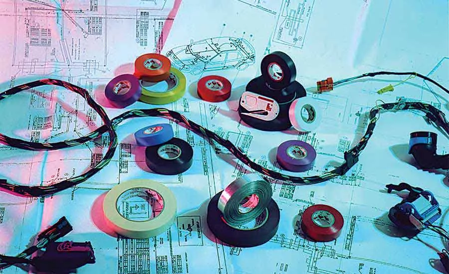

PVC tapes offer flexibility for easy positioning of the harness. Photo courtesy Scapa

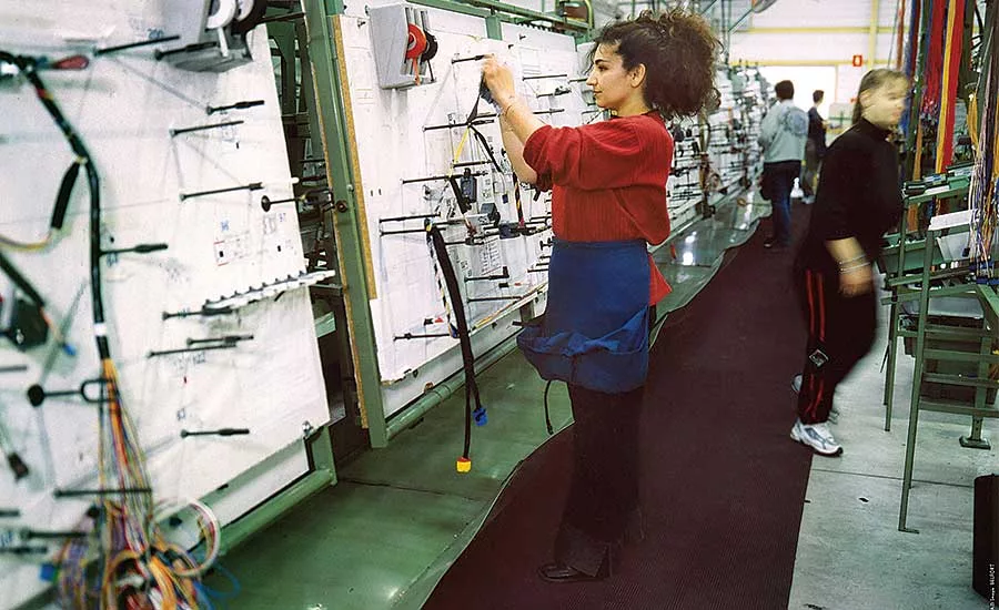

Due to complex design of wire harnesses, many automotive manufacturers will wrap them by hand. Photo courtesy Scapa

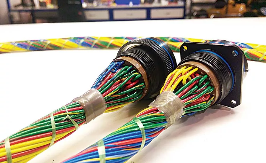

Bundling wires is the primary use for tape in wire harness assembly. Photo courtesy Mil Spec Wiring

While automation may have taken over much automotive manufacturing, manual application of tape to wire harnesses is still the standard. Phillips suggests that automated application isn’t as popular because of the complexity of wire harness designs. The complex design and critical function of wire harnesses requires precise application of tape. Most large automotive manufacturers apply tape manually because of the complexity and size of some sections of the harness, says Toussaint.
