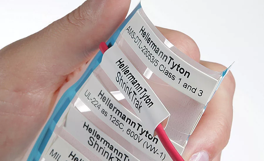

“Adhesive labels are the most economical and versatile marking option,” says Fries. “This is because each label can contain different information, and label application is easy and fast. Also, this type of label can usually be applied before or after termination.”

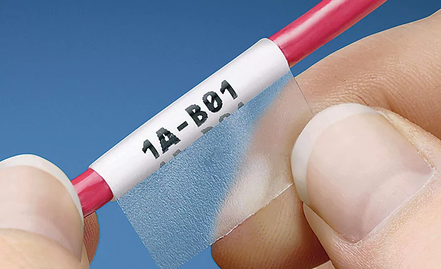

The most popular peel-and-stick types are preprinted self-laminating, flag and rotating labels. Self-laminating labels feature a clear section that overlaps and adheres to the printed area and serves as a protective lamination.
Each side of a flag label contains information that is easily visible to the end-user. When both sides are pressed together around a wire, the label protrudes. Another benefit, according to Fries, is flag labels can be applied before or after wire termination. However, they may catch on obstructions when pulling wire through plenums or other confined spaces.
Rotating labels are also self-laminating, but they turn slightly after installation to allow visibility from any angle. In addition, they allow repositioning along the length of the wire before and after cutting or termination. This flexibility lessens material waste, improves aesthetics and eases installation in high-density or space-restrained applications.

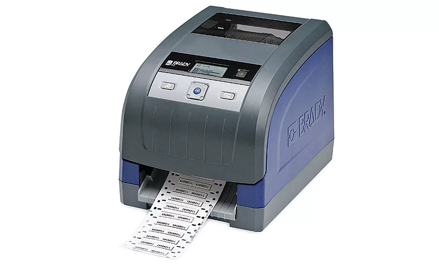

Many desktop printers are designed to handle HST, including the BBP33 from Brady. Giaimo says manufacturers with high-mix environments like the unit because material changeovers can be accomplished in 20 seconds. They also like that it enables printing from a PC and does not require material calibration, which can result in wasted labels.
An operator simply drops in the ribbon and label cartridge, locks it in place and starts typing. The printer prints labels from 0.5 to 4 inches wide, and is compatible with LabelMark, CodeSoft and MarkWare PC software.
