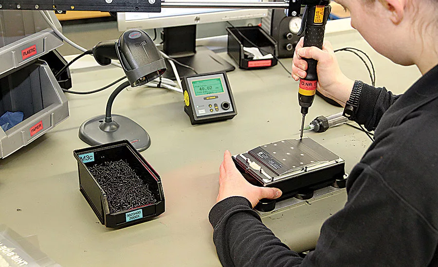

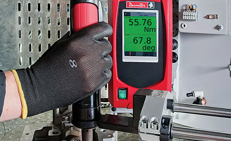

Power tools collect a wealth of data about the fastening process. With some simple statistical analysis, engineers can obtain valuable insight into the fastening process.
No matter how accurate the tool, there will always be some variation in how much torque is applied to a fastener. Myriad factors influence the process. Variation in air pressure, friction, part dimensions, operator skill and other factors means that one fastener will be slightly tighter or looser than the next. Statistical analysis can tell engineers when such variation is unacceptable.

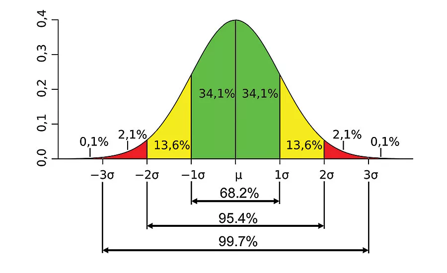

One way to look at fastening data is with a histogram, a bar graph that indicates how often certain values occur. In a histogram of torque data, for example, the X axis shows the range of torque values, while the Y axis shows how frequently each value came up. This histogram will follow a normal distribution. That is, the values are distributed along a bell-shaped curve that is symmetrical about the mean torque value.
Every reading in the set will differ slightly from the mean. The standard deviation is the amount by which each reading is most likely to differ from the average. Usually denoted by the Greek letter, s, the standard deviation indicates how well a process is performing. If torque accuracy is critical, engineers will want a curve that is tall and narrow.
To find the standard deviation, subtract the mean from the torque value of each fastening operation. Square each result, add them all together, and then divide this sum by the number of fastening operations. This is the variance. Take the square root of the variance to get the standard deviation.
In the histogram, the area under the curve that lies within one standard deviation of the mean represents 68 percent of all torque readings in the data set. The area within two deviations represents 95 percent of all readings, and the area within three deviations represents 99.7 percent of all readings.
Why is this important? If 99.7 percent of torque values fall within three standard deviations of the mean due to normal variation, such as friction, then engineers know a problem—something outside the norm—is occurring if the tool starts reporting torque values outside that range. Perhaps the tool is broken, or the operator is installing the wrong screw.

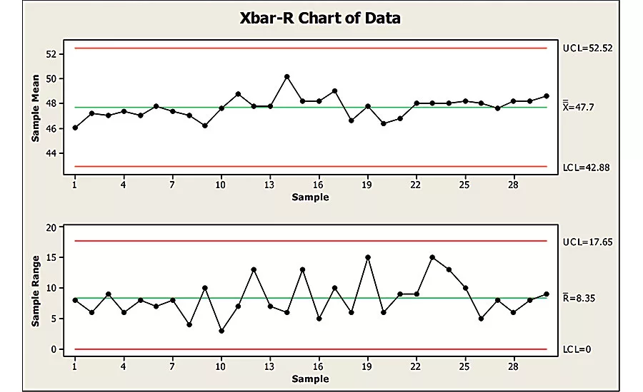

The goal of analyzing torque and angle data is to identify variation in the fastening process before faulty joints can be assembled. One way to do that is with statistical control charts called X-bar and R charts. If your fastening process is under control, all torque and angle values should be within plus or minus three standard deviations of the target value, or six-sigma limits. If a problem occurs—a tool breaks or a batch of substandard fasteners reaches the line—it can affect the average value, the spread of the values, or both. X-bar and R charts identify such problems quickly by comparing samples of data to your overall results.
To plot an X-bar chart, collect a sample of consecutive torque or angle readings at regular intervals. This can be once an hour, once a shift, once a day, or whatever makes sense for your operation or assembly. The sample size needn’t be very large. Four to six readings is sufficient. Bear in mind that the shorter your sampling interval, the faster you can identify potential problems.
Next, calculate the mean (X-bar) for each sample and plot them over time. When the assembly process is under control, the sample averages will spread randomly around the overall mean (µ). In addition, the sample averages should fall within the upper control limit (µ + 3s√n, where n is the number of overall readings) and the lower control limit (µ - 3s√n). The overall mean and control limits are indicated by horizontal lines running across the chart. For best results, these values should be based on a large number of fastening operations, and they should be recalculated at regular intervals.
The X-bar chart shows how much variation exists in your fastening operation from hour to hour, shift to shift, or whatever sample period you’ve chosen. Because the spread between individual measurements is bigger than the spread between sample averages, you have a better chance of detecting deviations from the overall mean by analyzing the samples rather than the entire data set. If the sample average trends upward or downward, or if it’s consistently above or below the overall mean, something abnormal is happening. Production can continue, but the process should be looked at. If the sample average falls outside the control limits, assembly should stop and engineers should investigate the problem immediately to prevent substandard joints from being made.
The R chart, or range chart, performs a similar function. It shows how much variation there is within each sample. Ideally, this variation should be small and consistent over time. As with the X-bar chart, trends and outlying points indicate that something out of the ordinary is happening on the line.
Instead of plotting the average of each sample, you plot the range—the difference between the biggest and smallest value in each sample over time. (A cousin of the R chart, the S chart, plots the standard deviation of each sample.)
Like the X-bar chart, the R chart has horizontal lines running across it, representing the target value and upper control limit. If the sample size is six or less, there is no lower control limit. In this case, the target value is the average of the range values of all the samples. The upper control limit is the average range times a statistical constant: 2.282 for a sample size of four, 2.114 for a sample size of five, and 2.004 for a sample size of six.
