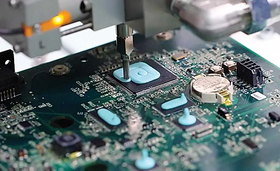

Thick material—be it grease, sealant, solder paste, filled epoxy, thermally conductive gels and paste, or form- or cast-in-place gaskets—poses special challenges for dispensing equipment. Knowing this, manufacturers rely on precise valves and powerful pumps and delivery systems to provide accurate, repeatable and drip-free deposits in every application.

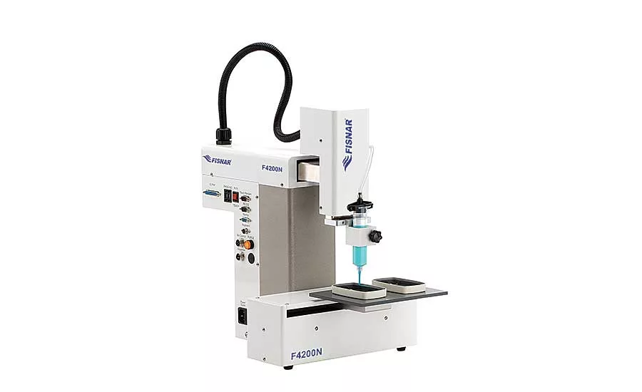

The Fisnar F4000N.1 series of three-axis benchtop robots can be used as part of a dispensing system that accurately dispenses thick sealants. Made by Fluid Research Corp. (an Ellsworth Adhesives company), four models are available (F4200N.1, F4300N.1, F4400N.1, F4500N.1), with work areas of 200, 300, 400 and 500 square millimeters, respectively. The robots offer 0.02-millimeter repeatability, 0.001-millimeter resolution and a USB port that allows easy data transfer to a PC. They store up to 100 dispensing programs (50,000 points per program).

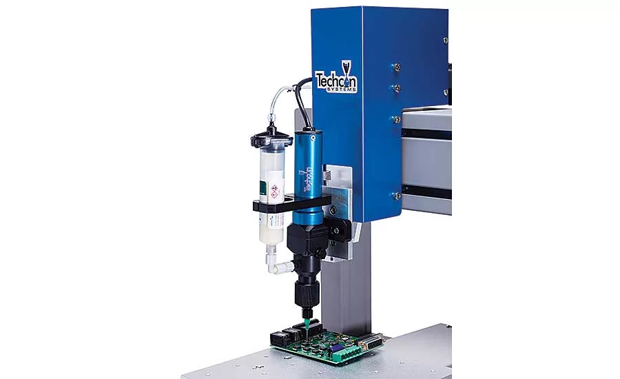

Techcon’s TS8100 positive displacement pump dispenses materials ranging from low-viscosity coatings to high-viscosity greases, paste and flux. The pump creates a volumetric flow that does not change the shape or size of the material, and offers repeatability of ±1 percent. Easy to clean, the pump comes with syringe and mounting brackets, a Luer lock fitting and a dispensing tip selection pack.

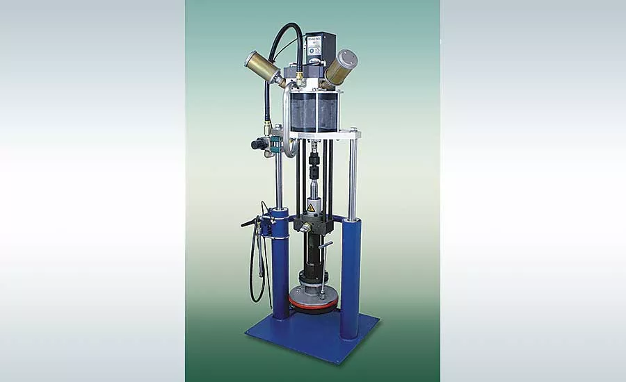

Ratio pumps are also for pails and drums. Long says this type of pump increases thick-material flowability by multiplying the air pressure level placed upon the material by a specific ratio. For example, if the pump ratio is 2-to-1, and 50 psi of air pressure enters the air motor, material will leave the pump at 100 psi.
Nordson EFD’s Rhino ratio pump comes in 5-gallon and 55-gallon models, both of which are available with a ratio of 48- or 65-to-1. Volumetric displacement of the lower ratio is 8 cubic inches per stroke, with a maximum output of 4.2 liters per minute. For the higher ratio, it’s 5.8 cubic inches per stroke, and an output of 2.8 liters per minute.
All models work with the company’s 736HPA high-pressure valve (up to 2,500 psi). They are modular in design and allow quick changeover of the air motor for uniform material output. Options include automatic depressurization, an air regulator and casters.
