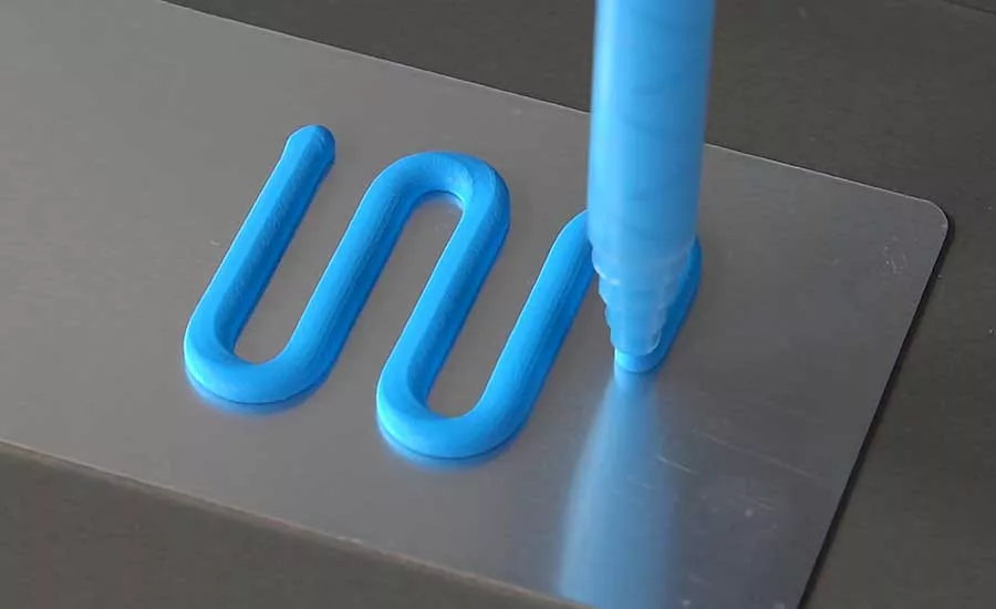

Blue in color, this two-component thermally conductive paste is highly filled and placed in gaps. Photo courtesy Ellsworth Corp.

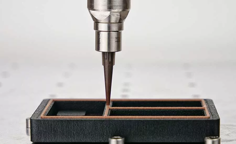

Here, filled encapsulant material is used for potting sensitive electronics. Photo courtesy Scheugenpflug Inc.

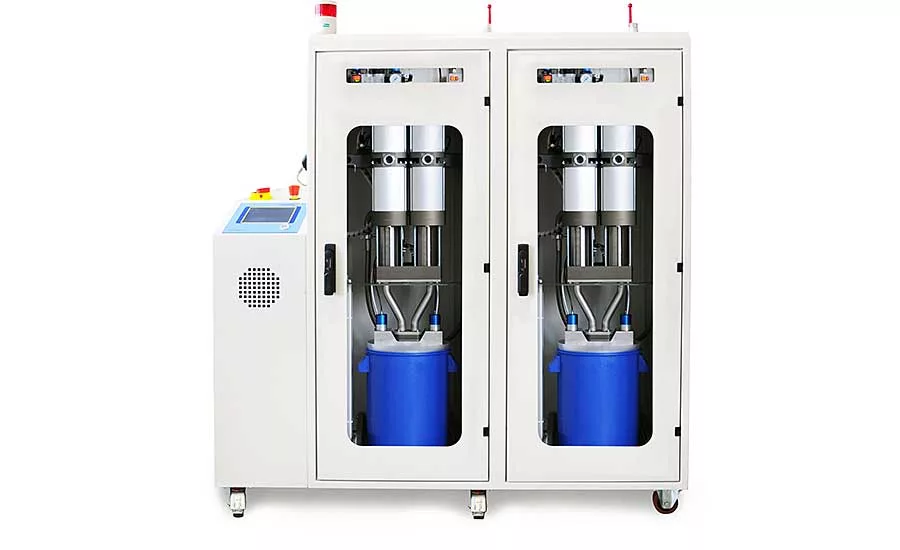

The dual-piston A280 follower plate pump efficiently delivers highly abrasive, paste-like filled material. Photo courtesy Scheugenpflug Inc.

Scheugenpflug frequently uses its A280 follower plate pump in delivery systems for highly abrasive, paste-like filled material. This dual-piston pump only comes in contact with the material on one side, while a barrier fluid on the reverse side prevents abrasive fillers from adhering to the pump seals. Zinn says this design maximizes reliability and service life.
