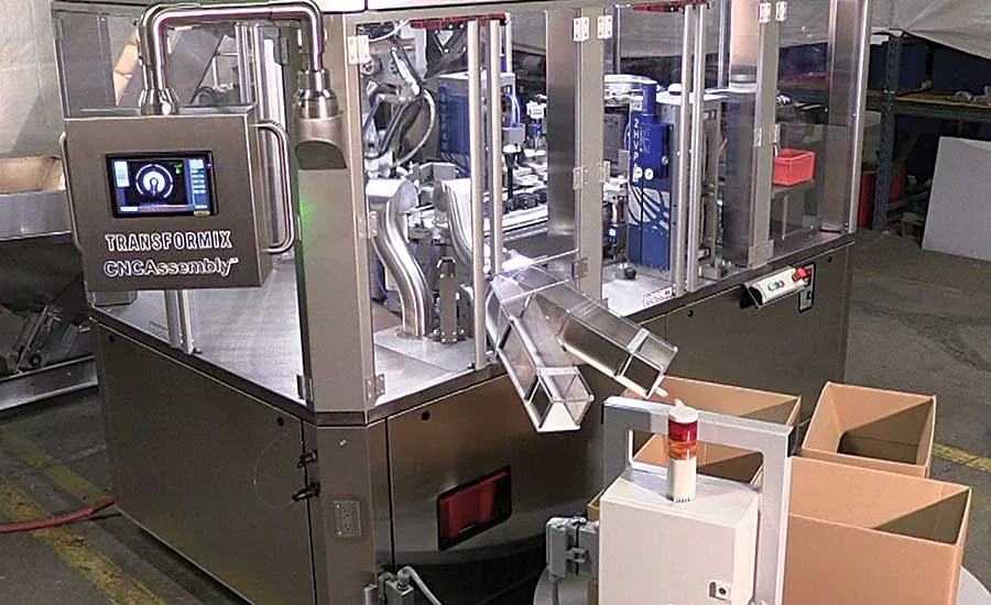

Instead, the company opted to redesign its automated assembly systems, investing in CNCAssembly technology from Canadian systems integrator Transformix Engineering Inc.
CNCAssembly technology uses electronically cammed servomotors to assemble products at higher rates than traditional indexing machines. The system can independently move and electronically synchronize all assembly and part-handling motions.

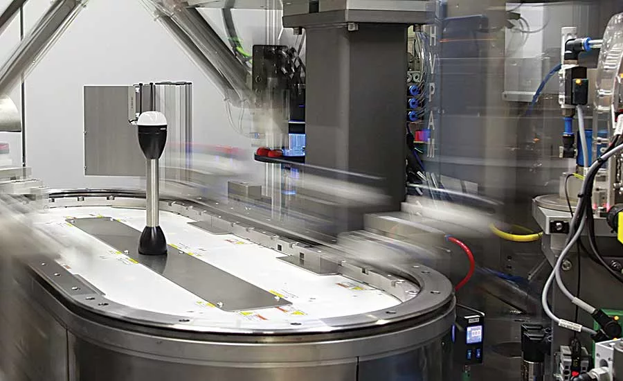

For the manufacturer’s application, the CNCAssembly system consists of seven assembly stations linked together by a linear-motor transfer system.

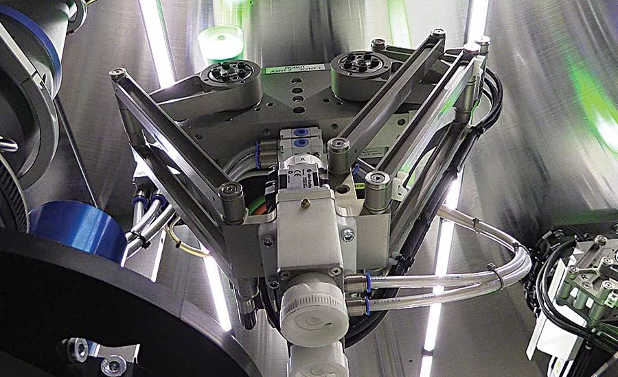

A pick-and-place robot then picks up two bases and orients them both before placing them on one of the servo-controlled pallets that move bases from station to station. As soon as the operation is completed, the pallet moves to an inspection location where another vision system performs additional inspections to confirm placement of the two bases.

At station 4, a robot orients and assembles plastic spacer-plates onto the bases. A vision system inspects the subassemblies to verify that each part has a spacer-plate and it is correctly positioned on the silicone spacer.
At station 5, covers enter in two lanes in a known orientation. An RSM disc external to the line singulates the covers and presents them for vision inspection to confirm their identity. Bad or unidentifiable parts are ignored by the robot and rejected. The robot then picks two covers, tilts them to the proper orientation, and presses them down onto the subassemblies.

The new machine can easily produce more than 75 variants with only a 5 minute per station changeover time, enabling the machine to run nearly continuously to produce whatever part is in greatest demand at the moment. The machine requires only one operator, providing a significant reduction in labor expenses.
The production rate of the new machine is 300 parts per minute, which exceeds the production of all six previous machines combined. If needed, the machine could be retooled and reprogrammed to assemble a new product.
