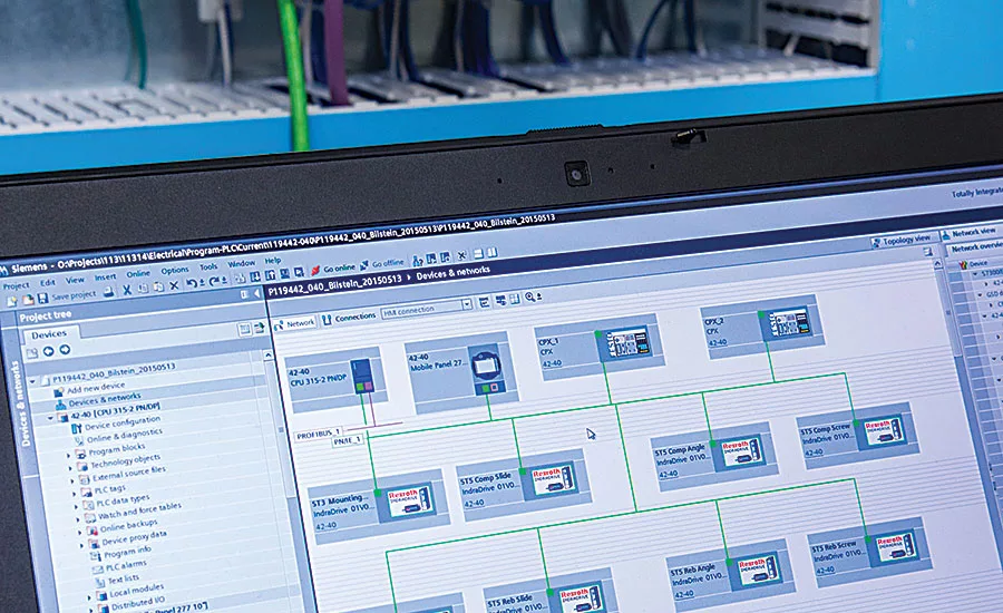

For the project, C&E Sales supplied drives, PLCs, a master HMI and remote-control pendants from Siemens. C&E Sales also recommended the TIA Portal, an engineering network from Siemens that allows motion controllers, distributed I/O, HMIs and other devices to be programmed through a single point of command. In addition, the TIA Portal maintains a library with the operating protocols, hardware designations and performance characteristics of task-specific projects, enabling subsequent recall and system reconfiguration on the fly. That saves a substantial amount of engineering time for both the integrator and end-user.
We were able to use the TIA Portal at every step in the configuration and commissioning of the assembly stations devised for ThyssenKrupp on this project. Although the line would be assembling a range of products, they were all similar in nature and mechanical composition, so many of the motion control commands and assembly sequencing could be done using the library of programmed information in the TIA Portal.

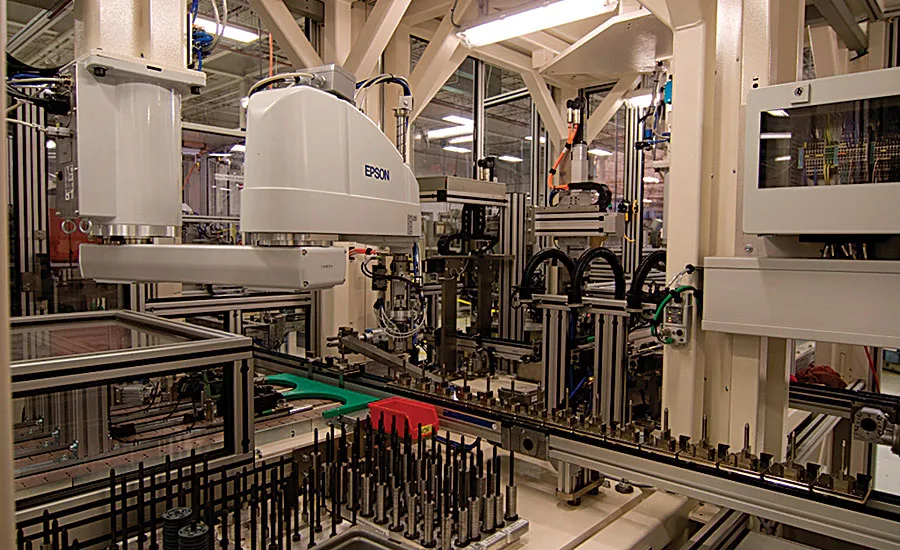

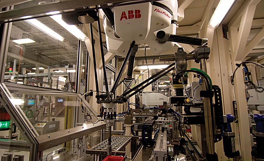

The parts for the shock absorbers are brought to the assembly stations by a series of four-axis iRB 360 FlexPicker robots from ABB Robotics and ceiling-mounted G10 SCARA robots from EPSON Robots.
For each model of shock absorber, an assortment of washers with various profiles and dimensions are stacked on a piston and riveted in place. Then, the shock absorber body is filled with gas and oil to preprogrammed levels. The “recipe” for each model is stored in the line’s main HMI, which drives the PLC.

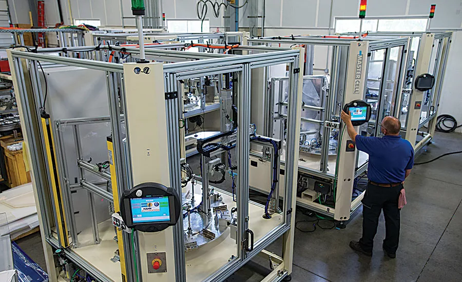

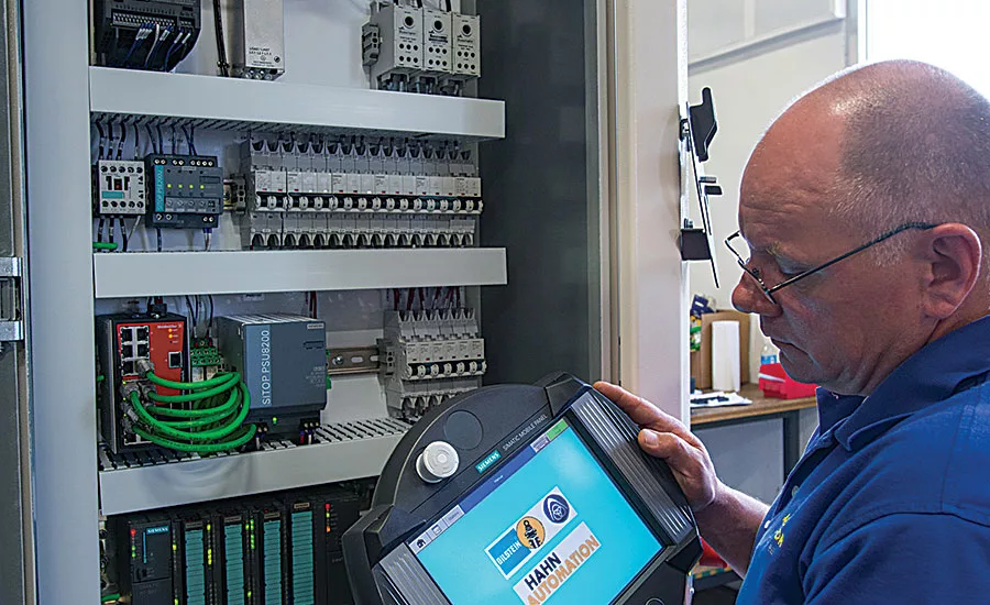

At each station in the line, an operator can instantly visualize the recipe in progress. Thanks to the remote-control pendant, the operator is free to move around the cell as needed to monitor and manage the assembly process. When changeover is required, the master HMI exports the specific model’s assembly requirements to each station.
The various commands are executed via the PLC, an S7-1500 from Siemens, which integrates seamlessly with the TIA Portal as well as with the safety and security systems at each station.
The PLC has a high-speed backplane bus with a high baud rate and an efficient transmission protocol for fast signal processing. It has multiple Profinet ports and IP addresses: two ports with identical IP addresses for field-level communication, and two additional ports, each with its own IP address, for integration into the company network.
CPU status requests are performed over a standard Internet browser. Process variables are displayed in graphical form, and user-defined websites facilitate the acquisition of information.

The setting adjustments are quite substantial for each shock absorber model, so the data load on the control system required strict monitoring and validation.
“The Siemens TIA portal was a terrific engineering tool, as we were able to configure all the motor and drive components in a tag-based protocol for the individual slave PLCs and the master HMI,” says Greg Earle, vice president for sales at Hahn. “It was a very fluid connection process and, in the field, the operators enjoy the added benefit of movement, using the remote pendants provided with the system.”
