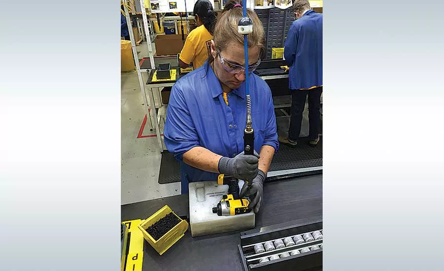

A worker uses a pneumatic screwdriver to install screws in a cordless impact wrench. Photo courtesy DEWALT

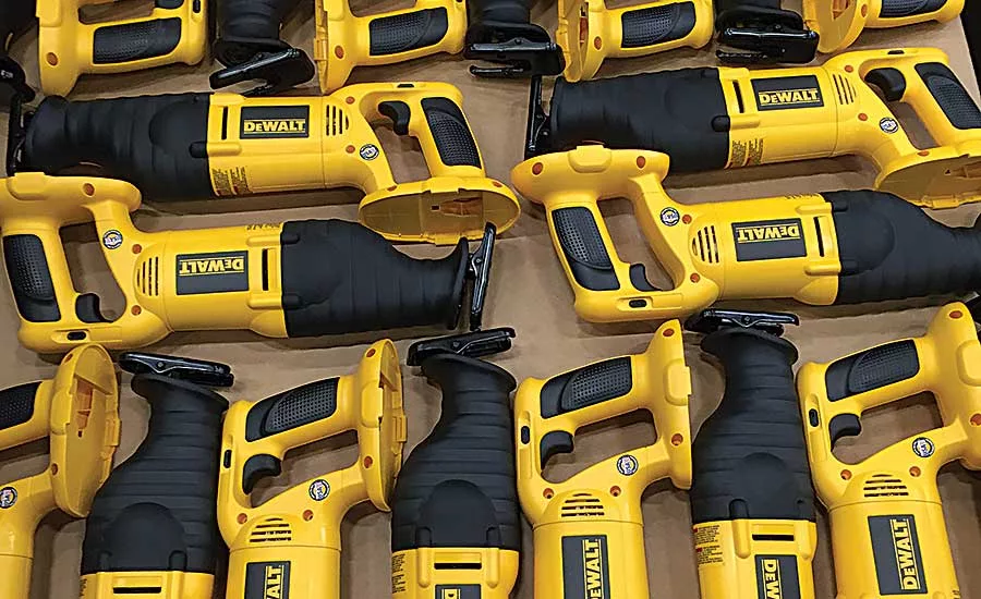

The Charlotte plant makes a variety of 18- and 20-volt cordless tools, including reciprocating saws. Photo courtesy DEWALT

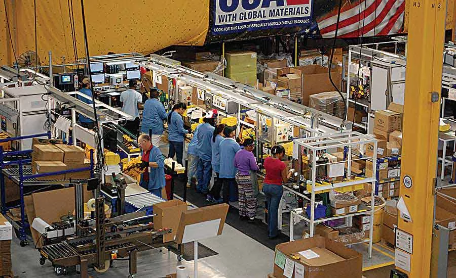

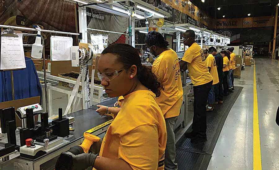

Cordless tools are mostly assembled manually. Lines consist of a series of workstations arranged end-to-end in a U-shaped cell. Photo courtesy DEWALT

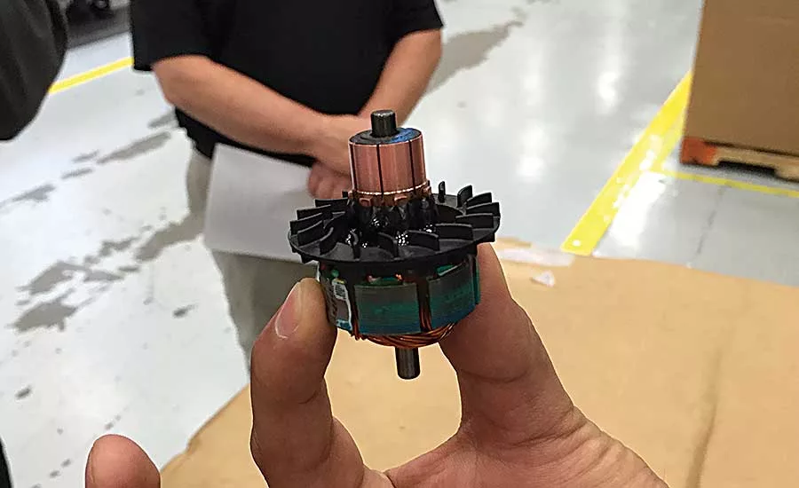

DEWALT makes all the brushed and brushless motors that go into its tools. Photo courtesy DEWALT

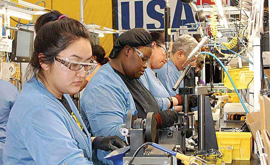

The tool is assembled manually. I began in the middle of a nine-person line consisting of a series of workstations arranged end-to-end in a U-shaped cell. Each workstation has uprights featuring task lights, parts bins, tool balancers, visual assembly aids, and other equipment. Everything is within easy reach. Behind the workstations, flow racks equipped with casters keep workers supplied with parts and subassemblies.
The tool is passed from worker to worker in a clever fixture made from a soft plastic. The fixture is designed to securely hold the tool vertically or horizontally. When the tool is fully assembled and ready for testing, the empty fixture is placed on an inclined roller conveyor, which takes it back to the start of the line.
When I get the tool, it’s pointing up. My first task is to install four screws to attach the metal housing (containing the transmission, chuck and torque adjustment collar) to the main body of the tool. Using a slim, push-to-start pneumatic screwdriver suspended from a tool balancer, I install the screws in a crisscross pattern to ensure even tightening.
So far, so good. I swap places with the worker next to me. Then, I lay the tool on its side and install eight screws to hold the two halves of the body together. Perhaps with a few more days (or weeks) of practice, I might be as quick as the pros on the line.

Many power tools are driven by brushed motors, which are commutated mechanically. As the rotor turns, pairs of commutator bars contact the brushes in succession, connecting electrical power sequentially to different sets of armature windings, which keeps the rotor turning. The main drawback of these motors is that the brushes wear out and must be replaced.
DEWALT’s next-gen cordless tools are driven by brushless motors. In a brushless motor, the magnets are on the rotor, and the windings are wrapped around poles on the stator. Instead of brushes and a commutator bar, the windings are switched on and off sequentially by solid-state electronics. Besides needing less maintenance, brushless motors are smaller, lighter and more efficient than brushed motors.

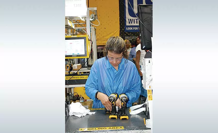

When the tool passes muster, I move to the labeling station, and it’s here where I run afoul of Tony Segura, team lead for DEWALT’s premium brushless tool lines. My task is to apply seven adhesive-backed labels to various locations on the tool. For example, on the left side of the tool, just below the DEWALT name, there’s a small rectangular recess where I must apply a label with the name of the tool. It seemed easy enough, but my label was, perhaps, not as straight as it could have been.
“No, that’s not good,” says Segura, checking my work. He peels off my shamefully crooked label and applies a new one.
As I apply the remaining labels, Segura keeps an eye on me the way an owl might watch a mouse. When I finish, Segura places the tool in a custom error-proofing fixture equipped with various sensors that automatically check for the presence of all seven labels. I was beginning to feel bad about my label-application abilities, until I learn that every tool DEWALT makes goes through the same check.
It may have been “just” a label, but, of course, it’s a part seen by the user every time he picks up the tool. Anything less than perfection in something so simple and obvious as a label might lead the consumer to question the quality of the rest of the product.

In addition to the cordless drill and driver, the Charlotte plant makes a variety of other 18- and 20-volt cordless tools, including hammer drills, impact wrenches, reciprocating saws and flashlights. The factory also makes the brushed and brushless motors that go into the tools. The facility opened in October 2013, and on Feb. 20, 2017, the plant produced its 10 millionth tool.

U-shaped assembly cells—each dedicated to a specific tool family—line the perimeter of the factory. In the middle are automated assembly systems for making brushed and brushless motors. Lean manufacturing principles guided the layout for efficient inflow of parts and outflow of finished goods.
“We had a kaizen event before we ever placed a machine,” says Zielinski. Engineers used cardboard cutouts, 5S projects and value-stream mapping to determine the ideal layout.

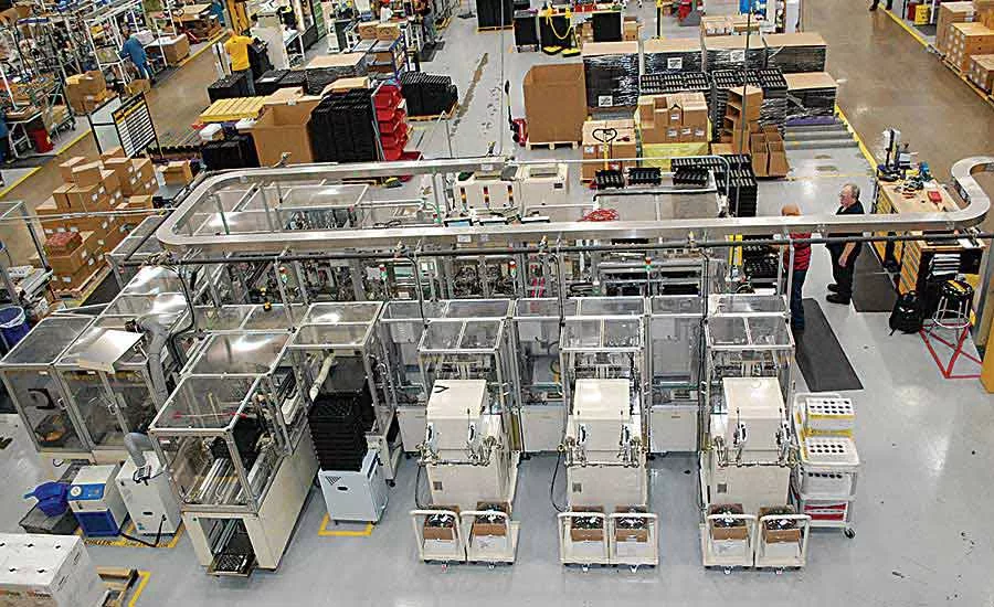

Zielinski is particularly proud of the brushless motor line, which was installed less than two years ago and requires just two people to operate. The compact, fully automated line can wind and assemble four different motors. The tooling needed to assemble each motor variant is stored right on the machine, so changeover can be accomplished quickly.
DEWALT had been importing the motors, but the new line nixed that. “It reduced our lead time for brushless motors from six weeks to 12 feet,” he says.
