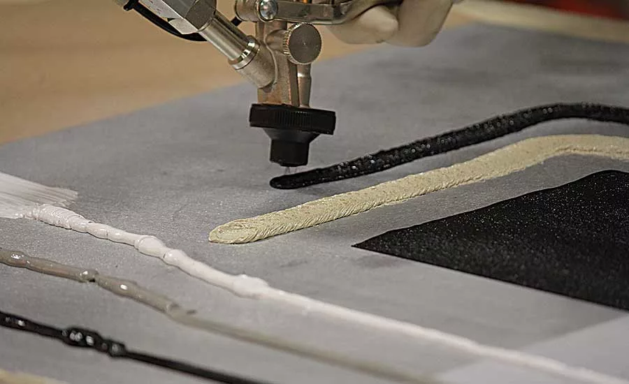

Seam sealers are available in one- and twocomponent formulations. The photo depicts a seam sealer being applied to a rear body panel. Photo courtesy Lord Corp.

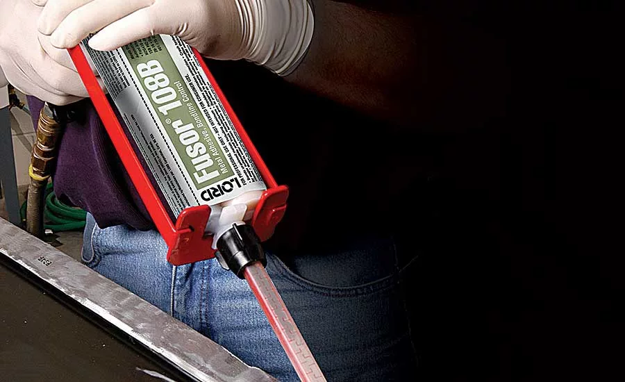

Fusor 108B is a two-part structural acrylic adhesive for bonding aluminum and steel. It can be used for panel bonding, weld bonding and rivet bonding. Photo courtesy Lord Corp.

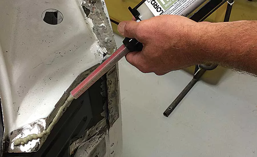

A major advantage of acrylics is that they bond to metals and composites with minimal surface preparation. Photo courtesy Lord Corp.

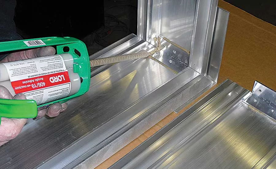

Lord 406 is a two-part, structural acrylic adhesive for bonding metals and thermoplastics. Glass beads mixed into the adhesive ensure a uniform thickness to the bond line. Photo courtesy Lord Corp.

Seam sealers seal flanges and joints to prevent water leaks and corrosion. A variety of chemistries are available, including urethanes, epoxies or MS polymers (silyl-modified polyethers). They are offered in one- and two-component formulations. Two-component sealers will cure through a chemical reaction; one-component sealers cure through a moisture reaction. One-component sealers will set in one hour and fully cure in approximately 72 hours. Two-component sealers set up quickly in 5 to 15 minutes and are fully cured in 24 hours. Older sealers cured through evaporation of solvents.
Certain one-component sealers, such as windshield urethane, will not attain a strong bond directly to metal. For metal-to-metal applications, use direct-to-metal sealers for the best results and to prevent corrosion.

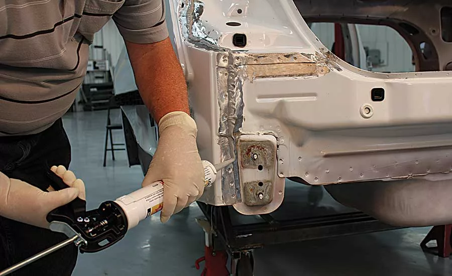

There are three common methods of using seam sealers. One is to apply the sealer over the joint to cosmetically hide it or seal it. Another option is a weld-
through sealer. The sealer is applied in the joint between panels. The panels are then joined via resistance spot welding or mechanical fasteners, such as rivets. Finally, there are LASDs. These seam sealers are applied to a panel to add mass, stiffen the metal, or create an insulting layer. LASDs can be applied with a trowel or spray gun.
A controlled-flow seam sealer is ideal for use on sloped surfaces, roof channels, drip rails, and truck-bed floor seams. The formula is easy to dispense in a smooth bead. Self-leveling seam sealers are used mainly on roof-ditch areas, but can also be used on core supports, aprons, truck seams and roof-deck quarter panels. This sealer self-levels within the applied area. Sprayable sealers are applied to trunk floors and wheelhouse areas to provide a textured surface. They can also be used as a stone-guard coating for rocker panels and the lower portions of exterior body skins. With an atomized pneumatic spray gun, the operator can control the thickness and texture of the sealer.
