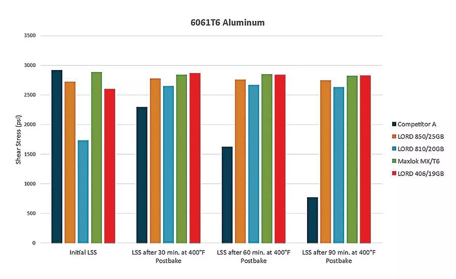

LORD acrylic adhesives will not degrade even after being exposed to temperatures of up to 400 F. LORD engineers bonded aluminum test strips with various adhesives and then heated them to 400 F for up to 90 minutes. Four acrylic formulations from LORD showed no loss of shear strength. Source: LORD Corp.

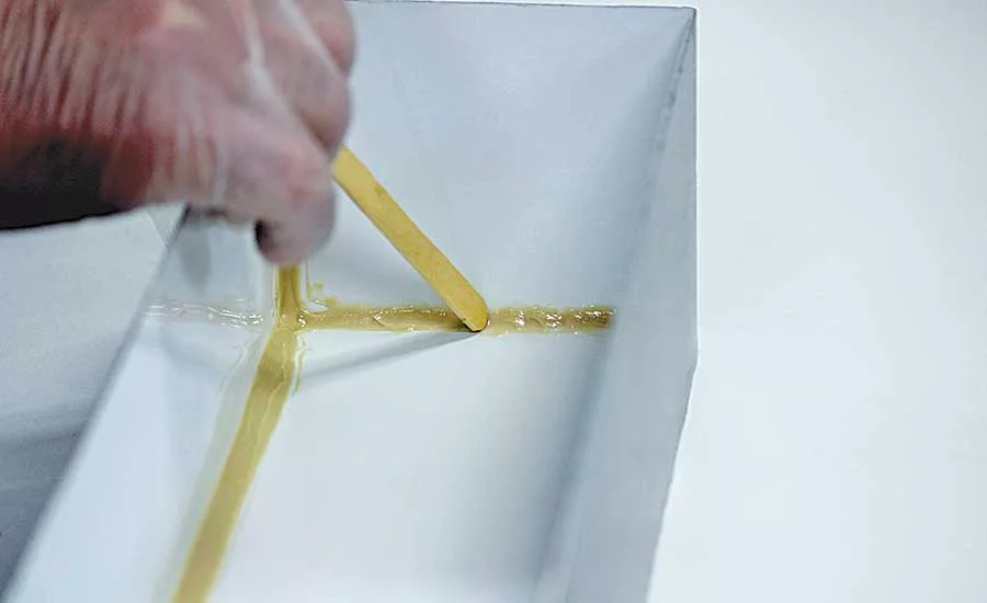

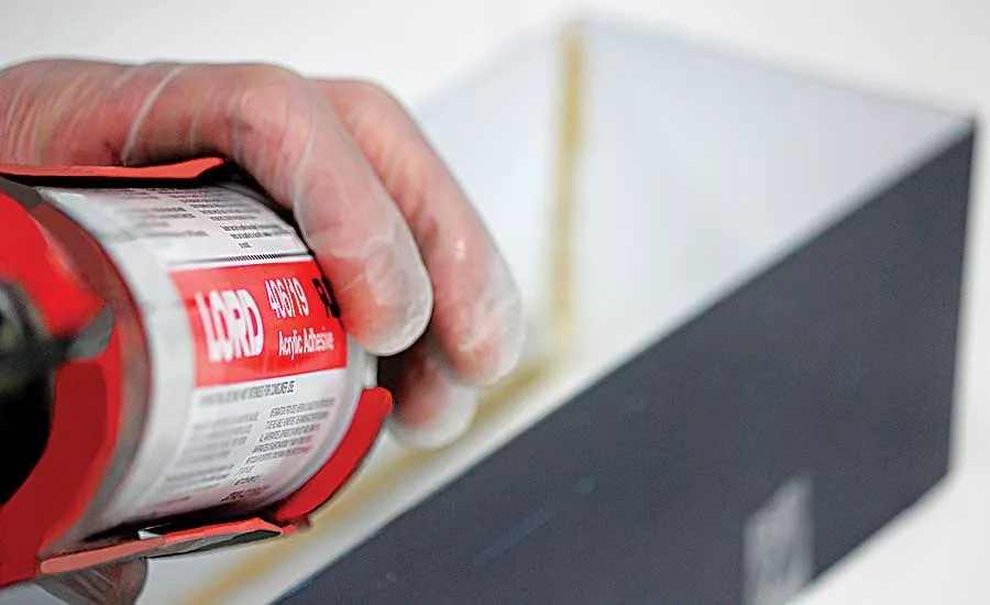

It is a common misconception among fabricators that bonding with two-part acrylic adhesives before powder coating cannot be successfully accomplished because high temperatures used in the process raise concerns about possible degradation of the cured adhesive. Engineers believed that their only options were rivet bonding, mechanical fasteners or welding.
However, not only is powder coating after bonding with adhesives possible, it can eliminate some of the challenges and issues associated with other assembly methods.
Adhesives can also help reduce corrosion caused by welds and provide aesthetic benefits with assemblies by allowing several joints to be bonded together and undergo the powder
coating process without rework. The integrity of the bond remains unchanged after powder coating and greater strength is often seen after exposure to heat once an assembly has been returned to ambient temperature.
Some readily available acrylic adhesives will not degrade at the higher temperatures associated with powder coating. With the ability to withstand heat of up to 400 F for up to 90 minutes, acrylic adhesives provide fabricators an alternative to welding and fastening.

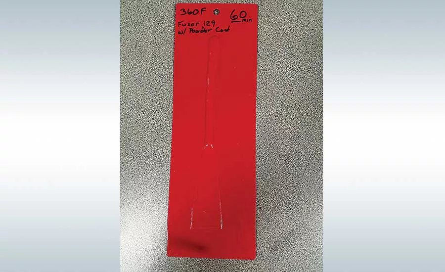

Powder coating ovens range from 400 to 450 F. “Most adhesives break down at this grade,” Gielda says. Normal liquid coat temps range 325 to 350 F. “That is why powder coating is such a challenge,” he points out. “It’s about 100 degrees or so hotter.”
The adhesive would essentially get too “gooey” and then get above the glass transition temperature where chemicals start to crystallize, Gielda adds. Now, next-generation acrylic adhesives make it possible.

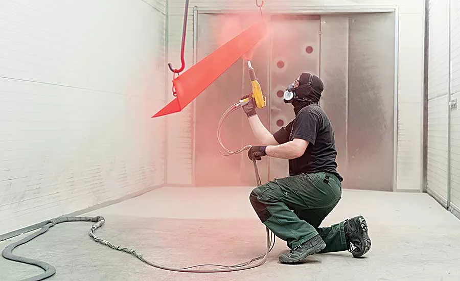

Although LORD acrylic adhesives will not degrade at the higher temperatures associated with powder coating, it is important to note that the hot tear strengths will be very low. At about 180 F, the adhesive will begin to soften.
Care should be exercised when racking a part prior to powder coating. Hanging large parts from a bonded section can lead to failure. Instead, the part should be suspended from the solid structure and not from bonded subassemblies.
These lower-strength values make it essential that the assembly is properly placed to avoid slippage of the bonded pieces, especially if an assembly is heavy. They need to be fixtured to prevent any stresses between when the adhesives are soft and when they return to room temperature and re-harden.
Mechanical fixtures or process welds are frequently used in the industry to hold the assembly in place. These are process spot welds, not structural spot welds, so they don’t compromise the integrity or durability of the surface. There are fewer welds that are much smaller in diameter than when welding is used as the main source to attach an assembly to a surface. The area to be bonded can also be masked off prior to powder coating with bonding done afterwards.
