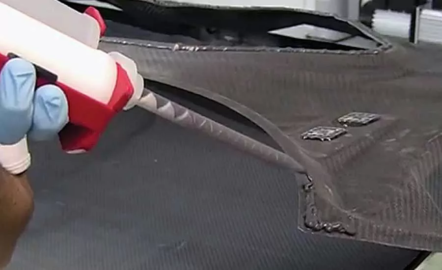

Permabond’s newest urethane adhesive, PT326, was formulated to provide a longer open time so it could be dispensed onto automotive components made from carbon fiber. Photo courtesy Permabond Engineering Adhesives

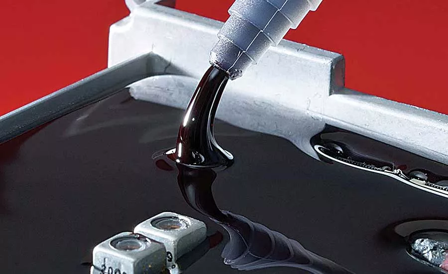

This urethane potting and encapsulating compound (No. 50-2369FR) has been formulated to meet the stringent flame-retardancy requirements of UL94 V-0. Photo courtesy Epoxies Etc.

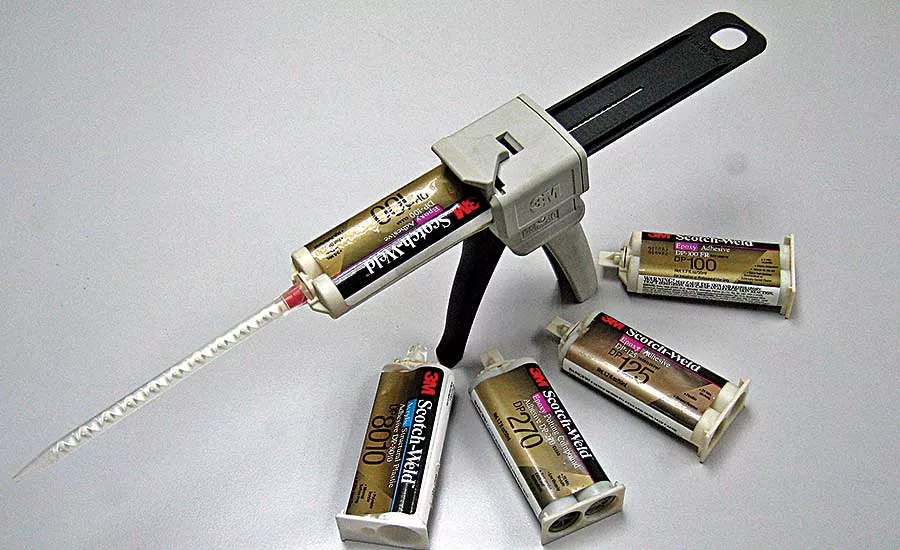

Two-part urethanes can be dispensed from side-by-side cartridges or with metering equipment. Either way, the adhesive is best dispensed with a static mixer. Photo courtesy 3M

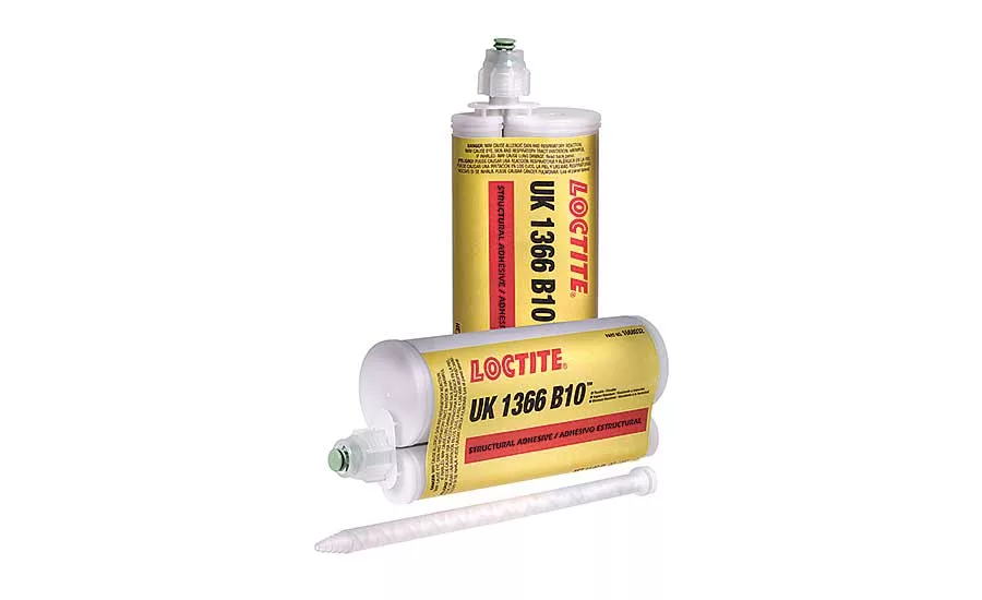

Loctite UK 1366 B10 is a highly flexible urethane adhesive that bonds to a variety of metals and plastics. It exhibits excellent resistance to moisture and impacts. Photo courtesy Henkel Corp.

Two-part formulations can be dispensed from side-by-side, fixed-ratio cartridges or with metering equipment. Either way, the adhesive is best dispensed with a static mixer. “Some formulations are very tolerant of slight variations in the mix ratio. Others have to be right on the money,” says Siroka.
“To ensure proper mixing when dispensing any two-component product with a static mixer, dispense an inch of product onto a paper towel before dispensing on the part, since the first bit out of the dispenser may not be fully mixed,” adds Gibbons. “Also, be sure you are using the recommended static mixer for the product.”
