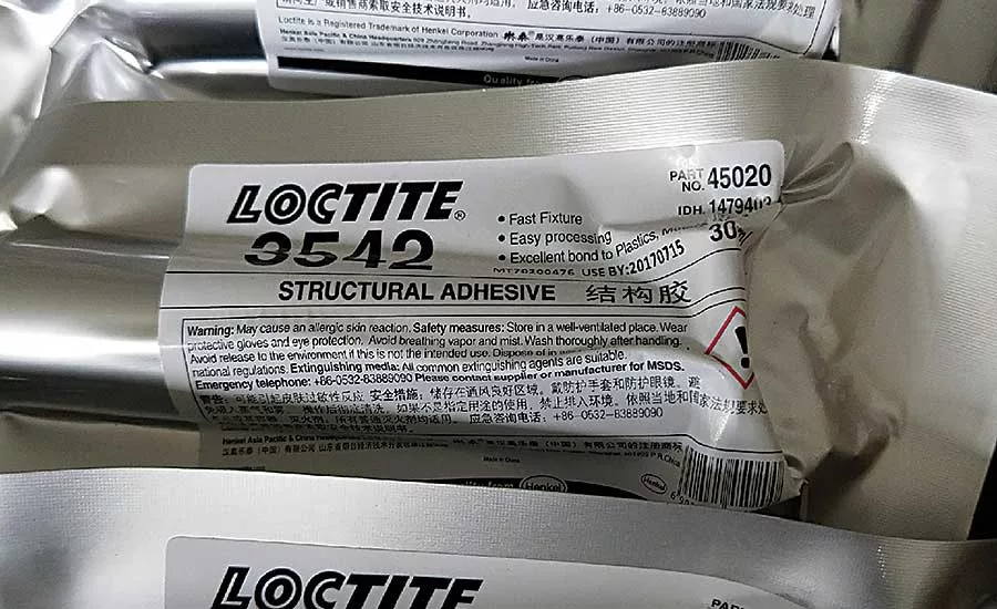

Henkel Corp. offers a number of PUR hot-melts for electronics assembly. For example, Loctite 3542 is a toughened, one-component PUR hot-melt adhesive with low halogen content for structural bonding of handheld electronic devices. It is well-suited for bonding metal, ink-coated glass and plastics where shock and impact resistance are required. The product is applied warm and cools to provide initial tack. Over time, it reacts with moisture to cross-link to a thermoset polymer with excellent toughness and durability. The fully cured product does not remelt.
The adhesive is applied at a temperature of 90 to 110 C. Formulated for robotic dispensing, the material has a relatively long open time: At 25 C, a 1-millimeter bead will have an open time of four minutes.

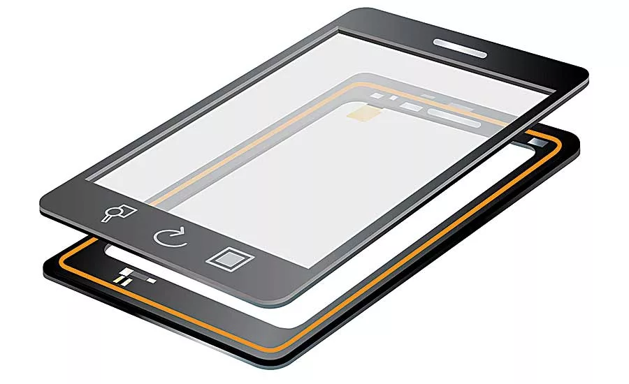

PUR hot-melts are widely used in electronics assembly for applications such as bonding the display into the phone case. In the past, double-sided tapes were used. However, new infinity-edge designs provide less real-estate to which tapes can bond.
“We’re talking widths of 0.4 to 0.5 millimeter. That’s not a lot of room for a double-sided tape,” Dunbar points out. “Even if you were able to get a thin piece of tape in there, it just doesn’t have the necessary bond strength. The assembly will fail the drop test and the thermal cycling test.
“Additionally, electronics manufacturers are trying make their mobile devices more waterproof. Really thin tape doesn’t have a lot of compliance or prevent water ingress. A thicker bead of hot-melt material will provide some gap-fill capability and help to waterproof the assembly.”

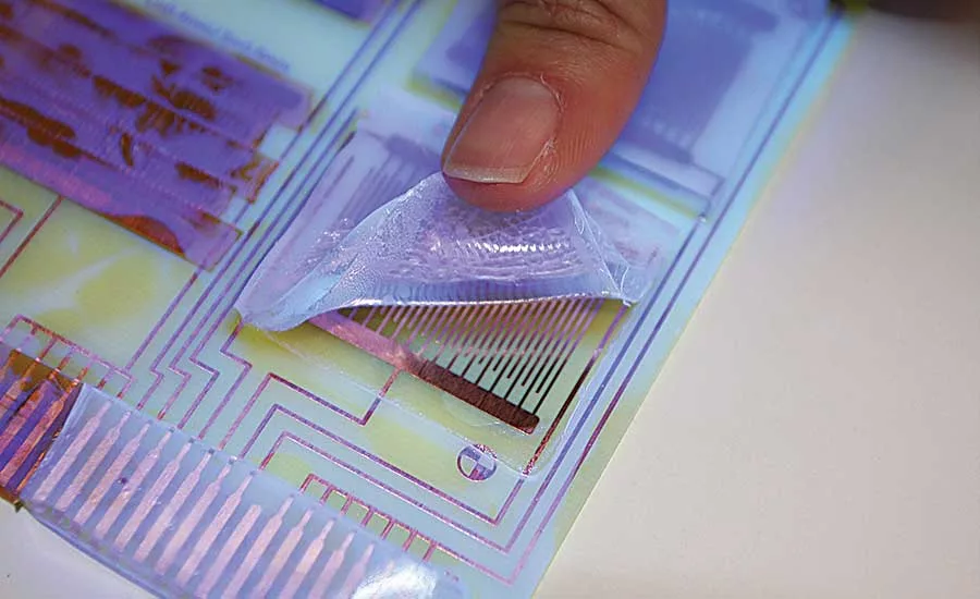

Not all hot-melts are adhesives. Henkel recently introduced a hot-melt masking material, Technomelt AS 8998, to protect electronic components prior to conformal coating or chemical deposition processes.
“Technomelt AS 8998 is compatible with common automated dispensing systems to allow for quick, precise deposition in very small areas, ensuring accurate coverage only where needed with no material migration,” explains Art Ackerman, global product manager for circuit board protection at Henkel. “This is a tremendous improvement over manual taping methods that are labor-intensive with limited accuracy, particularly with miniaturized parts.”
Technomelt AS 8998 is a silicone-free, halogen-free, RoHS-compliant material that has excellent green strength immediately after dispensing and solidifies upon cooling. Compatible with numerous substrates, this slump-resistant hot-melt provides good adhesion during various coating processes. After coating, the material peels off quickly and cleanly, leaving defined edges and no residue.
Technomelt AS 8998 is compatible with thermal processes up to 100 C,
which aligns with most coating applications. Subsequent formulations with higher temperature resistance are in development.

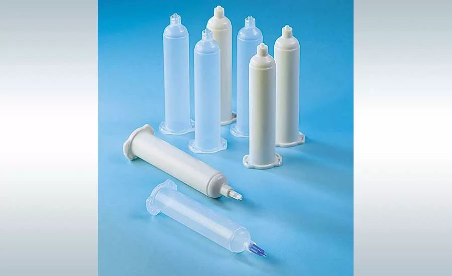

Hot-melt adhesives are typically supplied in 30-milliliter syringes, although 300-milliliter syringes are also available. Syringes can be made of heat-resistant plastic or aluminum. The former have the advantage of being disposable, but the latter can take more heat.
Nordson EFD recently introduced Unity HiTemp plastic syringe barrels. These disposable 30-cc barrels are available in two models. The standard HiTemp syringe barrel withstands 125 C for eight hours at up to 87 psi. The Extreme HiTemp syringe barrel withstands 180 C for eight hours at up to 100 psi. Standard HiTemp barrels can be used with all hot-melt adhesives, including PURs and silyl-modified polymers. Extreme HiTemp barrels can be used with polyamides and other hot-melts. They also block ultraviolet light at wavelengths between 200 and 500 nanometers.

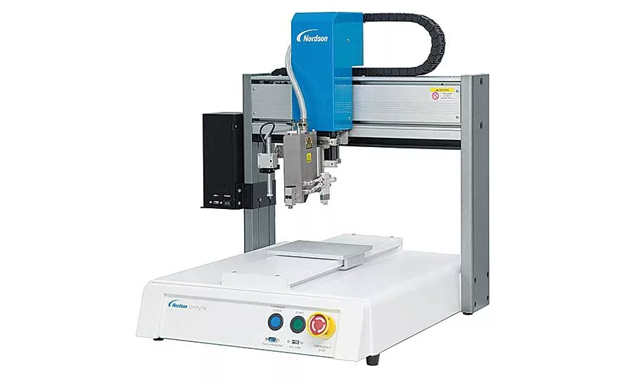

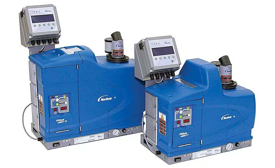

Three components are needed to dispense hot-melt adhesives: a melter, a valve, and, because of the precision and volume requirements for electronics assembly, a Cartesian robot.
The melter heats the adhesive to a temperature of 110 to 190 C, depending on the chemistry. PURs are at the lower end of the temperature range; polyolefins are at the higher end. Hot-melt silicones are somewhere in the middle.
“It’s really important to maintain a consistent temperature,” advises Dunbar. “You want to control the temperature to ±1 to 2 degrees. Nordson equipment can do that because it has sufficient thermal mass wrapped around the adhesive. You don’t want to constantly raise and lower the temperature, because that can reduce the life of the material. You also don’t want to
overheat these materials, which can lead to charring.”
Hot-melts can be applied with a traditional contact dispensing process or with a jetting valve. Either way, the equipment should be designed specifically for dispensing hot-melts. “You don’t want to simply add a heater to a standard dispensing system,” urges Dunbar.
Dispensing nozzles should be made of brass or copper to conduct heat. “Some applications may require a nozzle preheater,” adds Dunbar. “If the nozzle is long, it can act like a heat sink, so we’ll program the robot to park the nozzle in preheater—think of it like a heated garage—to heat up the nozzle prior to dispensing. Once the material starts flowing through the nozzle, it heats up pretty good, but if it’s just sitting parked, the nozzle can become cool.”
Another concern with hot-melts: They can string. To get around that problem, Nordson has integrated special motion routines into its robot programming software. At the end of a bead, the robot can be set to automatically track the nozzle forward or backward over the dispense path so when the string snaps, it simply falls back onto the existing bead.
