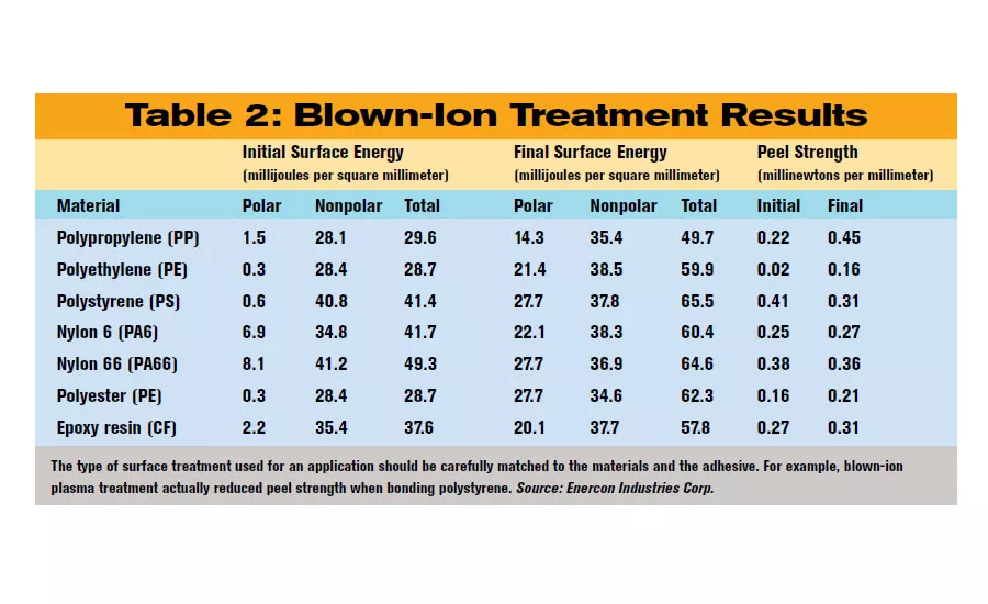

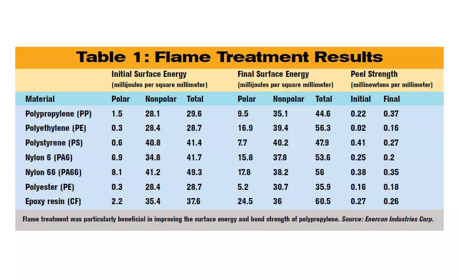

Blown-ion plasma and flame treatment increased the surface energy in all tested materials, with the majority of the increase in the polar component. Treatment improved the peel strength of all materials, with the noted exception of polystyrene.
The results of flame treatment are shown in Table 1. The results of blown-ion treatment are shown in Table 2. On average, blown-ion treatment increased the polar component of the surface energy 120 percent more than flame treatment, with the exception of epoxy resin, which dropped by 20 percent.
Blown-ion plasma can use other gases than compressed air. Further testing was done with CO2 and nitrogen. Peel testing showed little difference between compressed air, CO2 and nitrogen, with the exception of using CO2 to treat nylon 66, which saw a slight increase in peel strength.
Our tests showed no correlation between peel strength and total surface energy. However, test results indicated a very strong positive correlation (0.82) between the change in nonpolar surface energy and an increase in peel strength. This should not be interpreted as showing that nonpolar surface energy is the only factor to consider when bonding. Rather, it shows the limitations of the peel test, and that the tape used in the test has a mostly nonpolar component. An adhesive with a higher polar component would most likely have stronger effects from the plasma treatment.

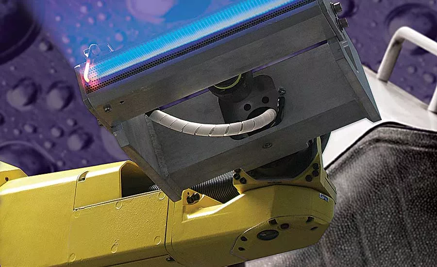

Blown-ion and flame treatment equipment can be integrated in a fixed position with parts moving past them. Alternatively, for composite applications that involve large or complex shapes, the part can remain stationary and the plasma treatment head can move. The treatment head is relatively small and connects to a control cabinet via a flexible cable. This makes it well-suited for pairing with a robot. Any machine, from a two-axis benchtop robot to a six-axis articulated arm, can be equipped with a treatment head.
Blown-ion plasma is ideal for shallow glue channels and spot treatments. This technology can increase the surface energy of materials at a wide range of line speeds and is often done simultaneously with adhesive dispensing. Parts can be treated and glued in the same in-line process, which saves time.

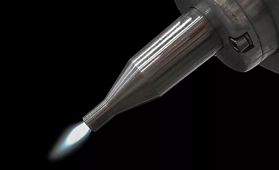

Flame treatment can also be accomplished at a wide range of line speeds. Processing width is virtually unlimited, so the treatment can be used on small, intricate parts with complex shapes as well as large automotive components, like frames and cosmetic panels.
An additional benefit of flame treatment is the ability to treat materials at a wide range of distances. Depending on the application, components can be located 1 to 6 inches away from the treatment head. This minimizes the need to create long, slow robotic paths to ensure treatment of complex shapes and curvature, reducing cycle time.
