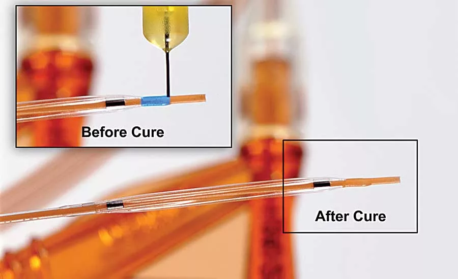

Nylon is well-suited for use as a balloon material because of its ability to withstand high pressures in thin-walled sections. Photo courtesy Dymax Corp.

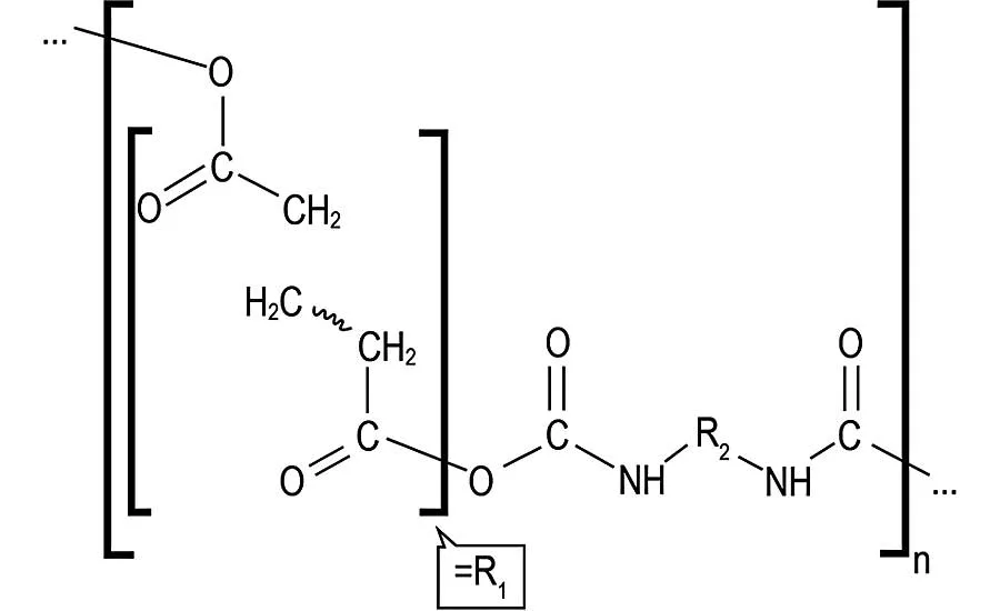

Plastics such as polycarbonate feature carbonyl groups, or carbon atoms double-bonded to oxygen atoms. These plastics are considered easy to bond. Illustration courtesy Dymax Corp.

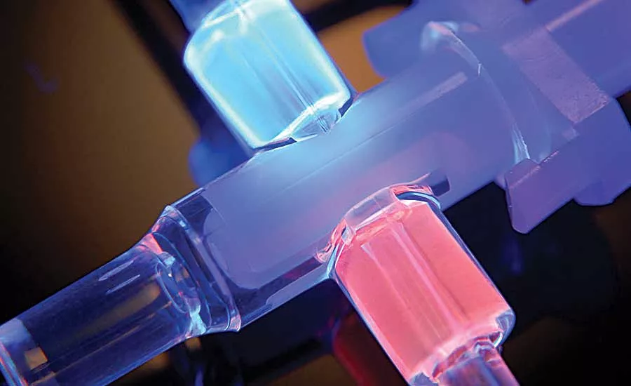

Adhesives can be formulated with fluorescent dyes that remain colorless until they are exposed to black light, at which point they fluoresce red or blue. Photo courtesy Dymax Corp.

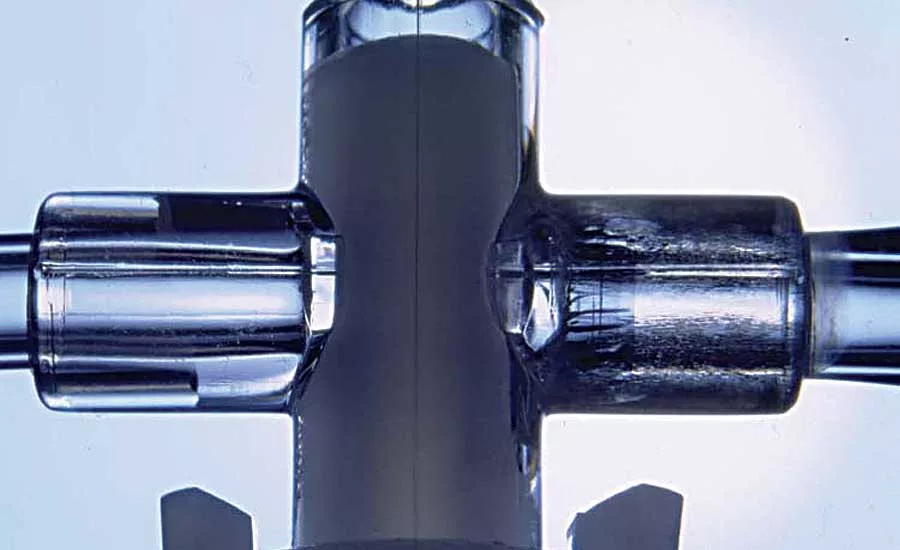

Manufacturers using light-cure adhesives should know that substrate opacity may vary depending upon the color of the plastic. Photo courtesy Dymax Corp.

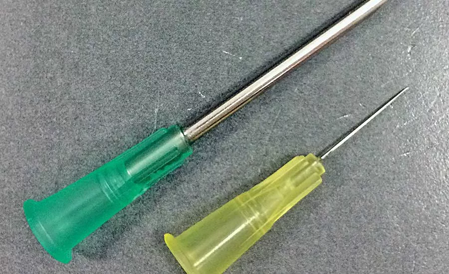

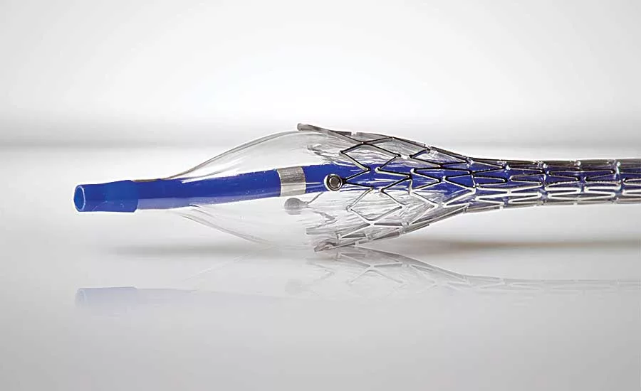

For medical devices such as catheters, syringes, vials, test tubes and injector pens, many manufacturers are turning to plastics that are formulated to resist harsh chemical and environmental conditions. Growing in popularity are thermoplastic materials, including nylon and nylon derivatives like polyether block amides (PEBAs), as well as cyclic olefin polymers (COP) and copolymers (COC). These materials soften and become pliable on exposure to heat, hardening when cooled to room temperature. They are valued in medical device manufacturing for their strength, their superior mechanical and dynamic properties, and their ability to withstand sterilization and chemicals. They can often replace glass.
Nylons are semicrystalline polyamide materials that are very tough, offering good thermal, chemical and pressure resistance. These materials deliver the flexibility, tensile strength and compression resistance needed to meet the requirements of devices used for fluid management, surgical procedures and diagnostics. Each type of nylon provides individualized performance characteristics. For example, as the nylon’s associated number increases, specific gravity, melting point and moisture content decrease (nylon 12 has a lower specific gravity than nylon 6).
Extruded tubing made of nylon is lightweight, corrosion and abrasion resistant, and will withstand repeated stress over long periods, making it a popular material for catheter shafts. Nylon is also well-suited for use as a balloon material because of its ability to withstand high pressures in thin-walled sections. Nylon extrusion works well in balloon applications that require more compliance than PET balloons can provide.
Relatively new to the medical device scene, PEBA is also gaining in popularity. It delivers low friction properties, kink and pressure resistance, softness and flexibility in a chemically resistant, lightweight material. PEBA is a thermoplastic elastomer obtained by polycondensation of a carboxylic acid polyamide with an alcohol termination polyether. Manufacturers are starting to use it in place of common elastomers like polyurethanes, polyesters and silicones because of its lower density, excellent chemical resistance, superior flexibility, and exceptional impact and fatigue resistance. PEBA is gaining popularity for medical films and tubing applications, including catheters and connectors.

Adhesives want to bond onto reactive groups. Plastics such as polycarbonate and polyetherimide feature carbonyl groups, or carbon atoms double-bonded to oxygen atoms. These plastics are considered easy to bond and are very popular due to the high electron density in the oxygen, which often crosslinks through the double-bond site.

A number of adhesives can be used to assemble catheters, syringes and other medical devices to deliver high-strength bonding, sealing, gap filling and easy in-line processing. For low-volume, manual assembly operations, two-part epoxy and cyanoacrylate adhesives will permanently secure components. However, epoxies require hours to set and cure with high levels of work in process. Cyanoacrylates offer virtually no time to reposition parts and tend to experience “blooming,” the formation of a hazy white discoloration on nearby surfaces that can negatively impact aesthetics.
For high-volume, high-speed automated production, UV- and visible light-curable adhesives fully cure in seconds to thermoset polymers that form lasting bonds to a variety of plastics, including difficult-to-bond plastics. These one-part adhesives eliminate work in process by curing rapidly on exposure to the right intensity and wavelength of light. They can be formulated with fluorescing properties to allow for easy bond-line inspections to detect adhesive coverage and volume. Some adhesives offer color-change technology that allows manufacturers to confirm cure.

Light-curable adhesive formulations will accommodate many bond gap thicknesses and have very low risk of blooming or stress cracking. These single-component adhesives are stored at room temperature, have long shelf life, and no pot life. According to industry research, the majority of light-curable adhesives maintain at least 85 percent of their strength after four weeks aging at 60 C.
Substrate color can affect adhesive performance. For example, color can be used to denote cannula size in needle bonding. Manufacturers using light-cure adhesives should know that substrate opacity may vary depending upon the color of the plastic, and should look for colored plastics that are translucent to allow light to penetrate. Certain specialty adhesives are available that are more compatible with colored or less translucent substrates.

Many light-curable adhesive technologies are formulated to confirm adhesive placement, which can be observed either with the human eye or by vision systems. Some formulations offer color-change technology, in which the adhesive changes from a bright color (e.g. blue) in its uncured state to a lack of color in its cured state. The colored adhesive can easily be viewed to confirm that the correct volume of adhesive has filled gaps after dispensing occurs. By transitioning from blue to colorless, the adhesive allows manufacturers to confirm that cure is complete and the bond has been achieved.
Certain adhesives are formulated with fluorescent dyes that remain colorless until they are exposed to a 365 nanometer black light, at which point they fluoresce red or blue. Adhesives that fluoresce red are particularly effective for use with plastics, such as PVC and PET, that naturally fluoresce blue, allowing easy inspection of bond lines.
