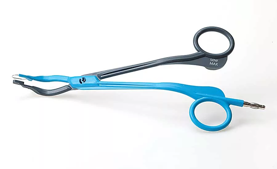

This single-use electrocautery instrument for tonsil surgeries is made from Ixef GS-1022 polyarylamide resin. Because of its moldability and high flexural strength, engineers were able to optimize the instrument’s ergonomics, precision and surgical efficacy without compromising the rigidity of key components. Photo courtesy Solvay Specialty Polymers
