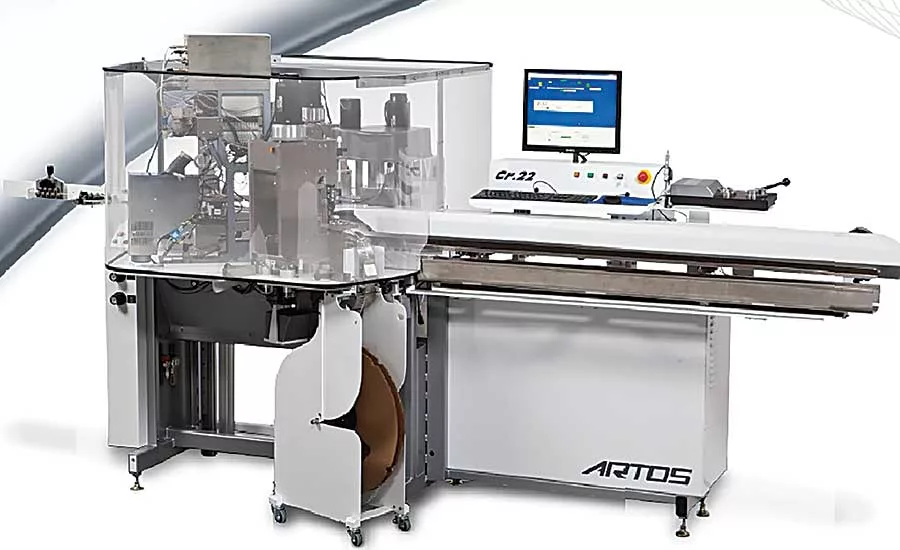

The Artos Cr.22 fully automated machine offers up to four processing stations for crimping, weather seal application, wire end twisting and wire tinning. This unit quickly and accurately crimps 30 to 10 AWG wire in open- and closed-barrel terminals. Its TU-15 terminating unit features programmable stroke and split cycle operation. Easy-to-use intelligent software optimizes speed by automatically coordinating the crimping.

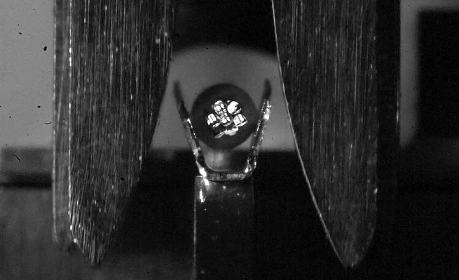

“It’s difficult to align the terminal and anvil because they’re both so small, but it is necessary to prevent asymmetry,” explains Houser. “Users must follow an alignment procedure for the crimper and anvil. One method is to place a piece of once-folded interleaving paper between the crimper and anvil when the applicator is out of the terminator. Press down on the ram firmly, but not excessively, and tighten the crimper mounting screw to preserve the alignment.”

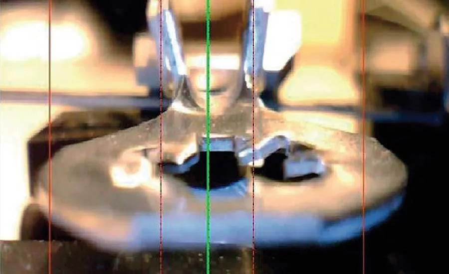

TE Connectivity’s OCEAN applicator series features the EYE Check vision system (camera and software) that helps eliminate terminal feeding and alignment errors. By magnifying the crimp area, the camera keeps the terminal centerline aligned to the anvil during feeding.
These applicators are available with a pneumatic feeder for crimping wire as small as 36 AWG. The pneumatic feeder offers precise and repeatable terminal positioning over the anvil. All models allow wire crimp height to 1.5 millimeters, in increments of 0.01 millimeter.
The condition of the crimper is also important. A worn crimper, for example, may not be able to equally deform both sides of a terminal during crimping. This imbalance is likely to produce an asymmetrical crimp. Other causes of asymmetry include improperly positioned or orientated terminals, incorrect terminals mixed in the supply reservoir, crimping too tightly or loosely, and protruding conductor strands.
The main effect of asymmetry is flash, which is material that protrudes down the sides of the terminal and along the anvil. Although some flash is normal in the crimping process, excessive flash is undesirable. Too much flash can prevent proper wire insertion in the terminal, cut sealing material on the crimp, or break off and negatively impact wire performance.

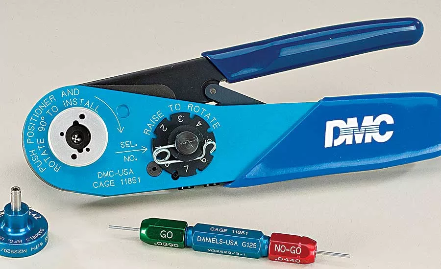

In the latter situation, an advanced manual tool—like DMC’s Bias (MH993) crimp tool—is quite effective. The tool performs 4/8 indent crimping on small wire (up to 36 AWG) in different types of contacts, including seamed open barrels made of sheet metal. It places four indents on the barrel (one every 90 degrees) to prevent distortion and produce a symmetrical crimp. Because each indenter has two points, the crimp is x-shaped with a square center consisting of the conductor strands.

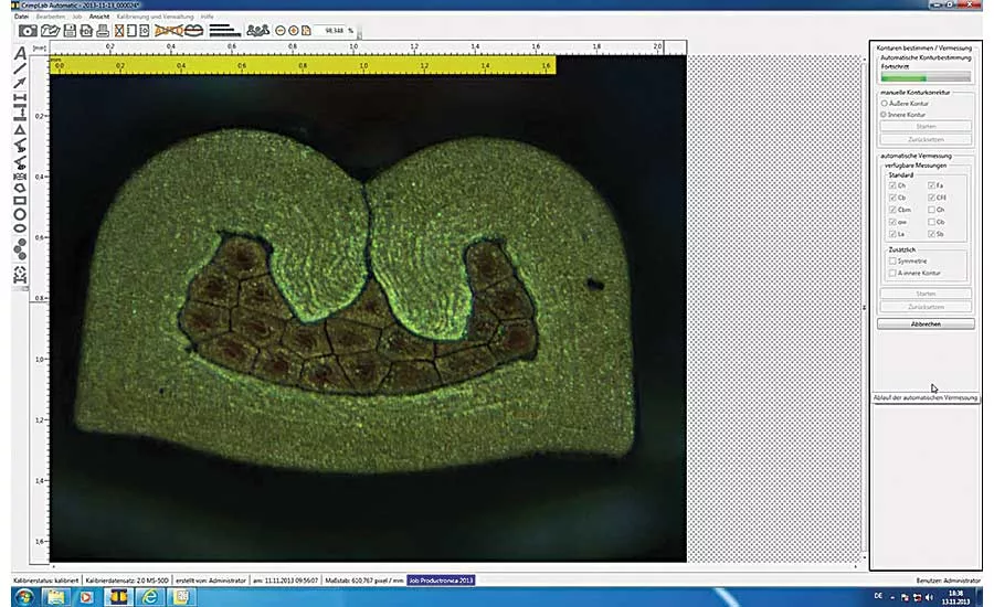

Micrographs are also useful for assessing the quality of crimps on small wire. A micrograph is a photo of a crimped terminal cross-section taken by a microscope. Schleuniger’s MicroGraph System quickly creates these images of standard (cross and longitudinal) and indent crimps. The modular system uses sawing, polishing and electrolyte staining (cleaning) processes with high-precision optics to visually analyze crimped connections. It comes with an ergonomic work table to optimize workflow, and it can be integrated into mobile carts.
