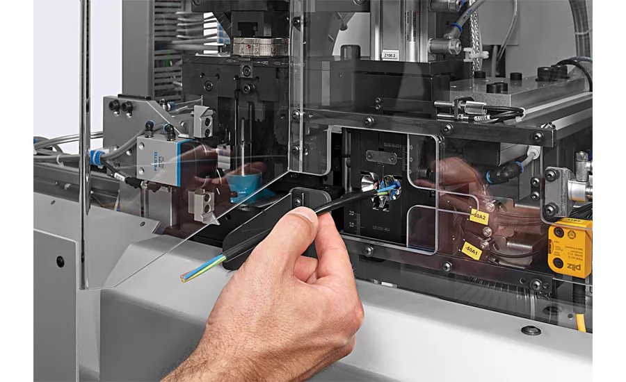

Surprisingly, introducing the wrong materials into the production stream is a common cause of defects and rework. Is your system set up to eliminate the possibility of employee error? Photo courtesy Schäfer Group

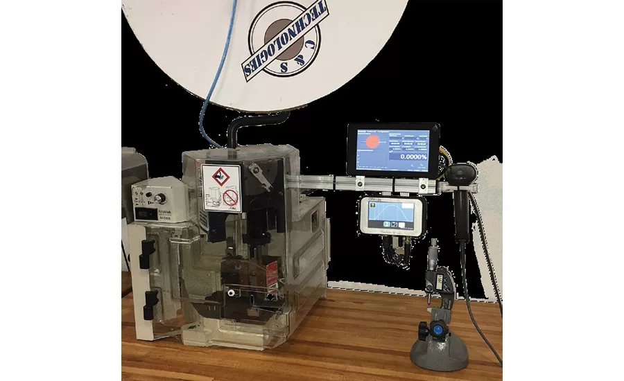

Crimp force monitoring, crimp height measurement and pull force testing are the primary tools in a harness assembler’s quality assurance program. Photo courtesy C&S Technologies

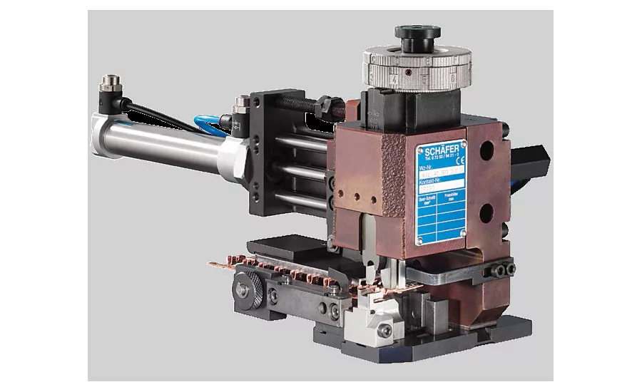

Applicator setup is critical for producing quality crimps. Has the applicator been prepared for production? Was it inspected after the last production run? Photo courtesy Schäfer Group

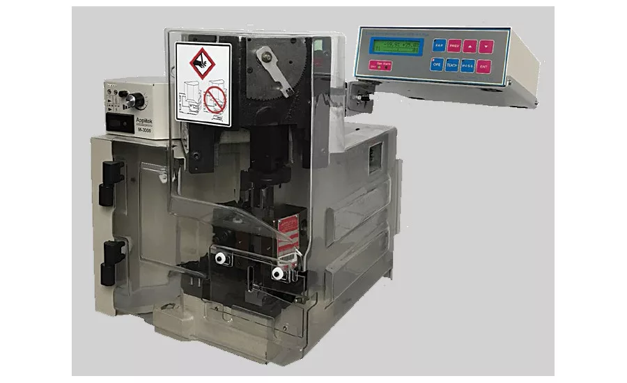

By itself, a crimpforce monitor will not solve your crimping problems nor will it guarantee nonconforming crimps. Photo courtesy Applitek

Material verification. Surprisingly, introducing the wrong materials into the production stream is a common cause of defects and rework. Hopefully, such a mistake is caught before the finished product leaves your facility. It’s a major issue if it’s caught by the customer. Is your system set up to eliminate the possibility of employee error when picking materials for production?
Applicator setup. Has the applicator been prepared for production? Was the applicator inspected after the last production run? Is the tooling capable of producing crimps that meet quality specifications? Has the applicator been installed correctly?

Crimp measurements. Are you following the “recipe” for each terminal and wire combination? The recipe, or defined measurements, for crimp validation include wire crimp height, crimp width, pull force and visual factors. Pull force data alone is not enough to verify crimp quality. A crimp that passes the pull force test can still have unacceptably high electrical resistance. Crimp height is the primary method terminal suppliers specify to measure crimp quality.

By itself, a crimp-force monitor (CFM) will not solve your crimping problems nor will it guarantee nonconforming crimps. It can only go by the tolerance thresholds you input. Set the tolerances too wide, and you’ll run the risk of producing nonconforming crimps. Set them too narrow, and you could scrap otherwise good parts.
Several factors can affect a CFM’s ability to keep an eye on your crimping process. The terminal-to-wire match is one factor; head room can influence the sensitivity of a CFM. Equipment condition is another.
To determine if the thresholds for crimp defect detection are acceptable, test the CFM with sample errors, such as missing strands. If it can’t detect a known error, you know you have work to do.
It’s also a good idea to take visual and physical measurements. Take a batch of processed wires and fan them out. Check wire position in the crimp to ensure insulation is not in the wire crimp, the bell mouth and brush positions are correct. Measure wire crimp height and pull force and confirm they meet the manufacturer’s specs.
