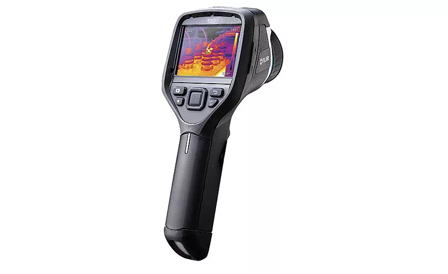

Thermal imaging systems can be used as handheld instruments, or they can be mounted in a fixed location for inspecting parts or assemblies on a conveyor, just like machine vision systems. “For example, on a food manufacturing line, a thermal imaging camera can be set up to ensure that product leaving an oven has reached a certain temperature,” says Sandhu. “You can set upper and lower thresholds for the temperature and have the camera trigger an alarm if an item falls outside those limits.”
Thermal imaging systems do not necessarily have to be close to a part or assembly to get an image. “Infrared radiation behaves just like visible light, so it’s not so much the distance, it’s the optics,” explains Sandhu. “The type of lens you use and how far away you are will dictate what kind of image you will get.”

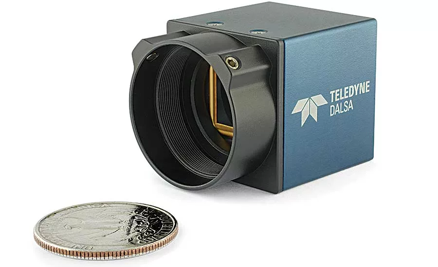

For example, Teledyne DALSA recently introduced the Calibir GX series of long-wave infrared cameras for industrial vision applications. Built to achieve rates of up to 90 frames per second, the shutterless camera is ideal for inspecting parts, packaging and electronics assemblies.
Measuring just 29 by 29 by 29 millimeters, the camera has a standard GigE interface and is available with resolutions of 320 by 240 pixels or 640 by 480 pixels. With radiometric functionality, the camera can accurately measure temperatures between -25 and 125 C. The microbolometer-based platform covers wavelengths from 8 to 14 microns.
The camera requires no mechanical shutter for calibration, meaning almost instant image output after startup. The image output of the camera remains stable across time and temperature range, so there are no interruptions for recalibration. For additional protection and flexibility, the camera is also available with an optional integrated mechanical shutter.
The camera supports a variety of lenses, ranging from 7.5 to 100 millimeter focal lengths. The camera is supplied with the lens of choice and is fully calibrated over an operational range of -40 to 60 C.
Advanced image processing algorithms adapt to the image content, optimizing contrast to show the finest details regardless of conditions or intra-scene variations. No manual intervention is required.

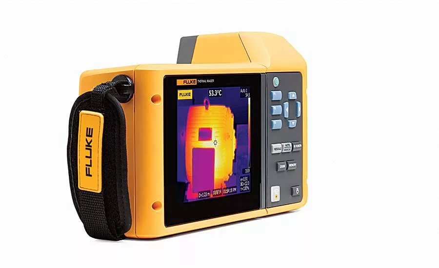

The TiX560 infrared camera from Fluke has a 5.7-inch touchscreen and a lens that can rotate 240 degrees, enabling engineers to navigate over, under and around objects to preview and capture images. The camera is ideal for predictive maintenance and other applications where flexibility and higher resolution are essential.
The camera includes Fluke’s “MultiSharp Focus” technology, which enables the device to take multiple images rapidly and combine them into one fully focused image. The advanced focusing system enables users to capture an automated, focused image of multiple targets at once.
The camera is also compatible with the company’s Fluke Connect cloud-based software, which can collect measurements wirelessly from more than 40 instruments. This allows technicians to record and share both thermal images and electrical measurements in real time via their smartphones or tablets and automatically upload them to the cloud. Reports can be created and shared right from the job site via email. Technicians can collaborate in real time with colleagues with “ShareLive” video calls.

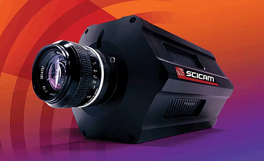

Princeton Infrared Technologies Inc. recently introduced the 1280SciCam, a high-resolution camera (1,280 by 1,024 pixels) that operates in the short-wave infrared and visible spectra, from 0.4 to 1.7 microns. It delivers a full-frame rate of more than 95 frames per second. The camera features a 12-micron pitch, low-read noise, and 14-bit analog-to-digital converter, making it ideal for machine vision applications where sensitivity and high resolution in the short-wave infrared band is critical. Three temperature set points are possible: 25, 0 or -50 C.

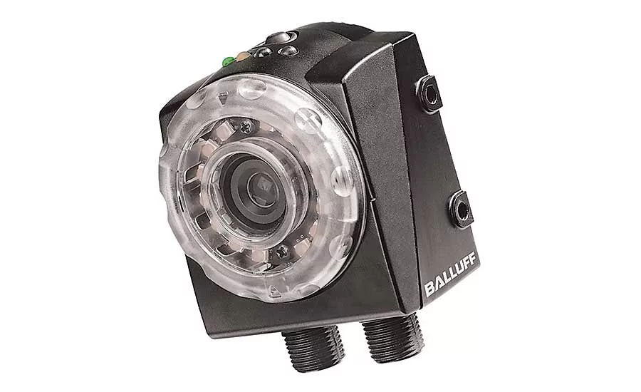

The BVS vision sensor from Balluff Inc. eliminates both problems. The sensor has a built-in infrared light source and an integrated daylight filter, so visible ambient light cannot affect image quality or the stability of the inspection process. In addition, the sensor’s infrared light is invisible to the human eye. There is no intrusive flickering to the operator, which can obviate the need for shielding and reduce the temptation to tamper with application lighting
