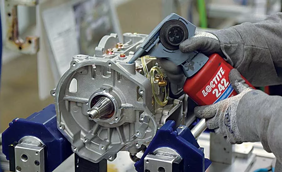

A thread-locking adhesive can often eliminate the need for costly nylon insert nuts. Photo courtesy Henkel Corp.

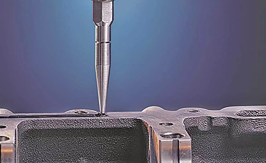

Form-in-place gasketing materials can obviate the need to keep cut or molded gaskets in inventory. Better still, the process of applying the material can be automated. Photo courtesy Henkel Corp.

A teardown analysis of a gas-powered lawn trimmer discovered that cut fiber gaskets were located between the head and the motor block and between the motor block and the crankcase. Replacing the cut gaskets with liquid gasketing adhesives would reduce inventory and labor costs. Photo courtesy Henkel Corp.
The team then looked at the trimmer shaft, which was held together using threaded fasteners. The team recommended replacing nylon insert nuts that cost about $0.10 each with a threadlocking adhesive that costs $0.03 for one application. The adhesive will eliminate vibrational loosening issues. In addition, assembly can be automated, and fewer parts must be inventoried. This change will more effectively eliminate fastener failure.

In the motor assembly, cut fiber gaskets are located between the head and the motor block and between the motor block and the crankcase. These could be replaced with liquid gasketing adhesives. This substitution allows for automated gasket application, reduces parts being inventoried, and eliminates labor costs.
