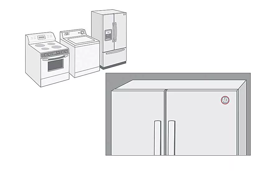

Acrylic foam bonding tapes can be used to bond brand badges and decorative trim to appliances. Photo courtesy Avery Dennison Performance Tapes

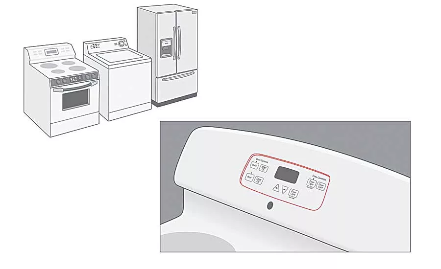

Flock tapes or high-performance acrylic tapes enable assemblers to securely attach digital control panels to appliances. Photo courtesy Avery Dennison Performance Tapes

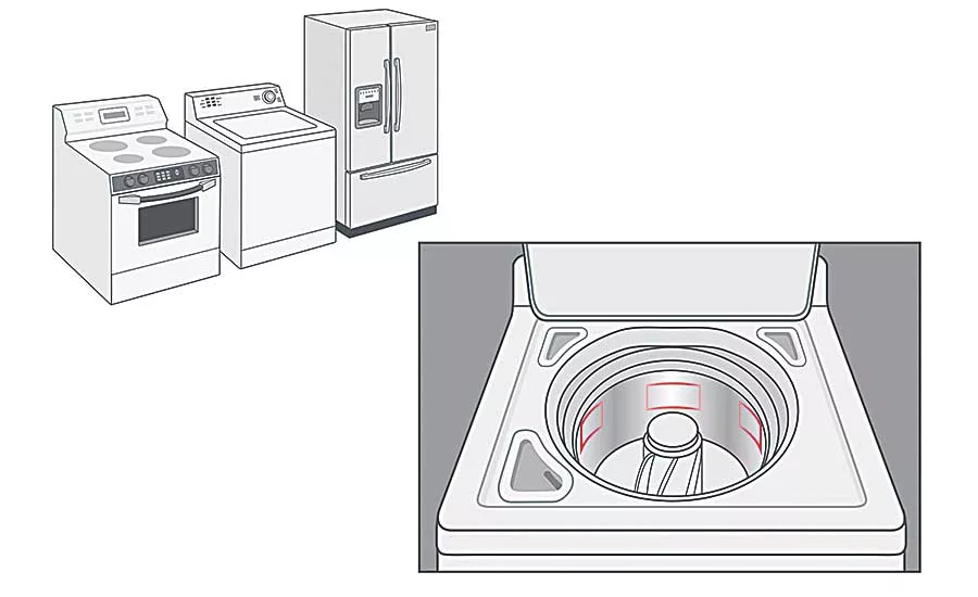

Aluminum-foil based acrylic tapes can reduce noise, vibration and stress fatigue by damping vibrations. Photo courtesy Avery Dennison Performance Tapes

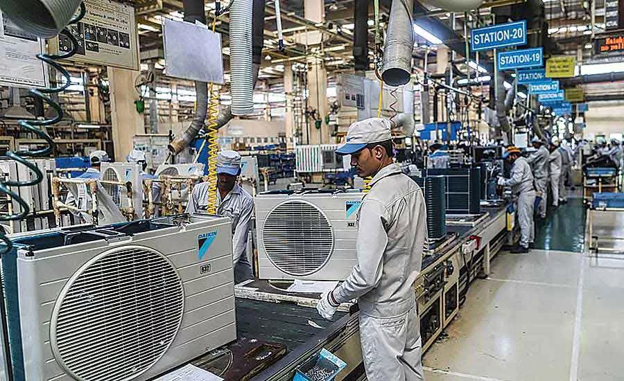

PSAs bond best to materials with high surface energy, such as ABS and polycarbonate. Low surface energy materials, such as polyethylene and polypropylene, can be hard to bond. Photo courtesy Daikin Industries Ltd.

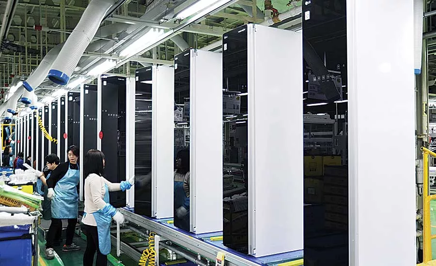

Acrylic foam bonding tapes can provide shock dissipation for appliance doors, which are constantly opening and closing. Photo courtesy LG Electronics Inc.

Surface energy—a measurement of a surface that indicates how something will bond to it—affects an adhesive’s ability to bond to that substrate. Using the wrong PSA tape on the wrong surface will cause it to slide right off.
High surface energy (HSE) materials include most metals. But, painted or powder-coated metals—basic appliance components—are low surface energy (LSE) materials. Plastics such as acrylonitrile butadiene styrene and polycarbonate are HSE materials. Plastics such as polyethylene and polypropylene are LSE materials. These are more challenging to bond with PSAs.
Generally, the more textured a substrate, the more difficult it is to bond. An adhesive that is too thin or has low flow won’t bond to enough surface area. This type of substrate requires a tackier adhesive with a higher coat weight, providing more flow. Rubber- or acrylic-based adhesives modified with tackifiers bond well to LSE appliance surfaces.

Aesthetic applications. Since brand consistency and presentation are key to a product’s branding, nearly every appliance carries a brand badge or emblem, and many have decorative trim or bumper rails for product protection. Durable acrylic foam bonding (AFB) tapes are an affordable option for these applications, providing excellent tack, adhesion and cohesion performance. These also add shock dissipation for appliances where doors are constantly opening and slamming shut, allowing the component to withstand such shocks over the life of the appliance. AFB tapes are also excellent choices for joining metal frames to glass cooktops, providing reliable adhesion while adding thickness to absorb the shocks that may be created by pots and pans being placed on the surface.
Critical joining applications. During refrigerator and freezer assembly, it’s critical to prevent movement of components while foam insulation is pumped into wall and door cavities. For this application, high-performance acrylic (HPA) tape provides long-term adhesion with high temperature performance and excellent environmental resistance. It offers high holding power and reliable performance on high-, medium- and low-energy substrates, including a variety of engineered plastics. Foil-based tapes are also an excellent option for attaching refrigerator coils, helping to prevent the coil from moving over the product’s life span.
Noise and vibration damping. Appliance assemblers are increasingly using thin-gauge sheet metal in washers, dryers and dishwashers to cut costs and save weight. These thin materials can increase noise and vibration and decrease the product’s working life due to metal fatigue over time. Aluminum-foil based acrylic tapes can reduce noise, vibration and stress fatigue by damping vibrations. They also provide excellent resistance to heat and humidity. This type of application typically requires a PSA that is customized to meet the specific damping, heat and humidity requirements of the application. There’s no one-size-fits-all product.
Control panels. Depending on the application, flock tapes or HPA tapes allow assemblers to securely attach digital control panels to appliances, providing a tight seal that protects against varying temperature and humidity. To provide the proper PSA, a full understanding of the substrates being joined is key.
