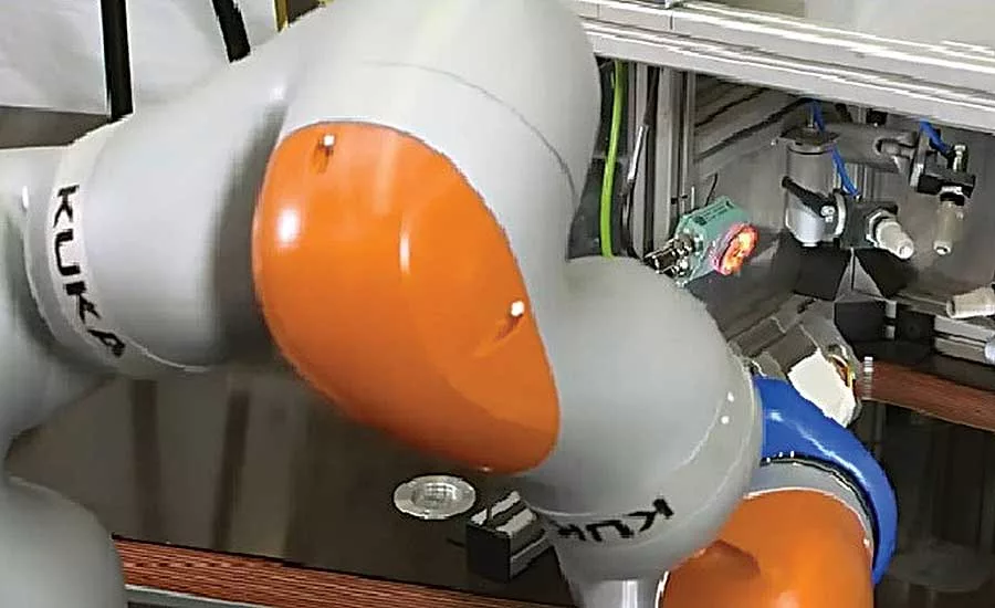

The LBR iiwa robot’s first task is to insert its tooling into a stator, lift it out of a workpiece carrier, and place it on a small trolley. Photo courtesy KUKA Robotics Corp.

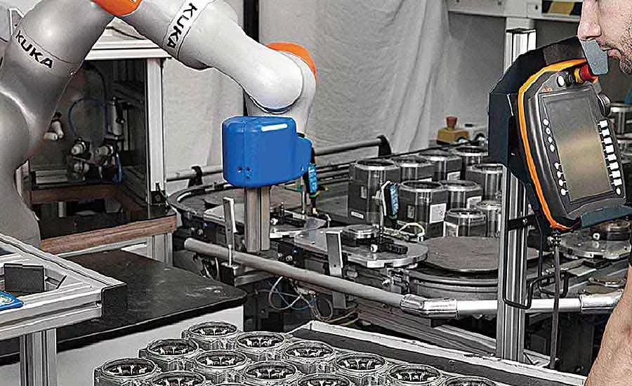

Each machined part is moved past a bar code scanner and three grouped air valves to clear the part of metal shavings. Photo courtesy KUKA Robotics Corp.

The robot’s first task is to carefully insert its end-of-arm tooling into a stator, lift it out of a workpiece carrier and place it on a small trolley that brings it to a lathe for machining. After this, the robot internally grips the machined part and moves it past a bar code scanner and three grouped air valves to clear the part of metal shavings. The robot then places the part inside a Renishaw Equator 300 measuring machine and closes the machine’s door.
At this point, the Equator 300 moves a thin probe along the top circumference of the part to check for edge deviations. Stators that pass inspection are robotically placed in a plastic box for delivery. Those with deviations are moved into the human-robot collaboration (HRC) buffer zone, where the worker and robot safely interact to remove or change some components of the stator before recalibrating and measuring it in the Equator machine.
