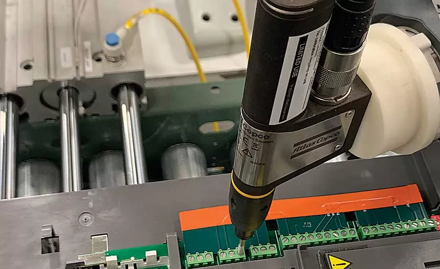

Equipped an intelligent screwdriver, a YuMi cobot loosens 27 screws to release a test plate on a variable frequency drive. A vacuum gripper on the right arm then picks the test plate and places it on a conveyor. PHOTO COURTESY ABB INC.

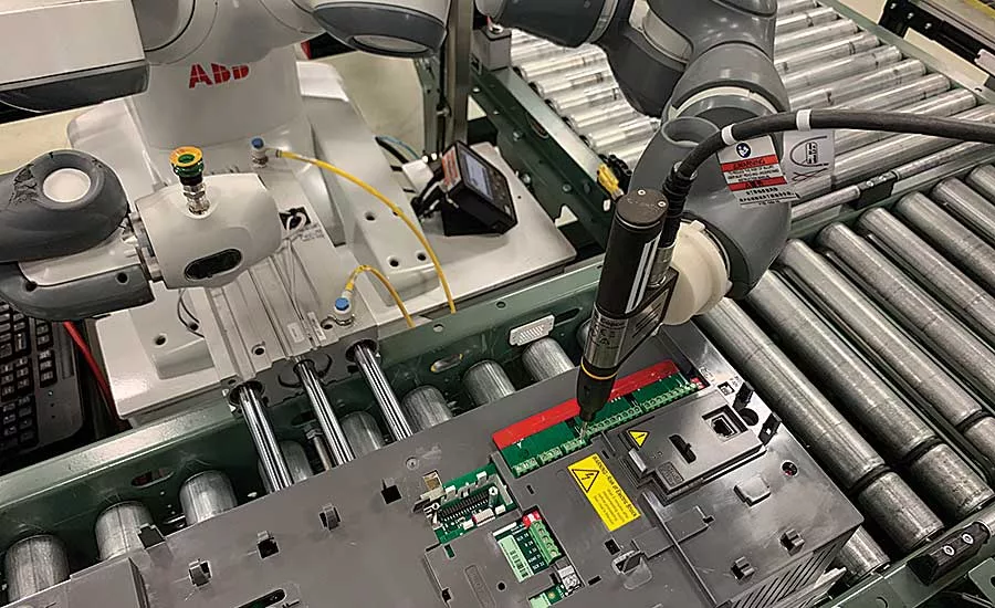

The screwdriver has force and torque sensors to ensure that the robot untightens the screws just enough to unfasten the test board. PHOTO COURTESY ABB INC.

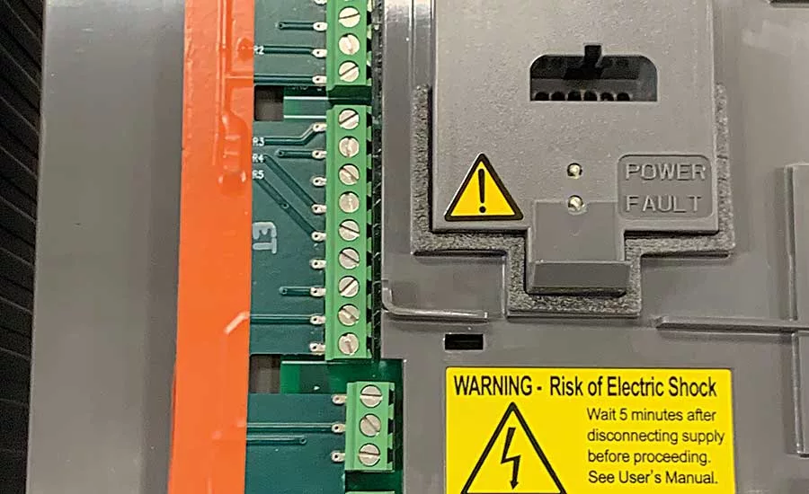

The accuracy created by YuMi’s vison system allows the bit to precisely engage with each screw, eliminating the need for the other arm to hold a guide to steady the screws. PHOTO COURTESY ABB INC.

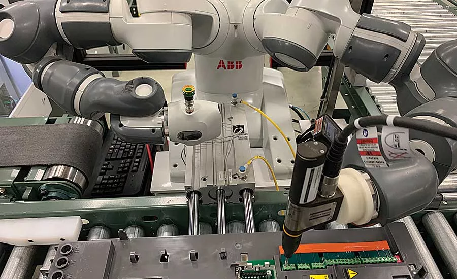

Automating the post-test process has taught ABB’s engineers a lot about design for manufacturability, which will help as they pursue further robotic automation. PHOTO COURTESY ABB INC.

The evaluation of viable robots initially included a small six-axis articulated arm robot, but space constraints and the need for the robot to handle several diverse tasks led IAS to recommend a dual-arm IRB 14000 YuMi collaborative robot.
“The two arms of YuMi attached to a core the size of an average human torso allow it to fit within the workspace previously occupied by the manual operator,” says David Raschke, the IAS project manager. “With a dedicated tool for each arm, YuMi is able to perform multiple tasks independently. The arms also work together to perform complex tasks faster than single arm counterparts. This ability has increased the throughput of the system, while simplifying the programming by eliminating the need for tool changes.”
Additionally, YuMi’s collaborative nature eliminates the need for significant guarding in the high traffic environment of the plant floor. Any issues with the system can be quickly remedied by a worker accessing the robot without passing through any major safety barriers.
YuMi’s collaborative features include a lightweight, rigid magnesium skeleton covered with a floating plastic casing wrapped in soft padding to absorb impacts. If YuMi senses an unexpected impact, such as a collision with a co-worker, it will pause its motion within milliseconds. The motion can be restarted again as easily as pressing play on a remote control.

With the robot establishing the X and Y position of the screws, the left arm, equipped an Atlas-Copco Micro Torque Smart Screwdriver, loosens each of the 27 screws to the degree necessary to release the test plate. A vacuum gripper on the right arm then picks the test plate and places it on a conveyor to be reused on another drive.

Overall quality improvements have resulted in less scrap. The accuracy created by YuMi’s vison system allows the bit to precisely engage with each screw, eliminating the need for the other arm to hold a guide to steady the screws as was originally designed into the system. The smart tool integrated with the YuMi has force and torque sensing that ensures that the robot untightens the screws just enough to unfasten the test board. There were often issues with manual screw gun operators unscrewing too much or too little, damaging the test plate and the screws and causing delays.

Chadek added that the ABB drives production team has learned a lot about design for manufacturability, which will help as it pursues further robotic automation. For example, the grooves of the flathead screws that were initially used in the terminal block were too tight to be crisply engaged by the robotic screwdriver bit. Modifications to the bit itself and the adoption of larger groove screws contributed to the process refinement that eliminated the need to guide the screw bit. This improved the cycle time without the screwdriving arm needing to wait for the other arm to get the screw guide into position.
