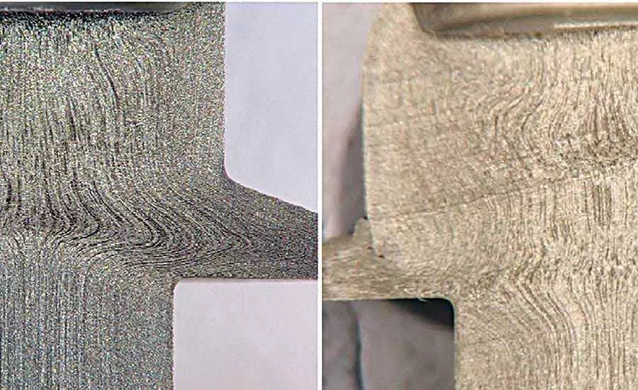

During the head-forming process, it’s important that the grain flow lines of the metal form in the proper direction. The image at left indicates acceptable grain flow that meets the SAE USCAR8 specification. Photos courtesy SAE International

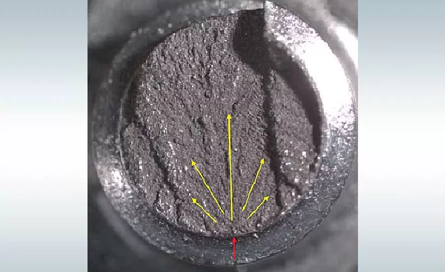

Hydrogen embrittlement is a common cause of fastener failure. The arrows in the photo indicate areas of load stress. Photo courtesy GT Technical Consultants Ltd.

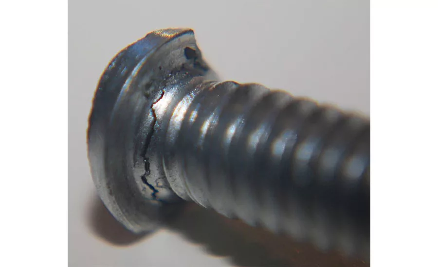

This fastener has an underhead quench crack, although lab engineers initially thought the head failed from hydrogen embrittlement. Photo courtesy GT Technical Consultants Ltd.

Quenching and tempering (or drawing) is one of the most common heat treatment processes for steel fasteners. The fasteners should be tempered within minutes after being removed from the quench and before they are completely cold. Failure to do this may result in quench cracking, premature failure or shorter than normal service life.
During the head-forming process, it’s important that the grain flow lines of the metal form in the proper direction. According to Lafferty, grain lines that sharply move toward the radius of the head-to-shank junction fail to have a good grain flow. This may leave the fastener susceptible to the head breaking off during installation.
“We inspect the fasteners early in the manufacturing process for proper grain flow pattern,” notes Lafferty. “Our inspectors boil the sectioned head of the sample fastener with hydrochloric acid and water for 1 minute to bring out the grain so the grain flow can be easily evaluated. All headed bolts and screws used by our automotive customers, for example, must meet the SAE USCAR8 specification for grain flow pattern.”

Internal hydrogen embrittlement occurs when hydrogen, absorbed during the fastener plating process, gets trapped in the steel and migrates to stress concentrations along grain boundaries. This can cause sudden catastrophic failure under load, according to Kevin Menke, director of engineering at Fastenal Co. and a member of the ASTM F16 fastener standards committee.
