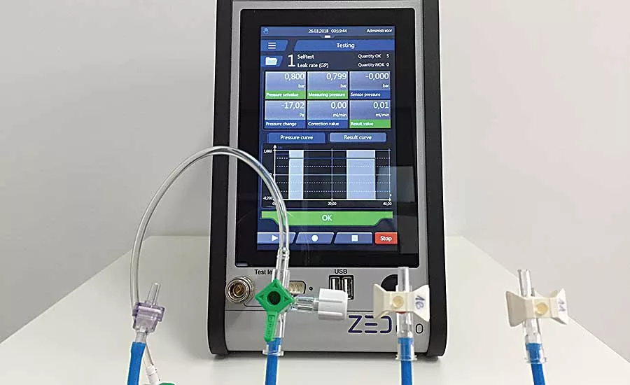

State-of-the-art leak testing equipment features data traceability functions. Photo courtesy Zeltwanger Leak Testing & Automation LP

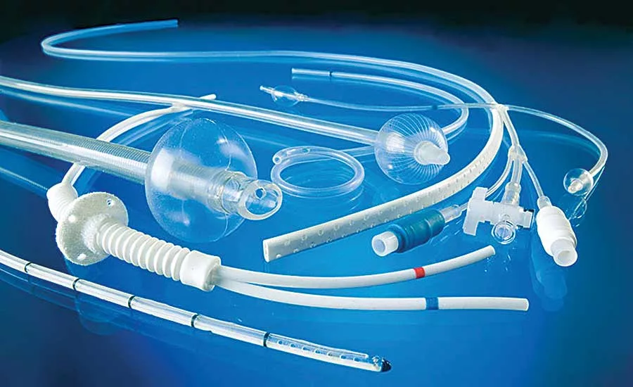

Medical devices can be difficult to check for leaks, because they often incorporate flexible components. Photo courtesy Vesta Inc.

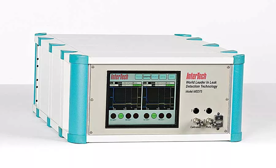

This compact device monitors flow and pressure of medical devices with fast response time. Photo courtesy InterTech Development Co.

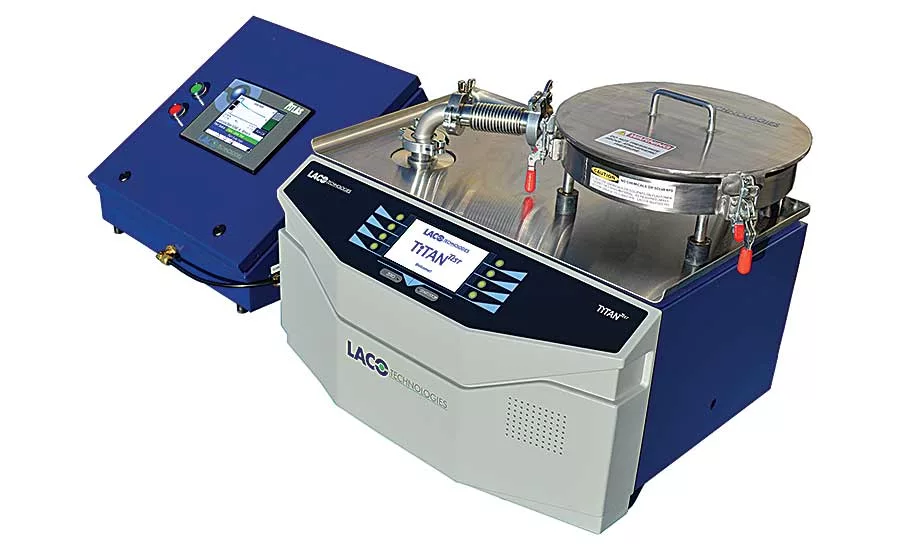

This helium leak detector is flexible and can handle multiple test methods, such as sniffing, chamber testing and helium bombing. Photo courtesy LACO Technologies Inc.

“Any flexible product also presents a challenge with leak testing,” says Burch. “When possible, we always prefer to constrain the device under test while avoiding masking leak paths.”
Flexible components, such as plastic tubing, can create problems because of fluctuations in volume created by the distortion of the material. For instance, with ventilator parts, multiple precise pressures may be required to test each component.
