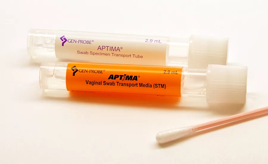

Previously, with our PACE system, clinicians would place swab specimens into capped tubes that were supplied preloaded with fluid transport media. Handling naturally caused the swab and fluid to slosh around inside the tube, often forming bubbles beneath the cap that would pop and release tiny droplets into the air when the cap was removed in the lab. These aerosols were far too small to register on nearby PACE assays, much less have any effect on lab personnel. However, APTIMA is so sensitive it can pick up these tiny aerosol traces and signal a false rRNA detection.
To solve the problem, Hologic developed a new penetrable cap design incorporating a hollow cylinder with a membrane seal across its midplane, another seal across its outer end, and a filter pile packed in between. This cap remains on the tube and allows assay samples to be drawn by inserting a pipette through the seals and filter. The snug fit between seals, filter and pipette prevents any aerosol emission, and the resilience of the filter pile automatically recloses the hole after the pipette is withdrawn. The redesigned cap became part of a broader concept called Direct Tube Sampling (DTS).

The APTIMA cap starts out as an open-ended cylinder molded of natural polypropylene, approximately 5/8 inch in diameter and 11/16 inch long, with a 1/16-inch flange around the inside circumference at mid-length. This flange provides the seat for the internal membrane seal-a disk made of aluminum foil laminated onto a polyester-polyethylene film. The film reinforces the foil's vapor barrier while providing a surface that will bond to the cap's flange through induction welding under pressure. During cap assembly, the inner seal is mounted first, then a strip of filter pile material is coiled and inserted above that seal. After that, a second seal is applied across the cap's upper end to lock the filter in place. Below the lower welded seal, the cap is molded with female threads that screw onto the sample tube.
