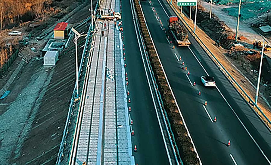

The first section of a solar-powered highway recently opened in Jinan, China. The city of 7 million people is one of the most polluted in the world.
The 3,540-foot-long stretch of road is paved with solar panels that are embedded underneath the surface. Up to 45,000 vehicles a day pass over the road.
According to the builder, Qilu Transportation Development Group Co., the solar panels are capable of generating enough electricity to power highway lights and 800 homes. Engineers also hope they will eventually be able to wirelessly power electric cars driving on the road. They claim the material can withstand all kinds of vehicle traffic, including heavy trucks.
The photovoltaic highway consists of three layers. The uppermost layer is comprised of “transparent concrete” that has a feel similar to asphalt. The middle layer contains the solar panels and the bottom layer consists of a strip of insulation.

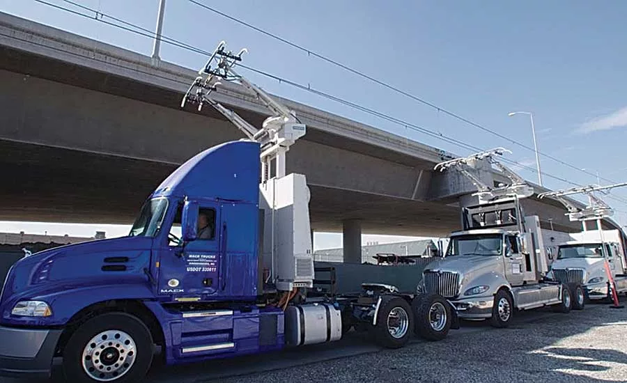

In Carson, CA, another type of electric road is already up and running. The 1-mile-long eHighway features electrified lanes that are supported by an overhead catenary system. It supplies electricity to modified semi-trailer trucks that are equipped with electric motors.
The system operates similar to the way streetcars work. Trucks draw power from the wires via pantographs mounted on the cabs.
The pantograph can connect and disconnect automatically with the contact line via a sensor system while the trucks are moving. This allows them to easily switch lanes or pass other vehicles without being permanently fixed to the overhead catenary system like a streetcar.
To further ensure the same flexibility as conventional trucks, the eHighway vehicles use an electric-hybrid drive system, which can be powered either by diesel, compressed natural gas, battery or other on-board energy source when driving outside of the catenary lines.
The natural-gas hybrid and battery-electric trucks were developed by TransPower, while the diesel hybrid was developed by Mack Trucks.
The eHighway technology was pioneered in Europe by Siemens, which is partnering with the South Coast Air Quality Management District on the Southern California demonstration project.
