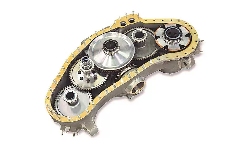

Aero Gear makes accessory gearboxes for jet engines. These devices use the rotary motion of the engine to drive the aircraft’s fuel pump, oil pump and electrical generator. Photo courtesy Aero Gear Inc.

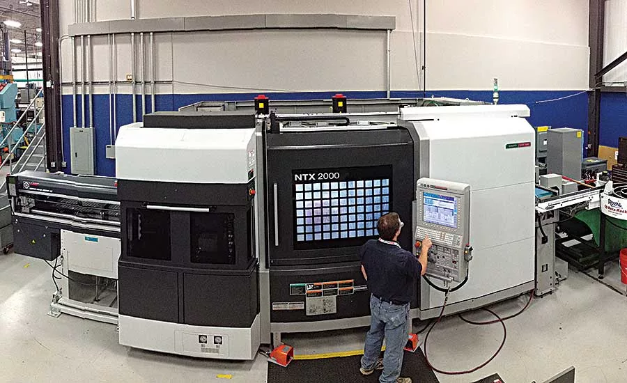

Aero Gear has been investing more in high-tech equipment, such as integrated mill turn centers. Photo courtesy Aero Gear Inc.

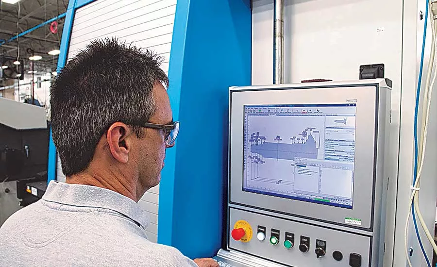

High-tech inspection equipment, like this optical measuring system, help Aero Gear meet the demanding standards of aerospace OEMs. Photo courtesy Aero Gear Inc.

Rose: We make accessory gearboxes for jet engines. These gearboxes tap off of the rotary motion of the engine to drive the aircraft’s fuel pump, oil pump and electrical generator. The gearbox also drives the starter for the engine.
The gearbox housing is typically made of aluminum, but some are made of magnesium. The gears are made from carburized and hardened steel.
Our core competency is producing aerospace gears. The teeth need to have a really hard surface so they last long. And, of course, they must be very precise for high-speed operation. We case-harden the gears and then grind the teeth. The gear teeth are typically hardened to 60 Rockwell C. Underneath that, the parent material typically has a hardness of 38 to 40 Rockwell C. That way, the gears won’t wear out, but they can still bend and flex under load.
We also case-harden the bearing journals and grind them very precisely.

Rose: We have been investing more in high-tech equipment, such as integrated mill turn centers that can turn both sides of a gear, do any milling operation, and create the gear teeth all in one machine.

We’ve added high-tech inspection equipment, too. In the aerospace industry, everything must be carefully inspected and documented. Sometimes, that takes as much time as the machining! We have coordinate measuring machines, like every aerospace manufacturer, but we do a lot of white-light inspection, too. It’s incredibly precise. It can measure to within 0.0001 inch.
