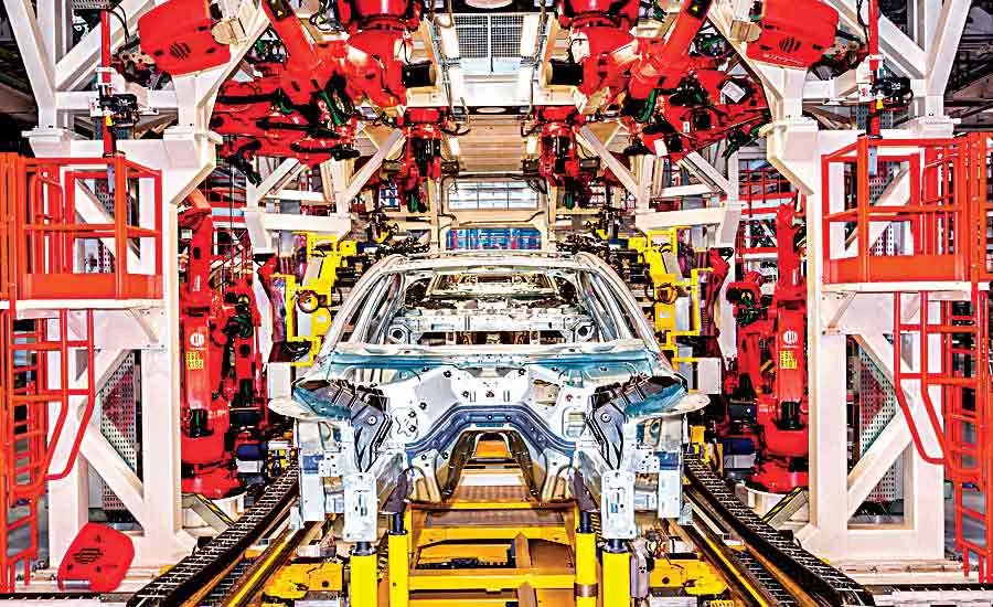

Comau developed the OpenGate framing station in 2011, but customized it for the Alfa Romeo plant in Cassino, Italy, by integrating it with closed-loop assembly, roller hemming and vision inspection systems. Photo courtesy Comau SpA

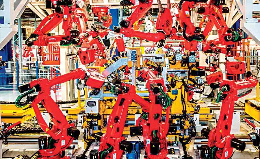

At Alfa Romeo’s Cassino, Italy, plant, the BIW line consists of two Comau OpenGate framing stations with many overhead-mounted robots. Photo courtesy Comau SpA

The BIW line consists of two Comau OpenGate framing stations with many overhead-mounted robots. These robots sequentially weld the structural part of the chassis and its sides first, followed by the outer skin. Because the robots have unobstructed access to the vehicle’s structural skeleton, welding is efficient and precise.
Comau developed the OpenGate station in 2011, but customized it for this application by integrating it with ComauFlex VersaRoll, RHEvo roller hemming and vision inspection systems. VersaRoll is a closed-loop assembly and joining system primarily used for setting the geometry of the body sides and the chassis. It also ensures fast transfer of material through the line to reduce time spent on non-value-added processes.
RHEvo performs real-time data collection and process monitoring during roller hemming to ensure the geometric uniformity of assembled parts. AR uses the system to precisely roller hem the rear wheel arch on each Guilia model.
Before the chassis leaves the BIW line, a vision system calculates the exact position of the wheel arch. This data is sent to the hemming robot, which recalibrates its position, centers itself over the wheel arch and automatically hems it in three passes using two types of rollers. Once hemming is complete, the system automatically reconfigures itself for the next model.
