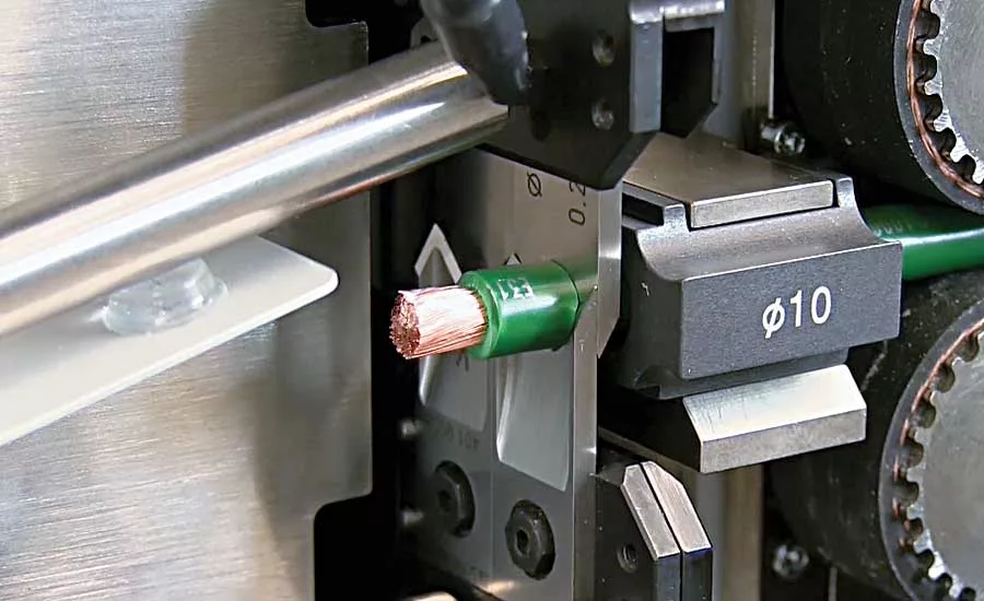

Automatic cutting and stripping machines can quickly process stranded and solid copper wire, and multiconductor cable. Photo courtesy Schleuniger Inc.

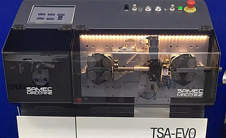

Blades or lasers are used to strip wire in automatic cutting and stripping machines. The TSA 12EVO machine features a single-blade cutter head and has a processing speed of up to 2 meters per second. Photo courtesy Schaefer Megomat USA

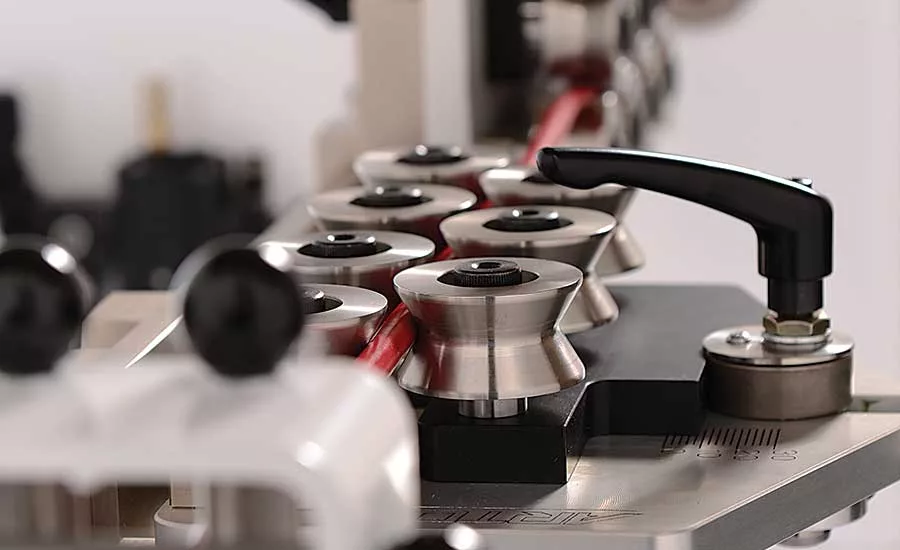

Keeping wire and cable as straight as possible as it moves through the cutting and stripping machine is always important. Photo courtesy Artos Engineering

Schaefer’s TSA 12EVO machine cuts and strips single or multiconductor wire, discrete wire or various cable from AWG 20 to 2 in a single operation. It features a belt-driven feeder and a single-blade cutter head. It has a processing speed of up to 2 meters per second, with programmable acceleration and deceleration ramps. Cut length ranges from 200 to 500 millimeters for single or jacketed wire. Options include a dual-blade cutter head, a dereeler, ink-jet marking, a cup rewinder and a linear or coiling collection system.

Keeping the wire and cable as straight as possible before it enters the CAS machine is equally important. Suppliers often provide material on the smallest spool possible, which, unfortunately, results in bent wire and cable that a wire straightener may not be able to straighten.
“Wire wound on a 2-inch-diameter reel often looks like a slinky when it’s fed into a machine,” explains Doyon. “This memory may result in the wire being cut at an angle. A better approach is to have the wire wound on a 6-inch or larger diameter reel, and then briefly warm the wire with a heat lamp before it goes through a wire straightener. The heat softens the wire insulation a bit and helps to erase the memory of the reel.”
To avoid this extra processing step altogether, thin wire should be wrapped around spools at least 10 inches in diameter. Thicker wire and cable should be delivered on much wider barrels, so that it unwinds in a large loop that is easy to straighten.
