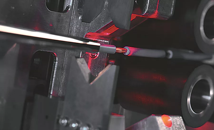

The Kappa 331 machine features the Kappa Sensorik laser sensor, which automatically detects the wire conductor and then uses inductive measuring to determine its diameter. Photo courtesy Komax Wire

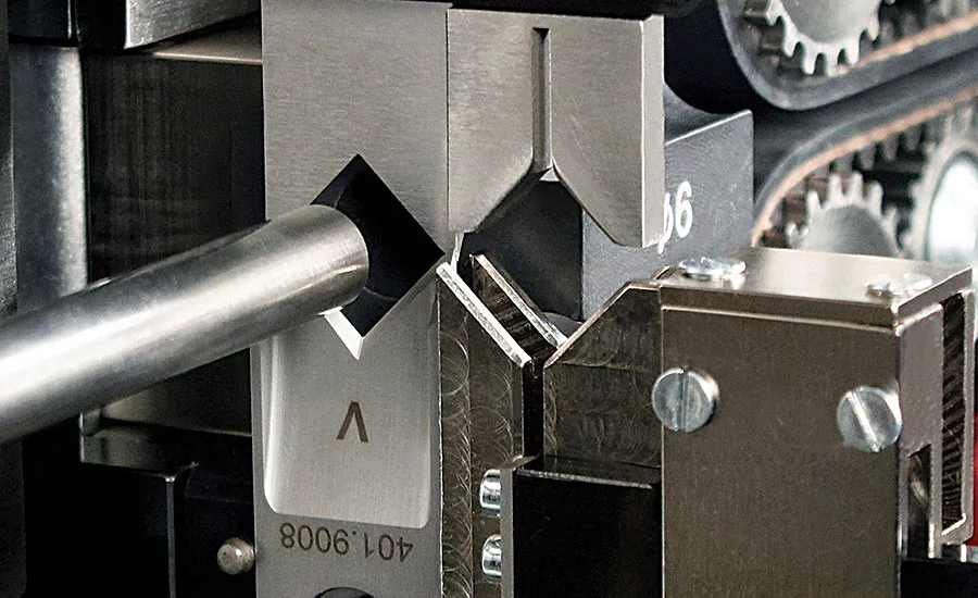

Five versions of the MultiStrip 9480 machine feature a multiposition indexing cutter head. Photo courtesy Schleuniger Inc.

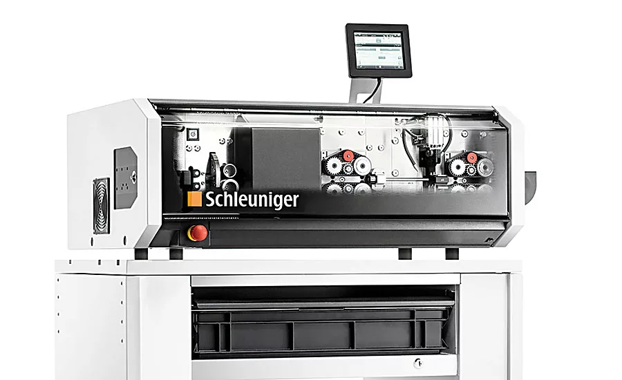

Manufacturers can use the standalone MultiStrip 9480 machine to cut and strip 32 to 8 AWG wire as short as 2.3 inches, and as long as 3,281 feet. Photo courtesy Schleuniger Inc.

Schleuniger offers six versions of its MultiStrip 9480 machine to cover a wide range of applications (32 to 8 AWG wire) and budgets. Four models (MR, RS, RSX and RX) feature a fully programmable rotary incision unit capable of processing coaxial and multilayer cables. A multiposition indexing cutter head, standard on all models except the S, accepts blade cassettes that change out quickly and easily. The machine cuts and strips wire as short as 2.3 inches and as long as 3,281 feet. In short mode, wires as short as 0.375 inch, with a 0.125-inch strip length on each end, can be processed.

Komax’s Kappa 331 machine addresses these and many other challenging applications. It processes wire from 24 to 2 AWG and cable up to 0.63 inch OD in large and small batches. The unit also performs full and partial pull-off operations on single conductors and individual coax layers, and strips the outer jackets from cables with or without shielding.
A key feature is the Kappa Sensorik laser sensor, which automatically detects the wire conductor and uses inductive measuring to determine its diameter. The sensor and a chargecoupled device (CCD) line optically measure the outside cable diameter and then check that the cable is present during processing. This feature greatly shortens setup time and changeover, and reduces operating errors.
