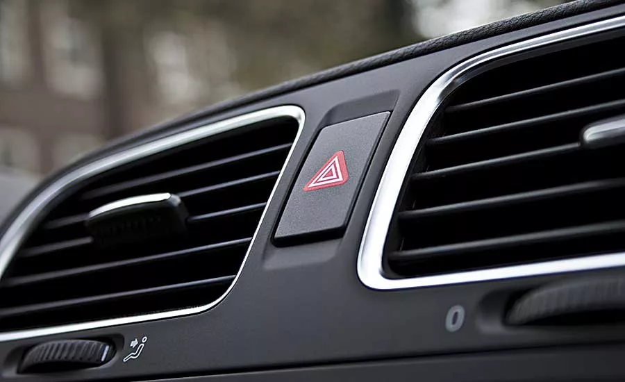

When buying a car, consumers place great importance on the aesthetics and quality of its interior. The dashboard, in particular, must have an attractive look and feel. But it’s not just the beauty that matters; it’s the quality as well. That is why decorative elements, such as chrome rings around ventilation slots, wooden moldings on doors and steering wheels, and cladding for radios, are bonded with adhesives.
Adhesive bonding is simple. Adhesives are invisible and are more reliable than snap hooks. They easily withstand temperature fluctuations and the associated expansion of the materials.
Adhesives are also safer. Crash tests have shown that adhesives provide additional safety in head-on collisions. These tests have revealed that clipped decorative elements may break or splinter during an accident. The protruding plastic material presents a potential risk of injury to the vehicle’s occupants. However, if these elements are attached by bonding, this risk is eliminated. Broken chrome rings and other trim pieces stay in place during impact.

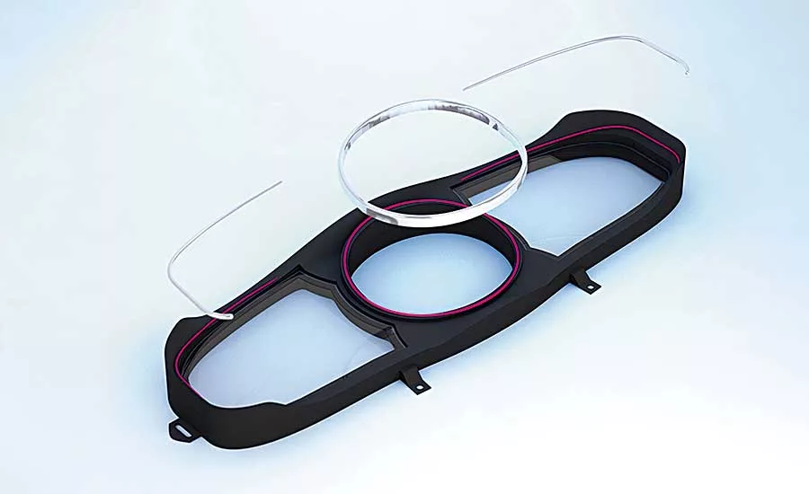

However, more complex shapes, like those needed for bonding frames around displays, make the use of tapes expensive. Die-cut tapes of such dimensions are much too delicate to be handled by machines and would have to be adjusted and applied manually, which would significantly increase production costs.

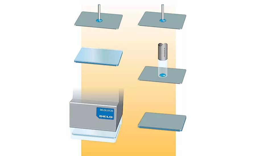

Fortunately, there is an adhesive that solves both problems: one-component, UV-activated epoxy resins. With these materials, UV light is used to “pre-activate” the adhesive, rather than cure it instantly. After a short irradiation time, the adhesive remains liquid for 1 to 30 seconds. The adhesive then reaches initial strength within a few minutes without additional light exposure. This longer open time gives assemblers a little extra time to adjust the position of components. And, it means that opaque components can be joined with a UV-curing adhesive.
The bonding process for one-component, UV-activated epoxies is slightly different from that for standard UV-curing adhesives. With the latter, the process consists of dispensing the adhesive, assembling the components, and irradiating the bond line. With the former, the process consists of dispensing, irradiation and then assembly. If necessary, final curing can be accelerated with heat.
Compared with standard two-component epoxies, one-component, UV-activated epoxy resins are much easier to dispense. Assemblers don’t need to worry about mixing or staying “on ratio.”
