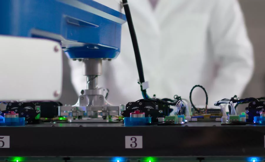

By using the Stackit auto-layering robot system, Nike can manufacture up to 600 pairs of gym shoes in an eight-hour shift. Photo courtesy TM Robotics Inc.
