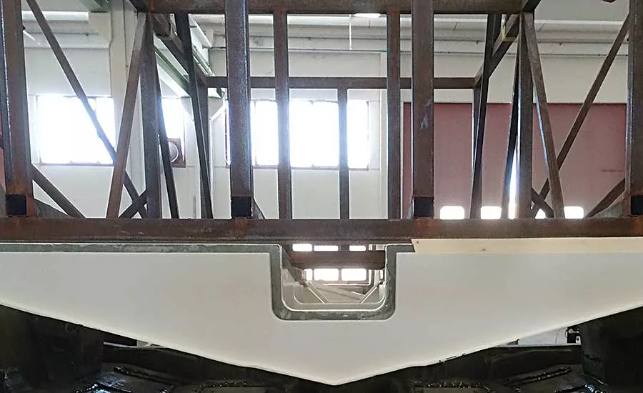

At its Ancona, Italy, shipyard, Ferretti S.p.A. workers bond composite parts with a high-viscosity methacrylate adhesive. Photo courtesy Scigrip Europe

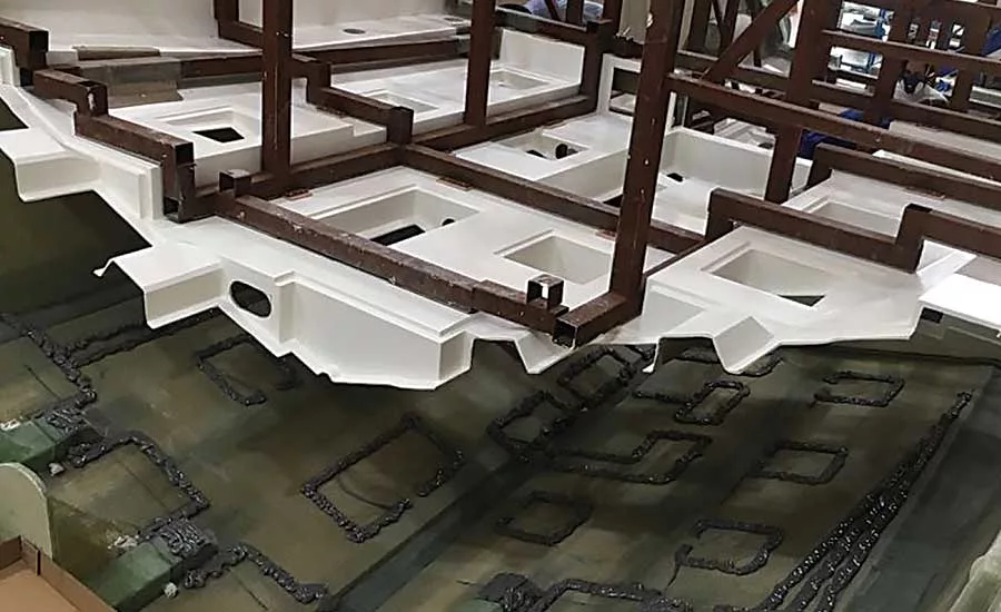

Large and mega yachts from Ferretti feature structural and nonstructural elements made of composite materials. Photo courtesy Scigrip Europe

Workers at Ferretti S.p.A.’s Ancona, Italy, shipyard regularly deal with the challenge of bonding composite parts while assembling large and mega luxury motor yachts. These parts are fabricated offsite and include fiberglass hull shells and load-bearing components in the engine room.
For many years, Ferretti assemblers used polymer-based adhesives to bond the parts. The company switched to SG230 HV, a two-part methacrylate adhesive, in 2017 after extensive testing and because it is certified for marine use by Lloyd’s Register Group Ltd., a London-based classification society.
SG230 is a thixotropic material that provides both high mechanical bond strength and fatigue resistance. The adhesive can be applied in void-free beads up to 80 millimeters thick without sagging, but is only recommended for use where the ambient temperature is above 85 F. It mixes with an activator that provides a working time of 30 to 130 minutes.
Most parts have a large bonding surface, making it necessary to use an automated meter-mix system that dispenses a large quantity of adhesive at a 10-to-1 ratio. A special drum extruder, specified by Scigrip and its Italian distributor Mastikol, eliminates the need to stop dispensing when changing out a 189-liter drum.
